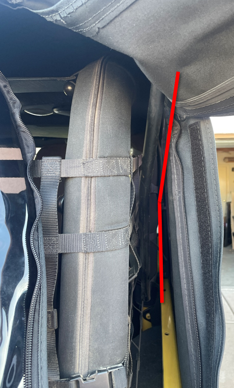

The nylon straps aren't critical just handy to keep everything together. When installed there is no real tension on them
Reactions: AndyA and SSTJ

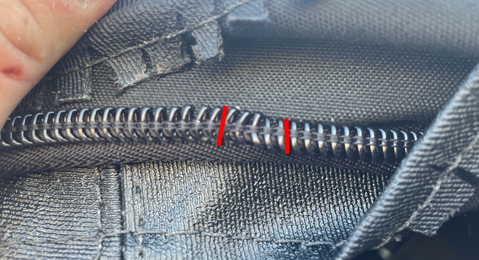

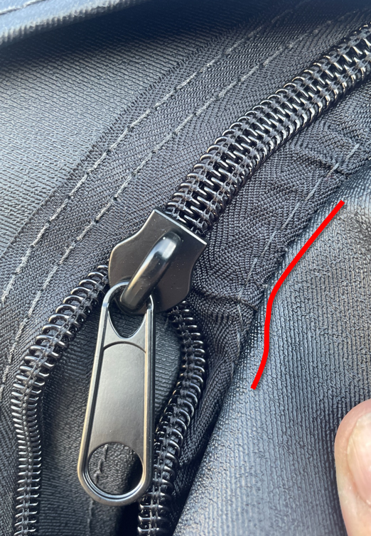

I got the zipper fixed under warranty. The top stretches fine - I have zero issues with latching it at the front and hooking it at the back. Passenger side window went in nicely, no issues with that. I am stuck on the driver side window and the rear window.
Here is a picture of the rear window. At this point the top is unlatched from the front but still hooked at the back. The top is snapped into the rear bow, which is free to move. The window is unhooked from the bottom. There is no tension on it at all. I cannot get the zipper around the corner and I cannot figure out why! It jams. No obvious visual issue with the zipper teeth. I can't figure it out. :cry:

Have you tried pulling both the inside and outside zipper pulls at the same time? When putting in/taking out my rear window, the corners are always a little challenging - not bad, just not as smooth and easy as the verticle side portions. I've found that sitting on the rear deck and pulling both outter and inner pulls together makes a big difference on mine. I'll usuall start at the bottom and use the outter pull to bring the zipper up to about 2-3" before the turn, then use both inner and outter for the last 2-3 inches before the turn, across the top and around the rest of the way; usually goes nice and smooth when I do that.

Yes, I've been trying that. It won't budge. I could really crank on it but then I am worried I will break a zipper.
