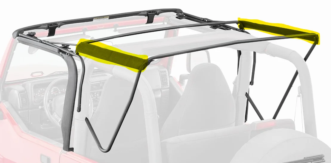

I don't have these straps - one is missing and the other is only attached at one end. That means the rear bow is held in place by the snaps on the soft top. It does line up about with the seam across the top. Are the missing straps critical?
Thanks, Andy
I have to unhook the rear bow from the rollbar to get my windows in on my crappy bestop supertop. Then i struggle to bow back into its mounts
Reactions: AndyA
I do not have those straps on my TJ. When I installed my top I would work an area and then move somewhere else. I know I had to unlatch the front end many time, but I would gain an inch in one area, then move somewhere else. It was an all day effort. Now after driving the Jeep for 5000 miles it looks like everything has sort of form fitted itself in the sun. one of the last things I did was the velcro on the center support,

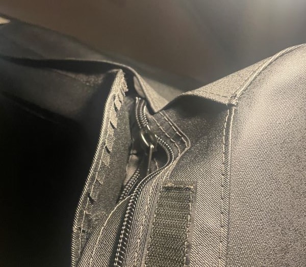

Here is an experiment I just tried.
I removed the driver's side window from the bottom and front so it was only attached by the zipper across the top.
I unhooked the driver's side back corner of the top so it was loose.
I pushed up on the rear (3rd?) bow so the top was loose.
I still couldn't zip up the window around the corner even though there was no tension on either side of the zipper.
Is this normal or not normal for a new top?
Thanks, Andy
Sounds to me like you've tried everything. Especially if this pic was taken when the rear was loose and the front was un-latched? If so, I'd send this pic and description to the manufacturer. The way it's buckling the top makes me think that perhaps the window is a bit too short (left-to-right), and bends downward a bit too early.
Reactions: AndyA
