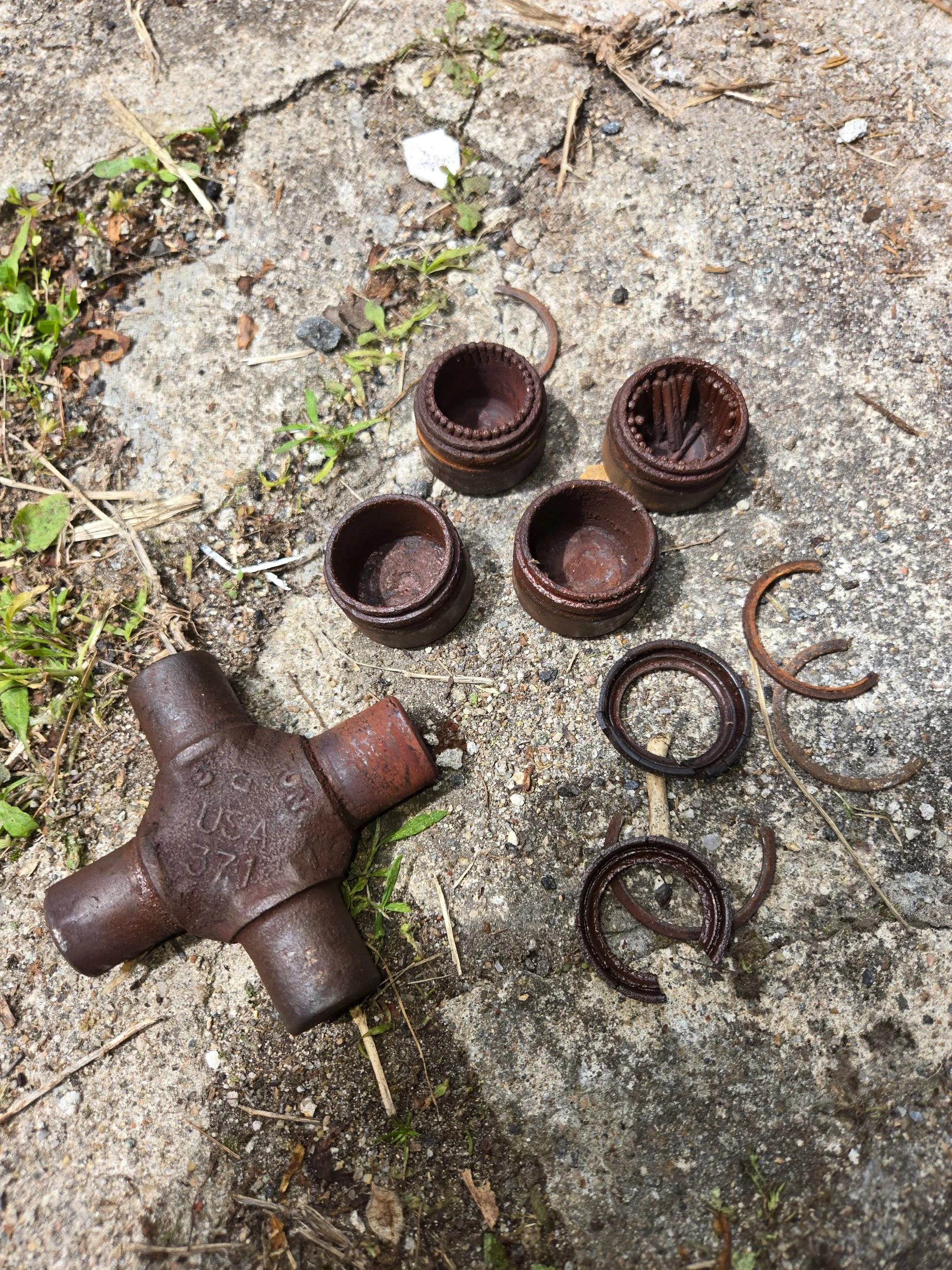

Dog it… last fool to change them put knurled lower ones in. Guess I going dimples and loctite.
