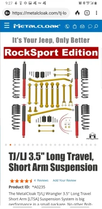

Time to get the build going and pick up a new lift.
Budget is $2k for the lift - (lift only, no labor).
Currently set on the JKS JSPEC 3" kit (here), would add rear trackbar and steering stabilizer to the package.
Vehicle is stock 04 LJ I picked up a couple of weeks ago, goal is to run 33x10.5's and avoid a body lift. I'd rather do fenders than a body lift.
School me on whats out there, want to be in the 3-3.5" range.

Update: Savvy 4" and SYE/DS ordered!
Your LJ looks like mine did the day I bought it. Same color and wheels. There is a ton of good info on this site for the exact combo you want. And well within your price range.
You can do a build it yourself kit with rancho parts. Currie and OME make good products also.
No issue increasing budget $500 as this is a one and done selection.
With the 4” options would that infer a SYE and driveshaft would be needed? Was part of the appeal of 3” since I’ve no intention of going 35”+ on this.
I’ll contact savvy about their package but with 3” coils.

Definitely see about the 3" coils with your 33's. My LJ needed an SYE with the 4" coils and not running a t-case drop.
You will be glad that you went that high end from the start if this is a rig your gonna keep.

4 inch procomp coils $260
Control Arms $1200 Savvy/ Metalcloak/Core4x4
Rough Country front/teartrackbars $300(dont laugh😂)
Break lines, bump stops, sway bar disconnects $300
SYE and driveshaft $500
$2500 ish

User configurable lift from savvy.
https://savvyoffroad.com/product/ce-9801sc1/

Don’t forget shocks and tax.
I only keep posting this because no matter how you cut it, it costs around $3k to do the Johnny Joints.
The Savy was what I've been saving up for, but in the meantime, I decided to just go OME Springs/Rancho Shocks. Really all I'm missing are the double adjustable control arms at this point and that half an inch. Might I suggest getting MCE Fenders and making some room in the fenders.
