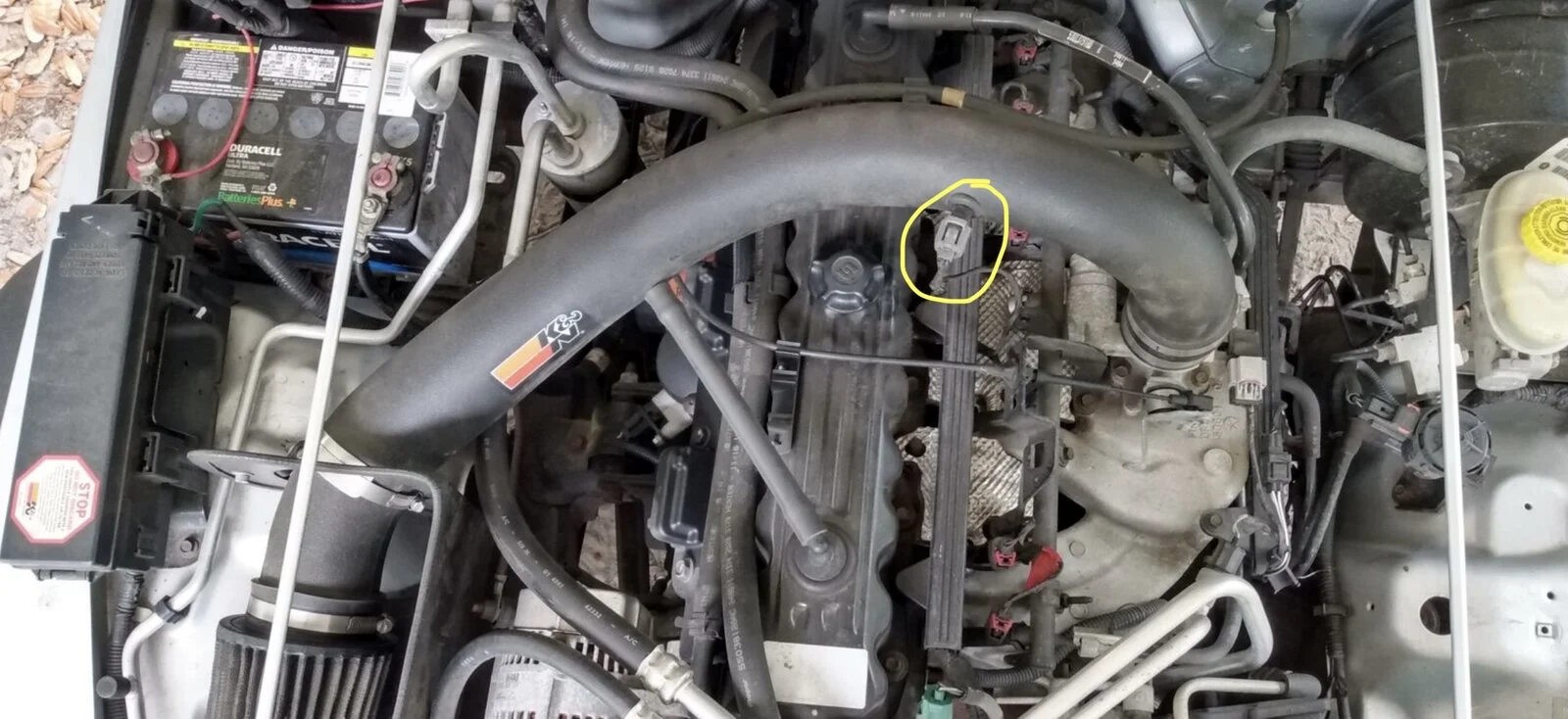

That wire, to the right of your circle, that is going into the large k&n hose, it has one of those plastic snap connectors...will this go into the factory set up ok, doesn't need to be longer or get a new one?
That wire is actually the throttle body accelerator pedal cable. It passes underneath the large plastic air intake tube.

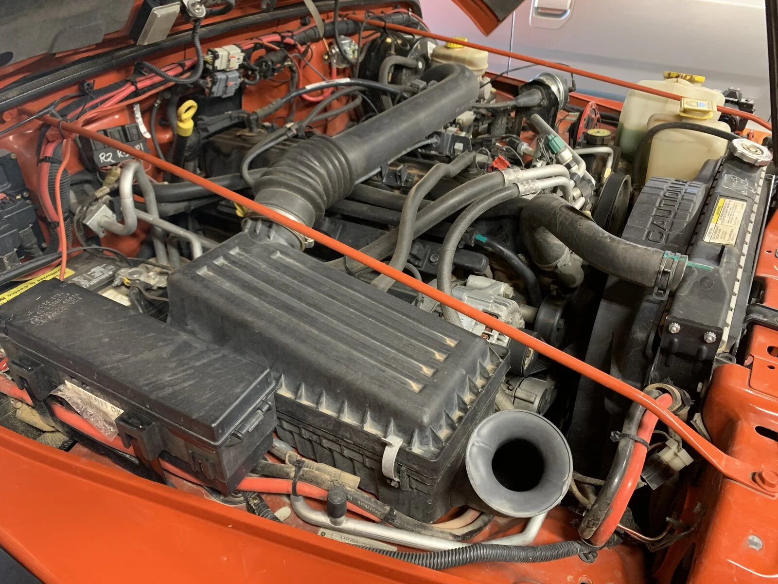

Whenever you get time would someone please post a photo of their 2005 whole air filter assembly, with hose to box. I think it will help give me a great guide on what goes where when I find the factory parts.
Thank you!
Thank you!

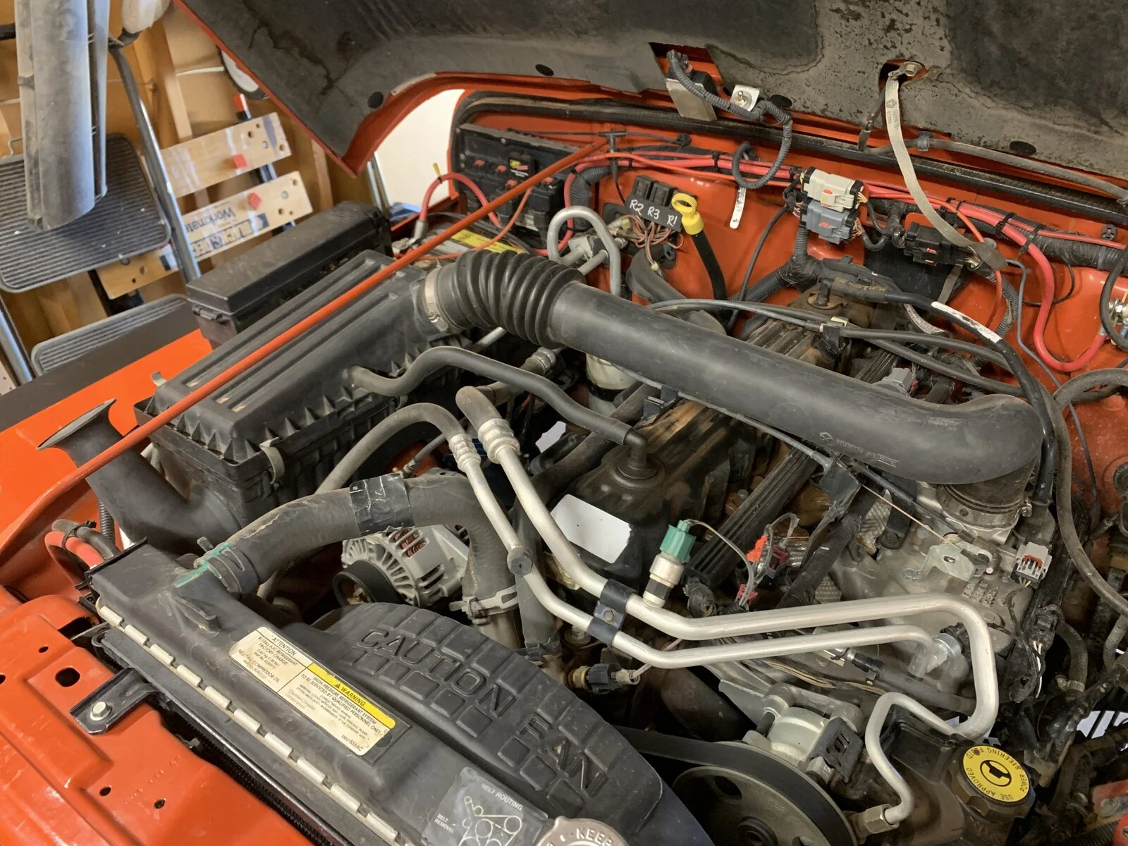

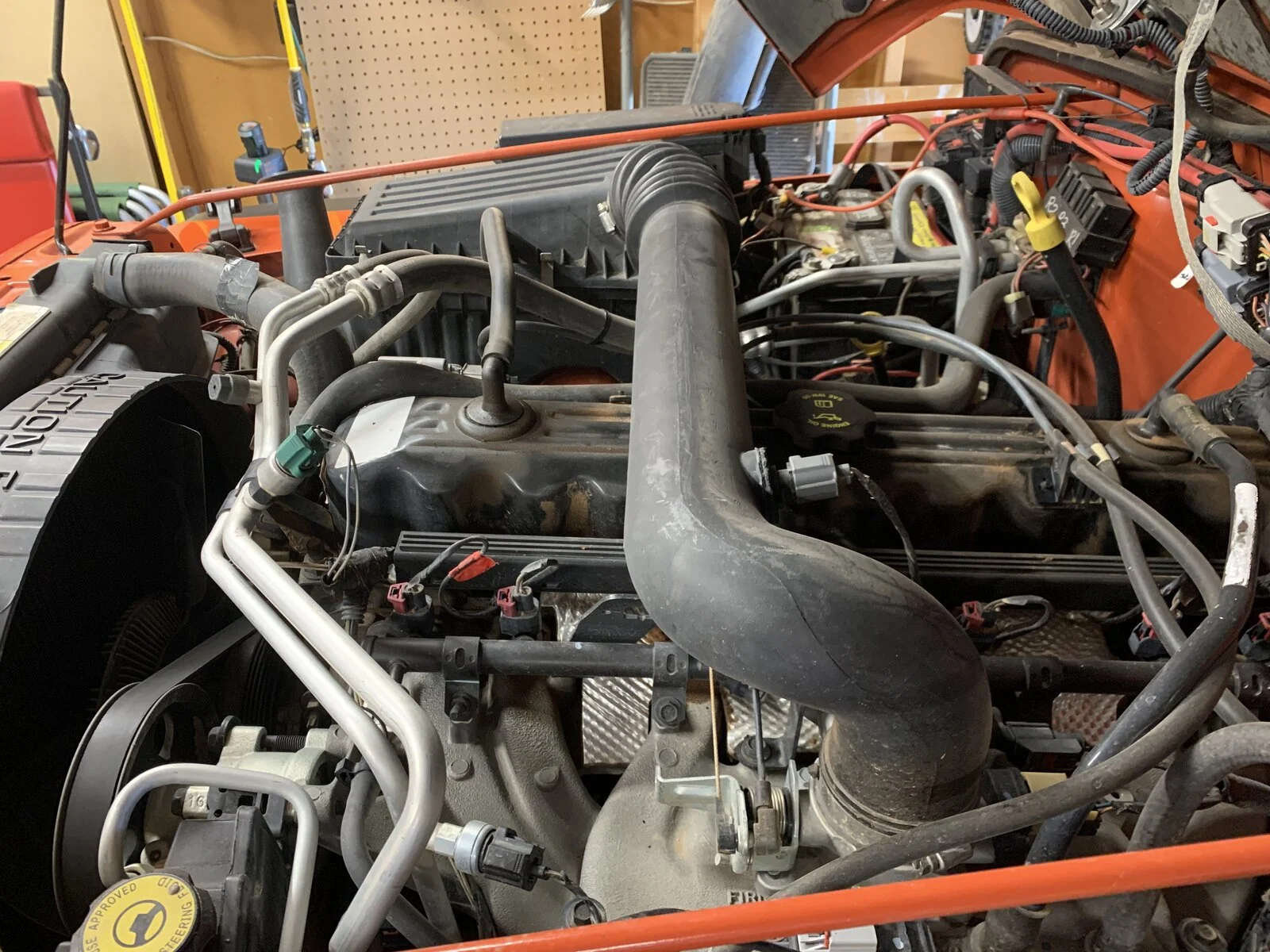

Photos from my 2005.
The circled wire and connector appears to be factory still. It will plug into the back side of the factory tube. See my photo above.

Ah, thanks for pointing out the hose!
What is that little elbow, #12?
I was looking and I think I only found these for 2004 years as well
You won’t need #12 for your model. The hose I linked is basically the same thing for your model. In the earlier models, the PCV elbow connects to the tube rather than to the box.

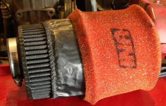

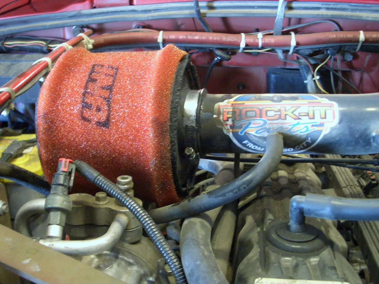

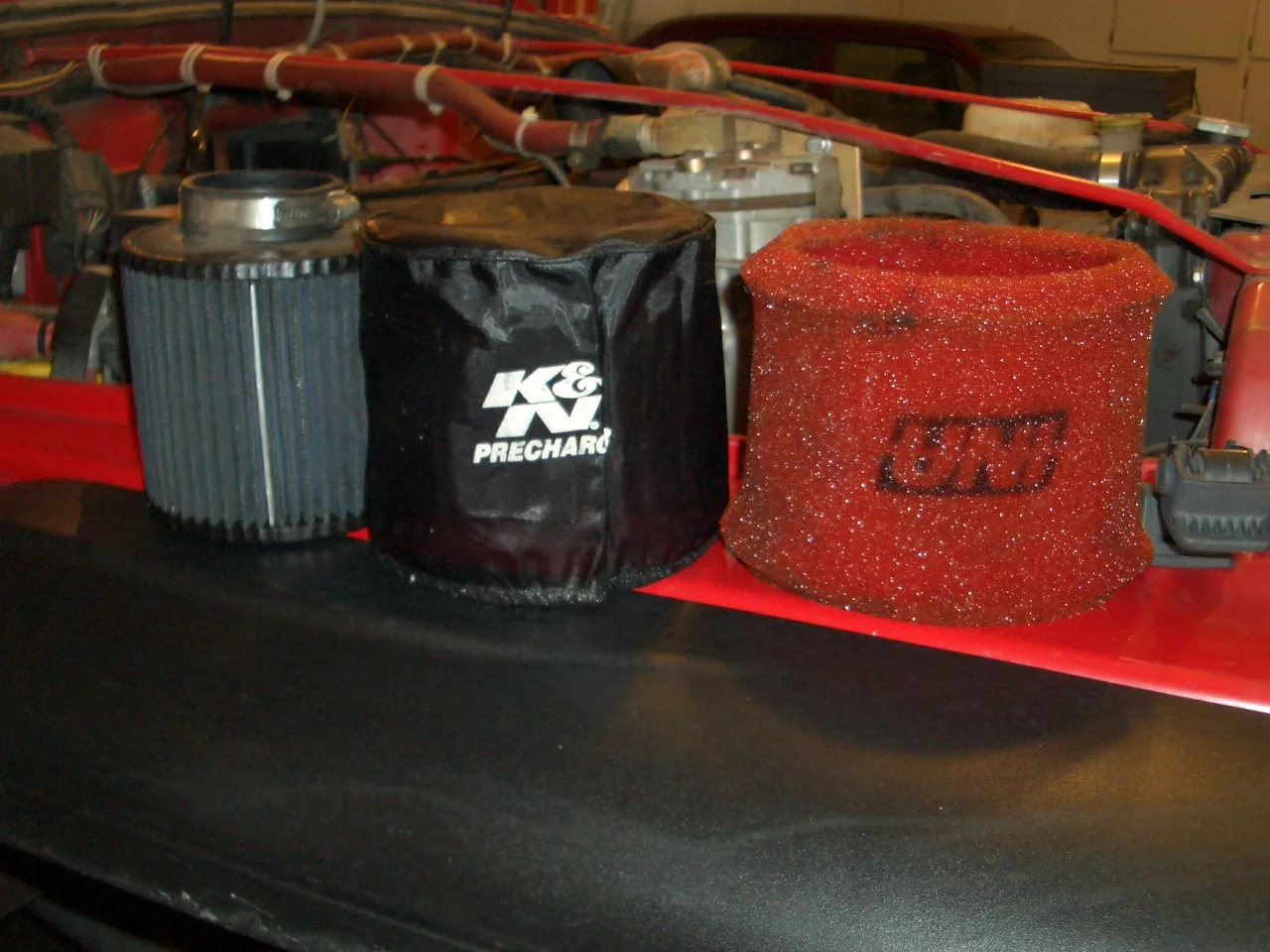

It took two prefilters. The first layer was K&N's Precharger which fit so loosely it allowed dust to flow in around it. That's K&N for ya! I was forced to add a foam Unifilter to hold the Outerwears closer to the base K&N so it wouldn't leak in dust.

You would be wise to go back to the stock air cleaner box. It won't take much time or effort once you obtain a stock box. Just make sure you get the correct box and tube for your model year. Looks like you have a 2005, so you will need to get the 05-06 box with the sensor on the back of the tube. You'll also need to get one of these if the K&N setup doesn't fit: https://www.ebay.com/itm/3019953936...d=link&campid=5337789113&toolid=20001&mkevt=1
You'll probably need to remove a few clamps on the K&N setup, plus a couple bolts that hold it to the right side fender. Stock box will be replaced in a similar manner, with a few bolts on the fender and a clamp on either side of the tube.
