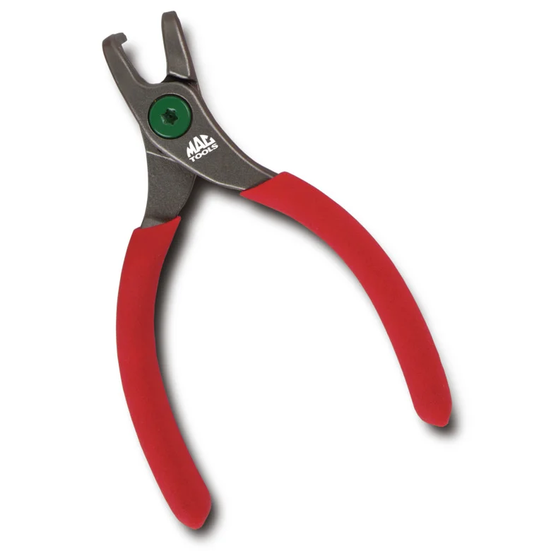

Also, lock ring pliers were the biggest "right tool for the right job" issue I had during the whole SYE install. Be sure you get the right kind. The ones with the protruding pins are for circlips that have holes in the ends, and those simply won't do for the shaft rings. You need the pliers that have the small flat paddles on the end. I was able to eventually get mine off with needle nose that had been ground down on the tip, but it was way more work than it needed to be, and ended beating up the old rings (and costing me an old set of needle nose). Fortunately, they got replaced with new ones.
Obviously, after that last little narrative, take any of my amateur advice with a grain of salt. I'm no Mr Blaine or Jerry.
I hate to really speak to a specific brand, since I've not evaluated them, but an example would be pliers like these from Mac Tools. Note the flat facing on the ends of the jaws.
