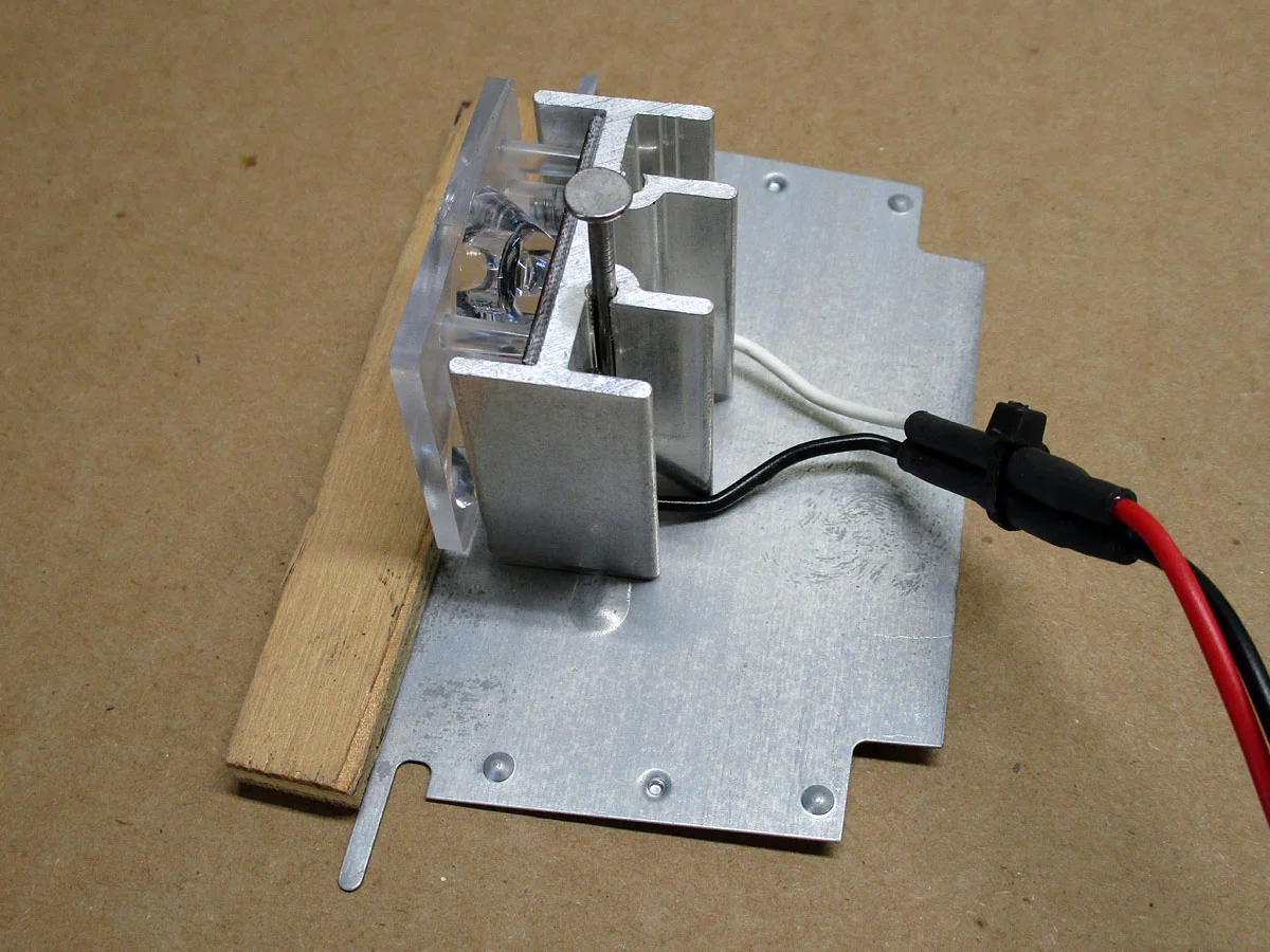

Installing the LED reverse lights available elsewhere on this forum. Any advice on drilling the mounting holes for the light??

Read Claytone wright up in the LED reverse light thread , it's easy peazy. With photos !

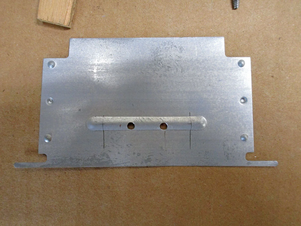

I pushed the metal shelf up against a board, and then touched the LED assembly to the board to get them even, and marked the shelf with the nail.
The holes came out here on the shelf:
