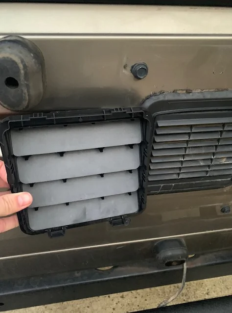

I recently added a new rear bumper with swing out tire carrier and noticed the rubber on my tailgate vent was deteriorating and wanted to replace it. I ordered one online and they sent the one pictured in my hand. It has no cover, no outer rubber seal and just flimsy paper to keep dirt etc from getting inside and its completely exposed to the elements. Is this the correct part? is there another part the goes over this part? I went by my local dealer and they said this was the OEM replace part number. The picture of the part I ordered (Quirkparts on eBay) was near identical to the one currently on the tailgate. Any help would be greatly appreciated.

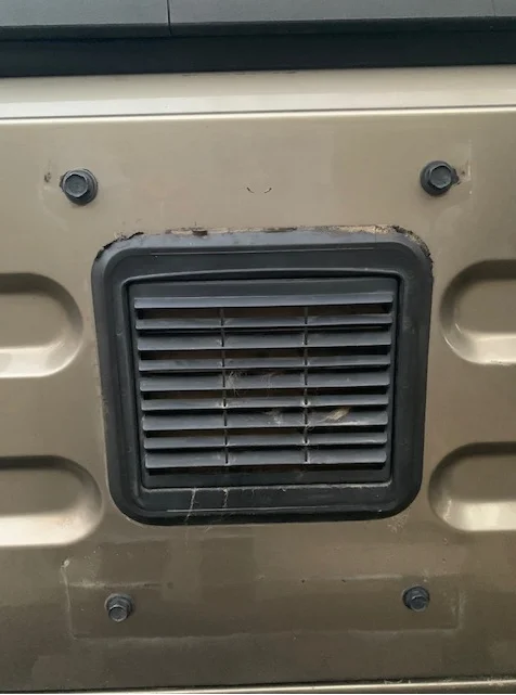

I haven't replaced mine, but I did remove it the other day. Here's a pic of both sides so you can compare.
Do they just pop out?
They have four plastic clips, 2 on top and two on bottom. I would suggest pulling from one of the two sides rather than the top or bottom and going slow if you don’t want to break one. I looked at the pic above and they are hard to see. If you don’t care about breaking them, just pull it off.

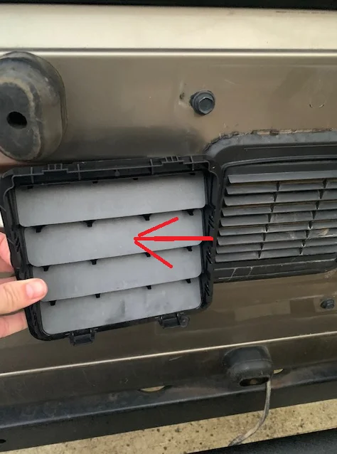

To expand on this picture. This is the side that would be exposed. It would insert into the tailgate just as I'm holding it, with out any additional piece. The red arrow is pointing to what is essentially paper flappers, when they open its directly into the inside of the tailgate. It kind of looks like there is another piece that would go over those flappers kind of like the vent to the right in the picture but the "Parts" guy at the dealership said there isn't anything in their system that says there is.

Well, that certainly doesn’t look right.

Im replacing mine now. There is a seperate plastic cover plate that can be ordered....that replaces the one you can see on the vehicle picture you provided. That flapper part goes underneath that.

I had a hell of a time getting it....after describing what I wanted to multiple dealers...several sent me the wrong part...so it cost me over $100 to get this $25 part. I got mine off ebay from daveysjeeps. My ebay purchase won't allow me to open the link anymore to see the part#. I would call them on the phone. I've bought several things from them on both ebay and by phone and they were helpful.
