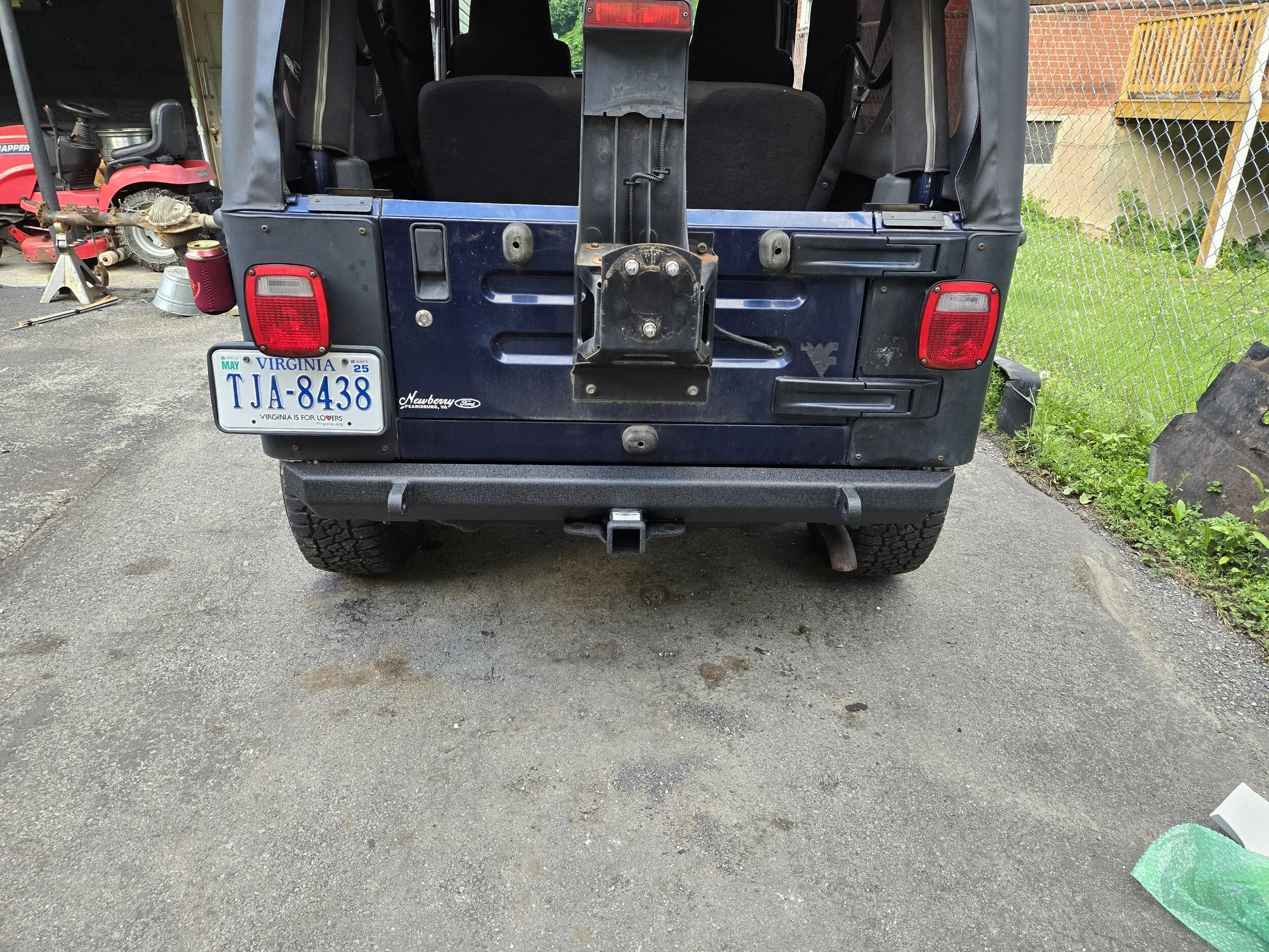

Just ordered a Smitybilt rear bumper. I know they're not the best stuff but the price for a Class 3 rated bumper with some style and no tire carrier was unbeatable.
Installed the Smitybilt bumper and Fishbone support brackets.
Now the spare tire doesn't fit...

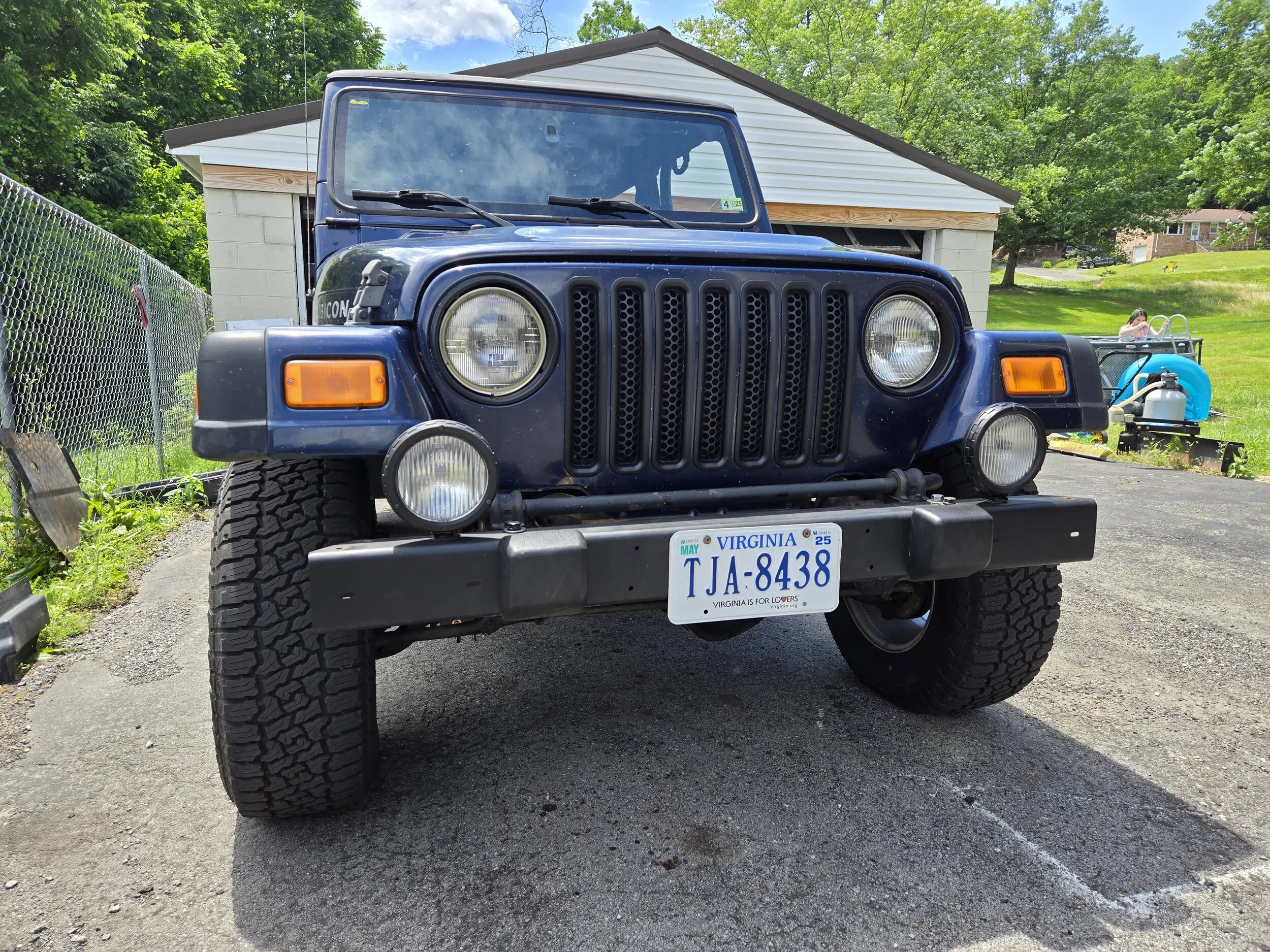

I picked up a set of OE bumpers to run till I can get something else. I'm not happy that the SB bumper interferes with my spare so I'm gonna sell it and go another route.
The OEs came with fogs. I've got a set of pigtails inbound to fix their wiring.

Checked the blower motor resistor and replaced it. I now have all the blower speeds!
Then I replaced the fog light pig tails and they finally work.

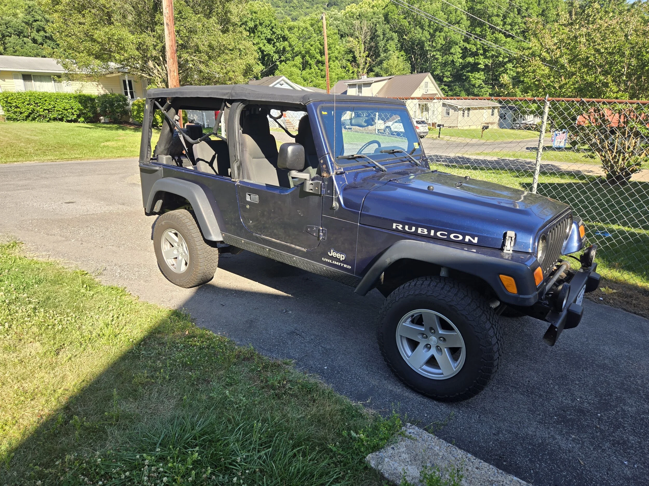

295 miles round trip in a relatively unproven vehicle today.
Picked up my doors and a transmission skid plate...
Drivers door needed adjusted but fits good now. Uppers are brown (spice?) and usable but I'll be on the lookout for ones to match my top.

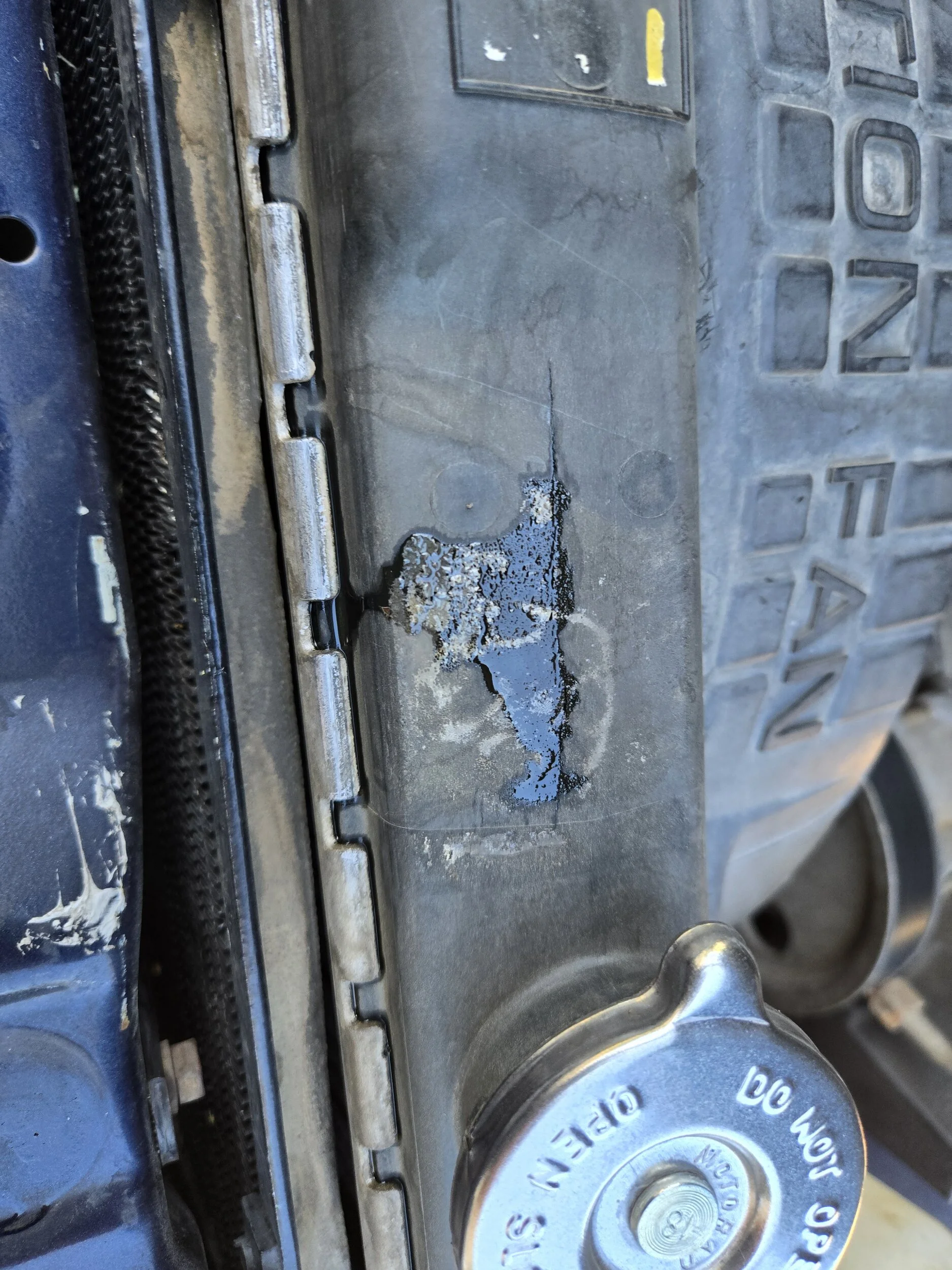

Ordered the RockJock control arms for the front and then on the way home the top tank on the radiator blew.
It's the factory radiator so I guess that's OK. I had planned on replacing it eventually anyways but I guess sooner is better.
