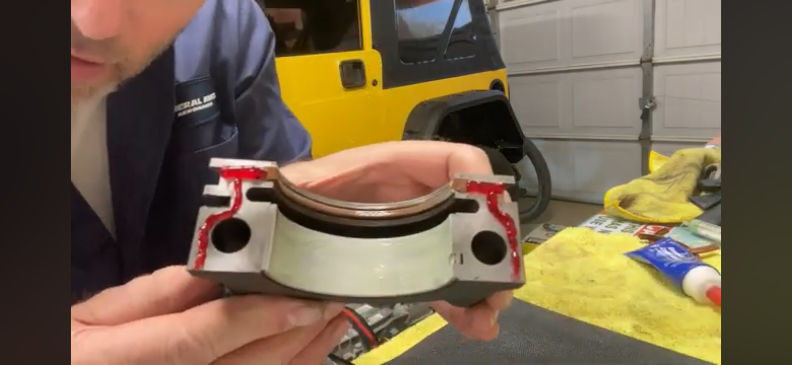

I have 2-mopar RMS and fel pro pan gasket, anaerobic sealer in the pile of parts for my transmission swap. I plan to do the RMS at the same time.
I would love to see what pattern you use on the bearing cap with the sealer.
I hate doing rear main seals almost as much as I hate the smell of burning oil under the Jeep.
A few things:
1) I don’t like this job. There’s no way to confirm it’s right till it’s too late and it’s easy to mess up
2) The Fel-Pro instructions say to add a thin layer of grease to the lips if you won’t be starting the engine soon. I’m doing a swap, so it will be awhile.
3) Then I dipped the seal in gear oil to give some lubrication as I pushed it in. I used the little tool Fel-Pro sends. It worked.
4) I cocked the two gaskets so the upper went in about 70% of the way and I met it with the lower going on the other way. I put a dot of anaerobic gasket maker on each side where the two seals met.
5) I used this pattern, and after I torqued down the bearing caps to 80ft/lb it oozed out a bit around the edges both fore and aft.
I don’t have any confirmation it has sealed yet. Doing the oil pan later.

A few things:
Good luck. Like overhauling an engine you don't know how replacing the RMS turned out until you start the engine.

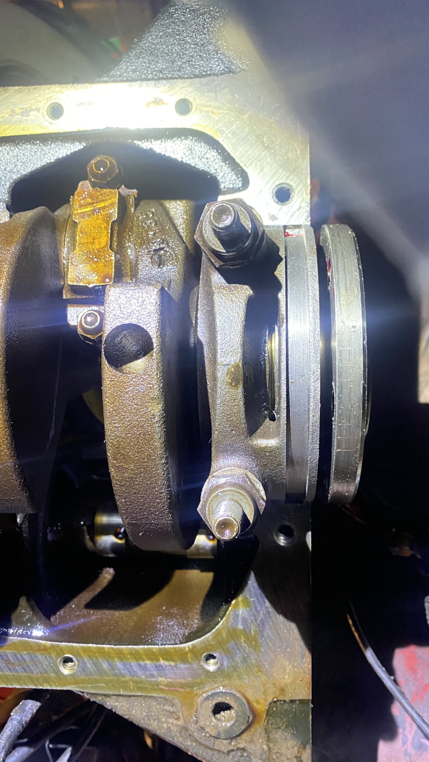

I know. It’s annoying. I read and read. It’s nerve-racking. Just finished yesterday. I lubricated them with gear oil to slide in better. I offset them with a dab of anaerobic gasket maker where they meet. We’ll see. I really hope it’s sealed

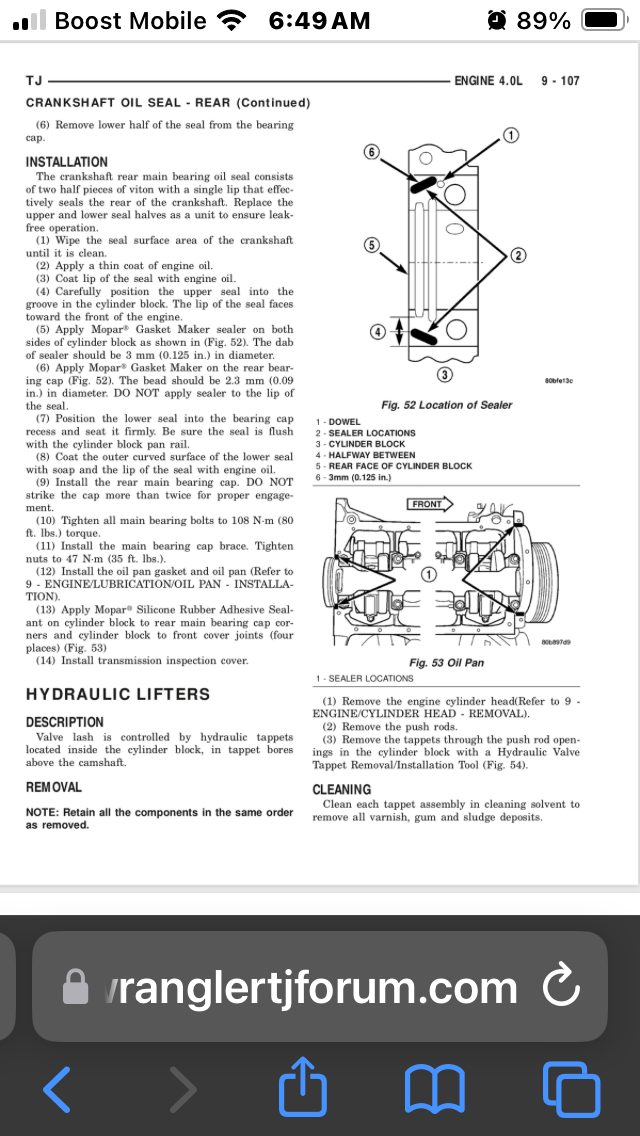

I’ll be going by FSM. Hasn’t failed me yet. Well once I thought it did but after I pulled the pan back off and found out the pan gasket rolled right under the bearing cap/rms.
I hope this works out man. Good luck. It is nerve racking. Pain in the butt and the cost of oil now geez.
