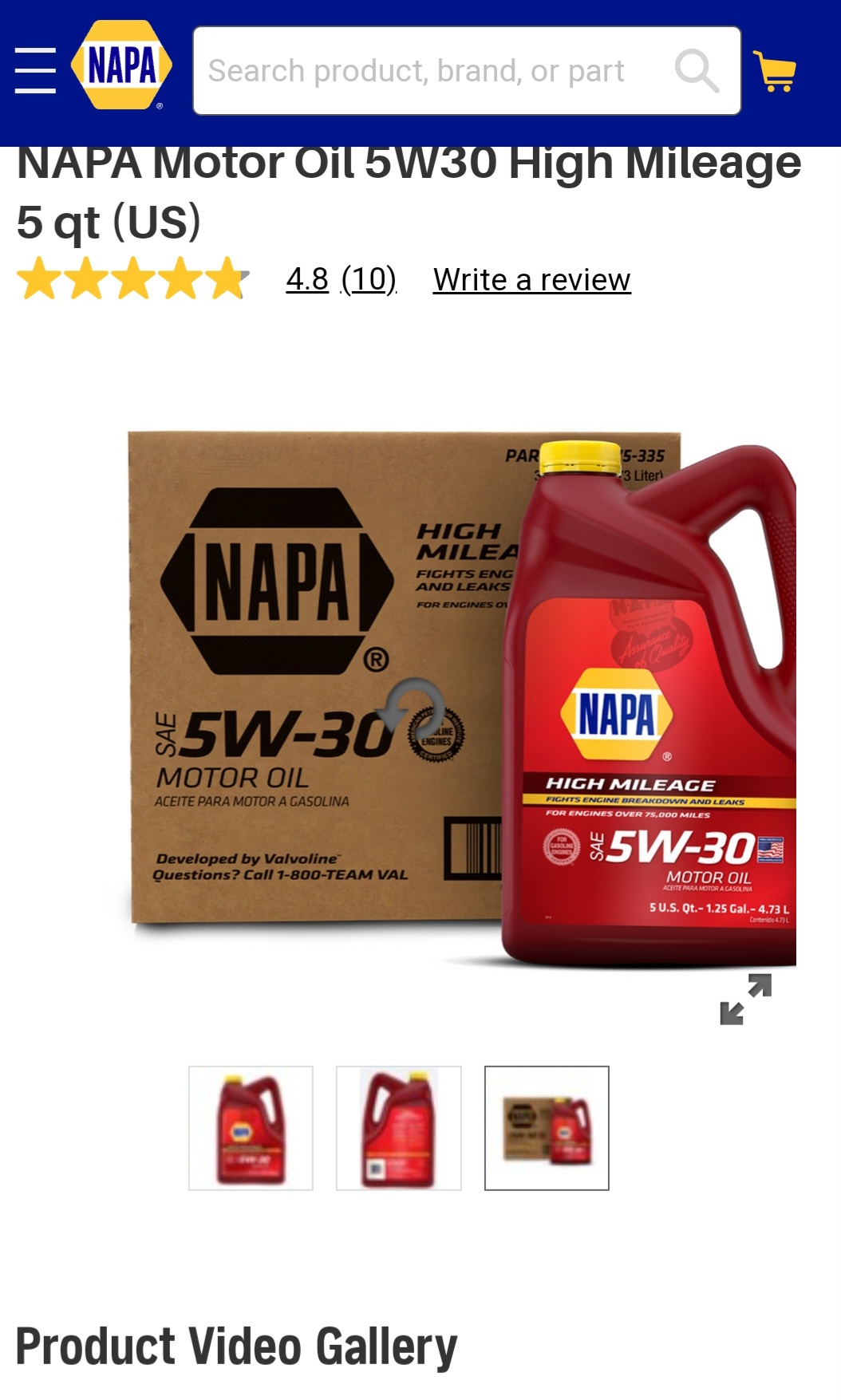

Napa is Valvoline and I use it quite a bit. They typically have decent sales on the napa brand oil. It looks like they have a conventional High Mileage too. Box even says developed by Valvoline.
Unfortunately that 5qt of 10w-30 high mileage conventional costs as much as their Valvoline full synthetic or I would absolutely hop on that. But I think $31 for 5qt of dino oil is pretty steep. I had to do a double take on Napas website lol I first thought they were offering 10qt for $30
