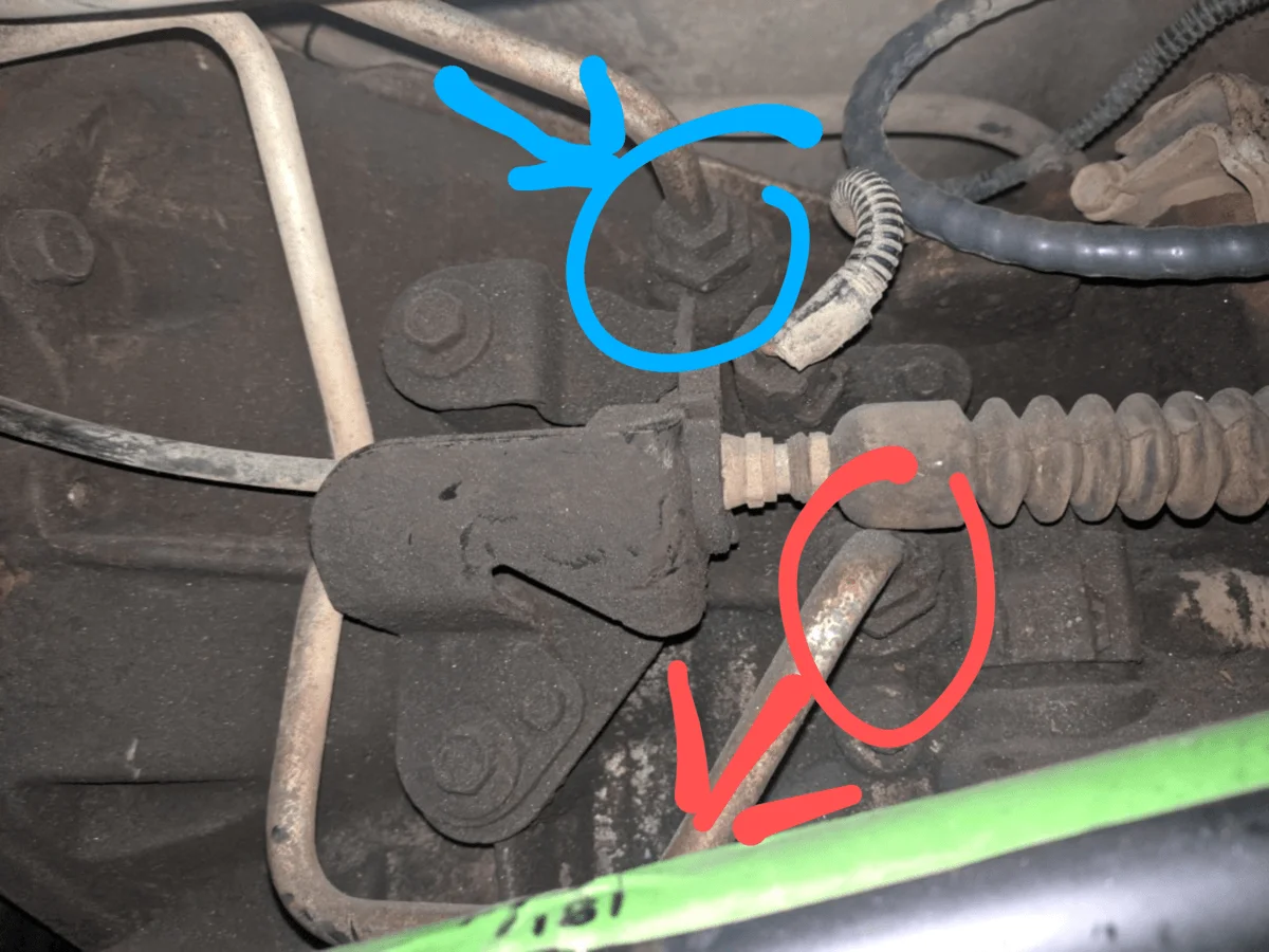

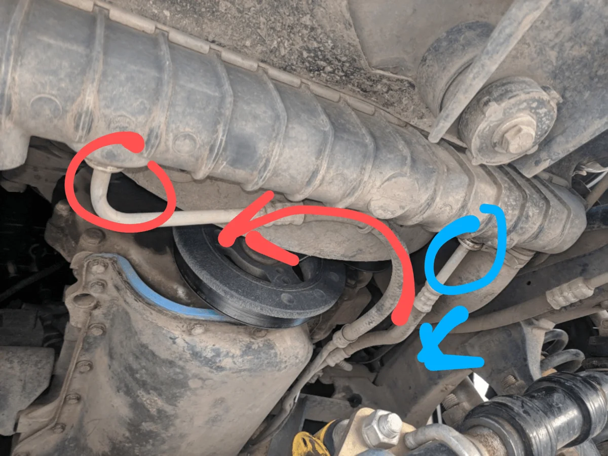

This is the radiator on my 2005, but don't rely on this picture or driver/passenger side to know which is which.
This picture is all you need to know. As long as your Jeep is on its wheels on relatively flat pavement, the return (cold) port is on top of the 42RLE and the output (hot) port is on the bottom.
Any questions class?
