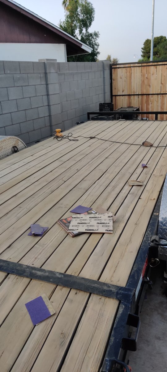

I am sanding down my decking on my flat bed trailer. I am planning on sealing it this weekend hopefully although it is supposed to be 105 degrees so I may be floating in the pool instead, but I was curious if anybody else has done this and what kind of sealer they used.
Right off the bad, I have decided not to use oil or diesel, mostly because it is not clean, When we go camping I unload my Jeep or whatever I am hauling and we use it as an actual deck, so I don't want it to be wet or oily. So I am decided to use some sort of sealer. What do you suggest?

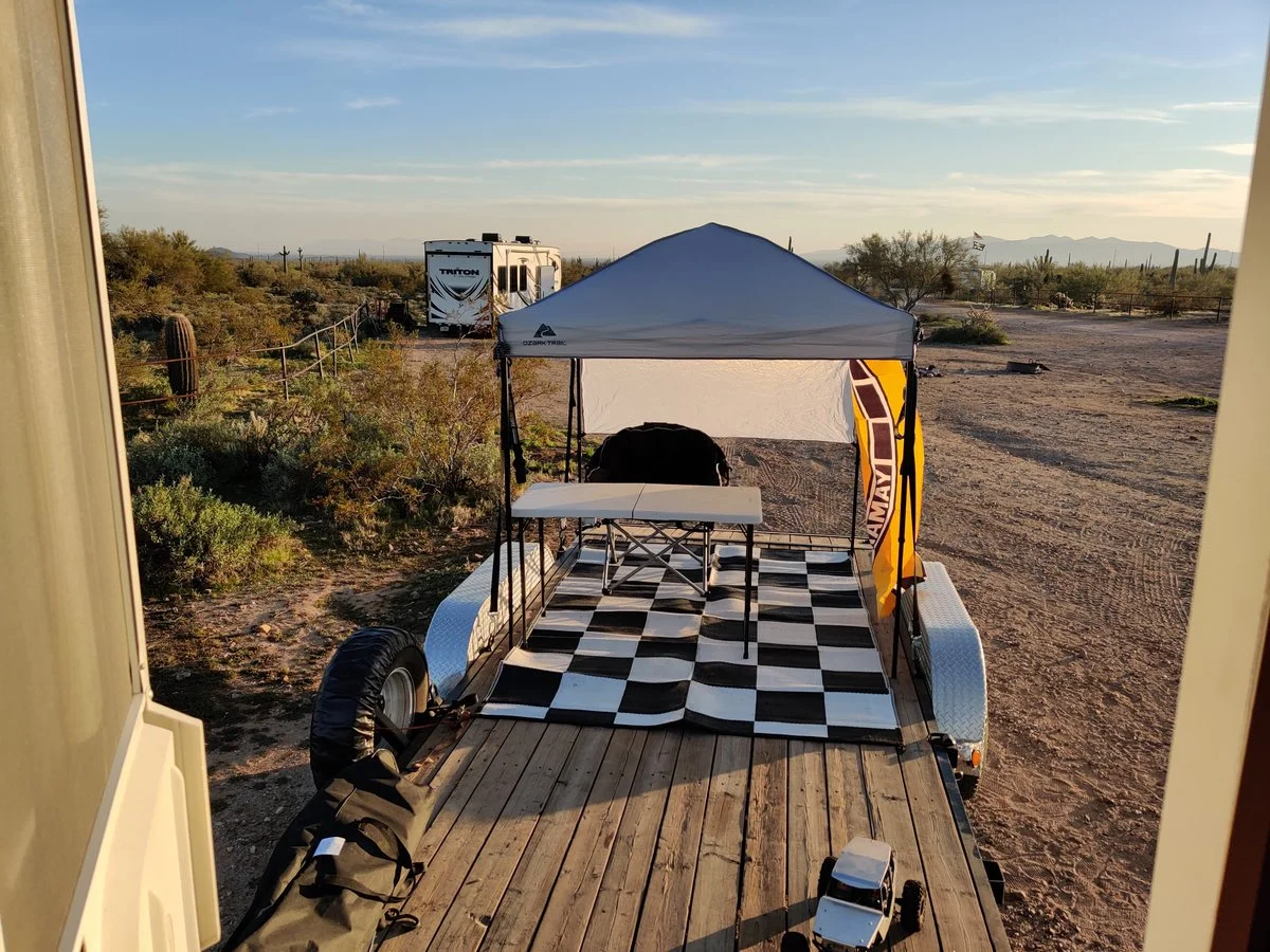

Camping deck:

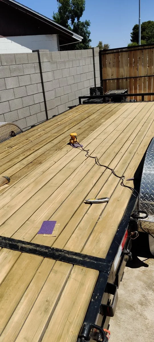

I finally finished the sanding. I have to work tomorrow morning then afterward I am going to dress up in my social distancing gear and head to the hardware store for goop and supplies.
But I wanted to give some advice that I figured out. Maybe I am just a noob, but here it is. I sanded the deck with 60 grit sandpaper and the results were amazing. Nice and smooth compared to what it was. I read somewhere that you should sand with 60 grit and then with 220. After sanding it with 60 I was pretty impressed, and thought I am not going to waste my time with the 220, but my OCD got the best of me so I picked a small spot to sand with 220, and it was so much better even. Now it is crazy smooth. I am pretty excited not to get a sealer on it.

You went from 60 to 220? That's quite a jump in grit. I don't know that I'd worry about sanding that fine. It's a trailer. 220 is where I finish sand non-furniture woodworking projects, like cabinet, bookshelves, etc. If you want to knock the scratches down from the 60 grit, do 120-150 and call it a day.
