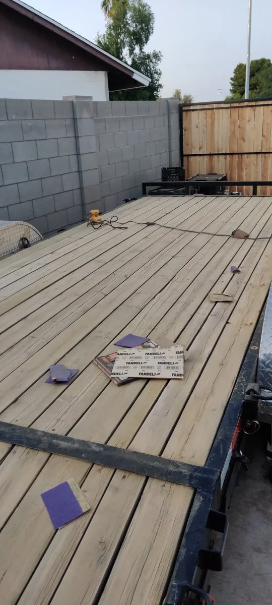

I finally finished the sanding. I have to work tomorrow morning then afterward I am going to dress up in my social distancing gear and head to the hardware store for goop and supplies.
But I wanted to give some advice that I figured out. Maybe I am just a noob, but here it is. I sanded the deck with 60 grit sandpaper and the results were amazing. Nice and smooth compared to what it was. I read somewhere that you should sand with 60 grit and then with 220. After sanding it with 60 I was pretty impressed, and thought I am not going to waste my time with the 220, but my OCD got the best of me so I picked a small spot to sand with 220, and it was so much better even. Now it is crazy smooth. I am pretty excited not to get a sealer on it.

Remember this is what I started with:

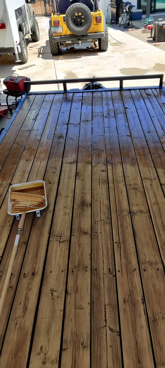

Here is halfway through first coat:

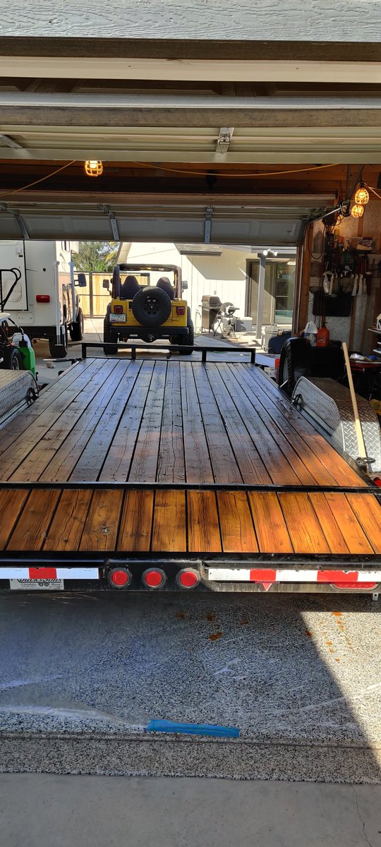

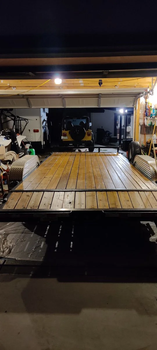

Here it is complete (2 coats) with some sun on it:
Completely finished (2 coats)
