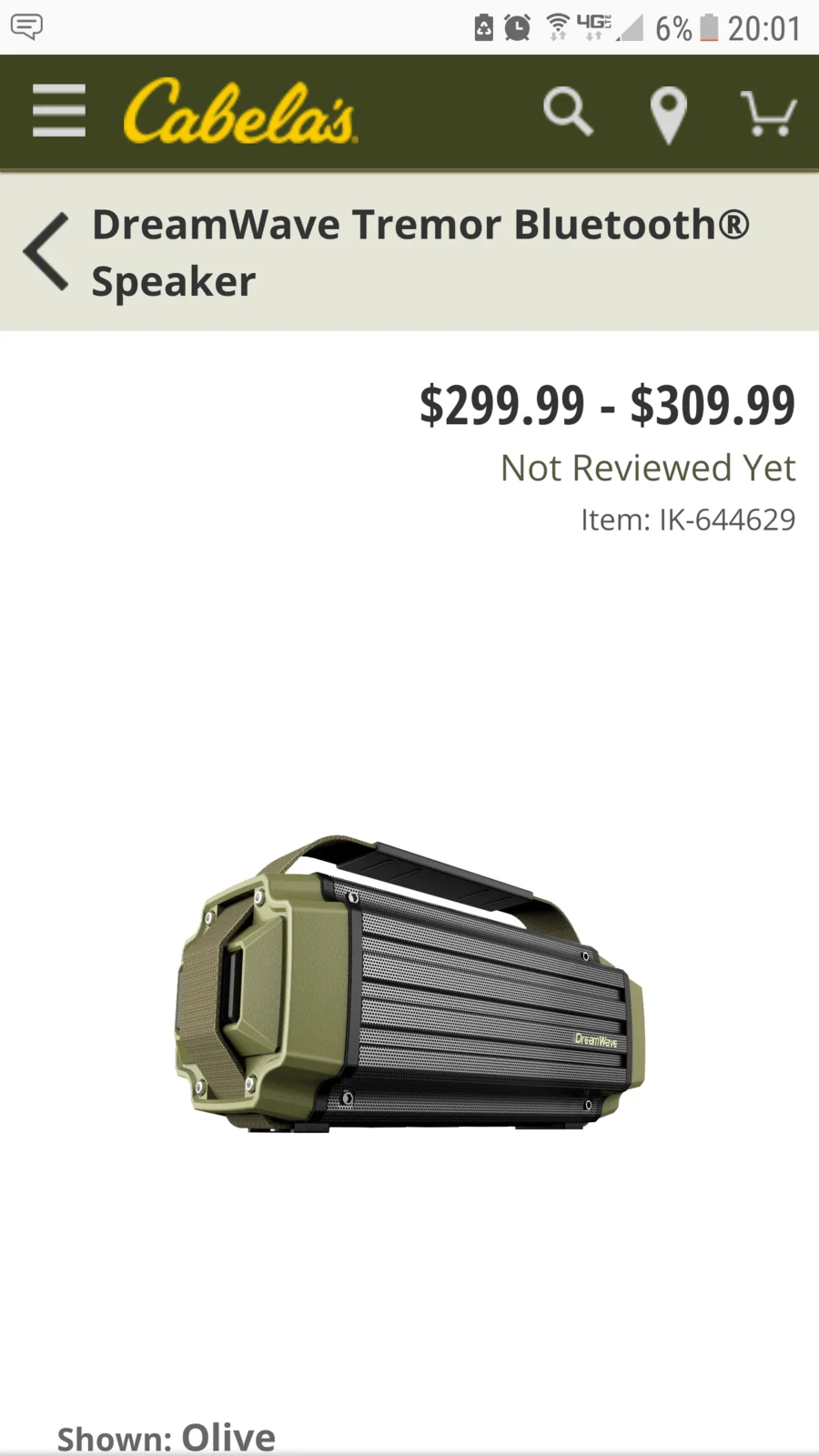

I just replaced my speakers with the Polk 6.25 in the pods and 5 .25 in the dash. While they sound way better than the originals it still needs a sud. I saw a Bluetooth speaker at Sams club that sounded awesome. It was the duel speaker set up. I wondering if that would have been the way to go since I use Spotify for all my tunes.
