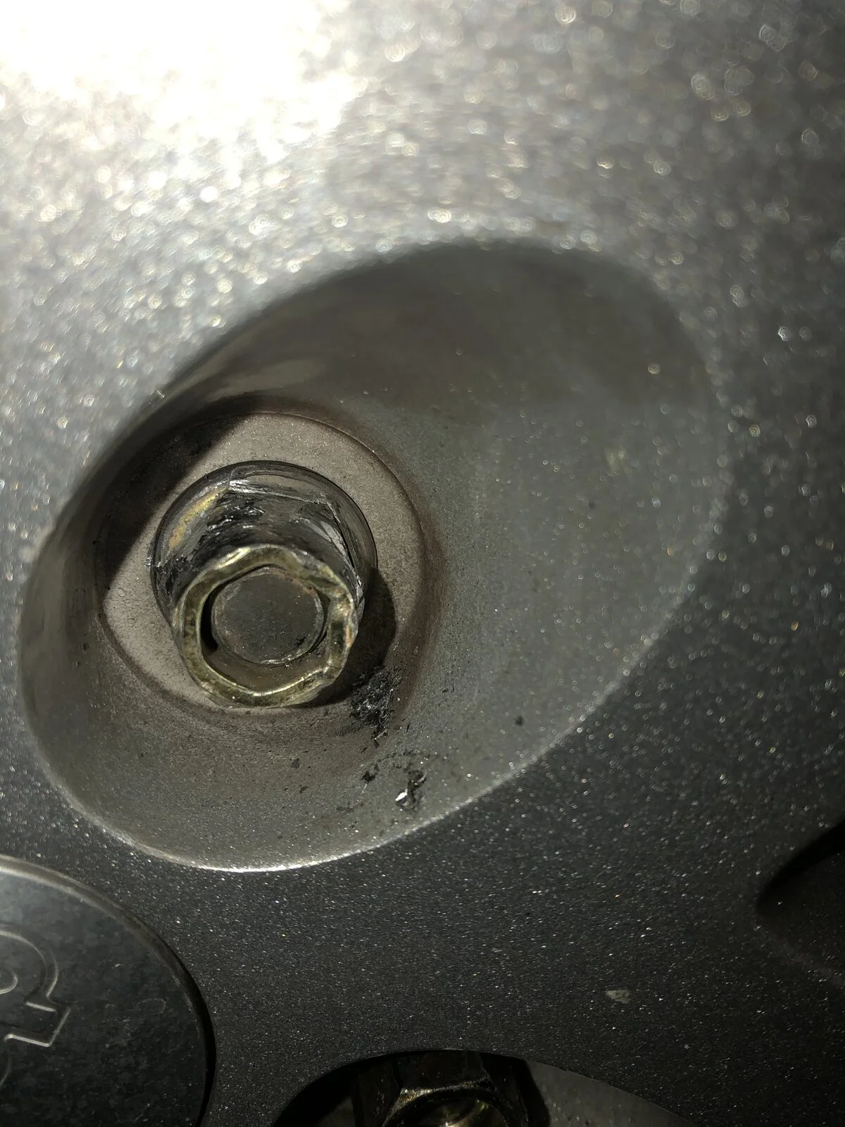

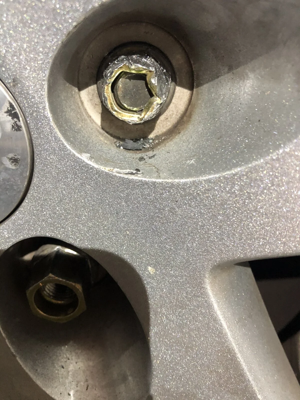

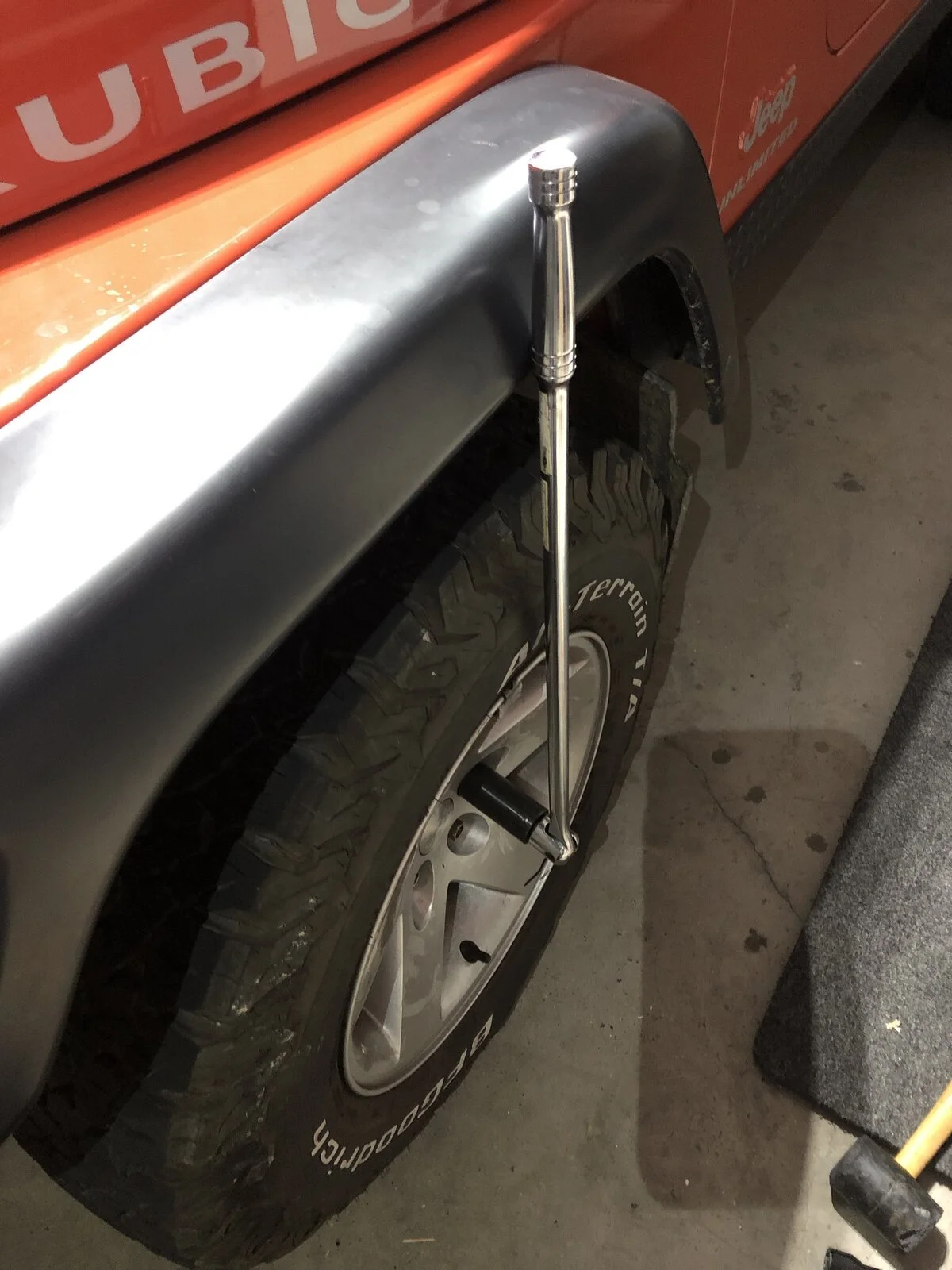

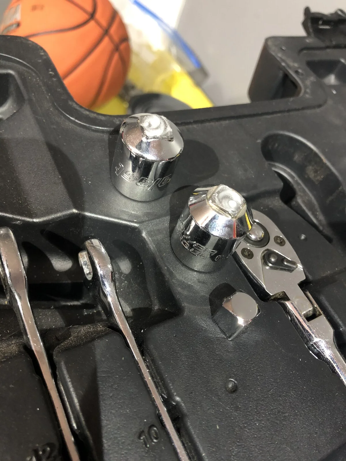

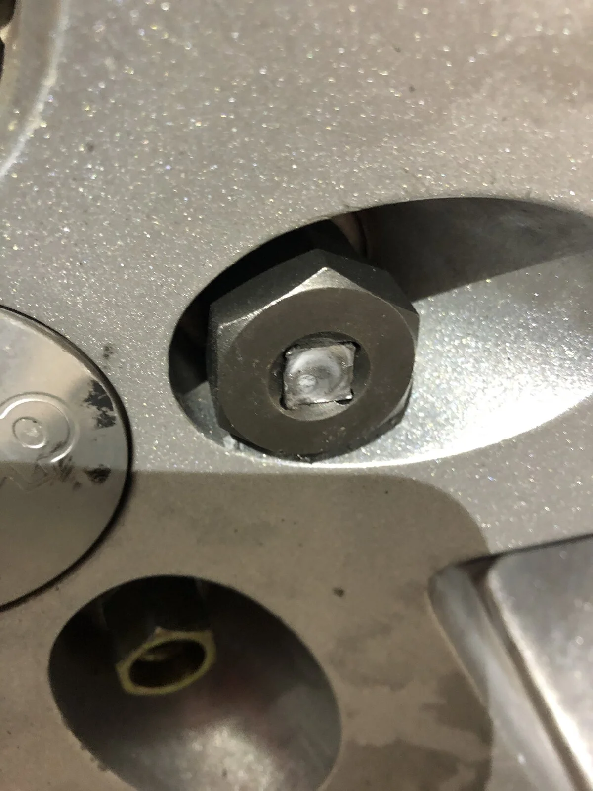

This is how I feel today.... two piece lugs are terrible. Will be upgrading lug nuts ASAP and possibly replacing both front wheel hubs. All other lugs are loose and ready to put the Jeep on Jack stands. Trying to get the axles out this weekend but this one lug is holding me up lol.

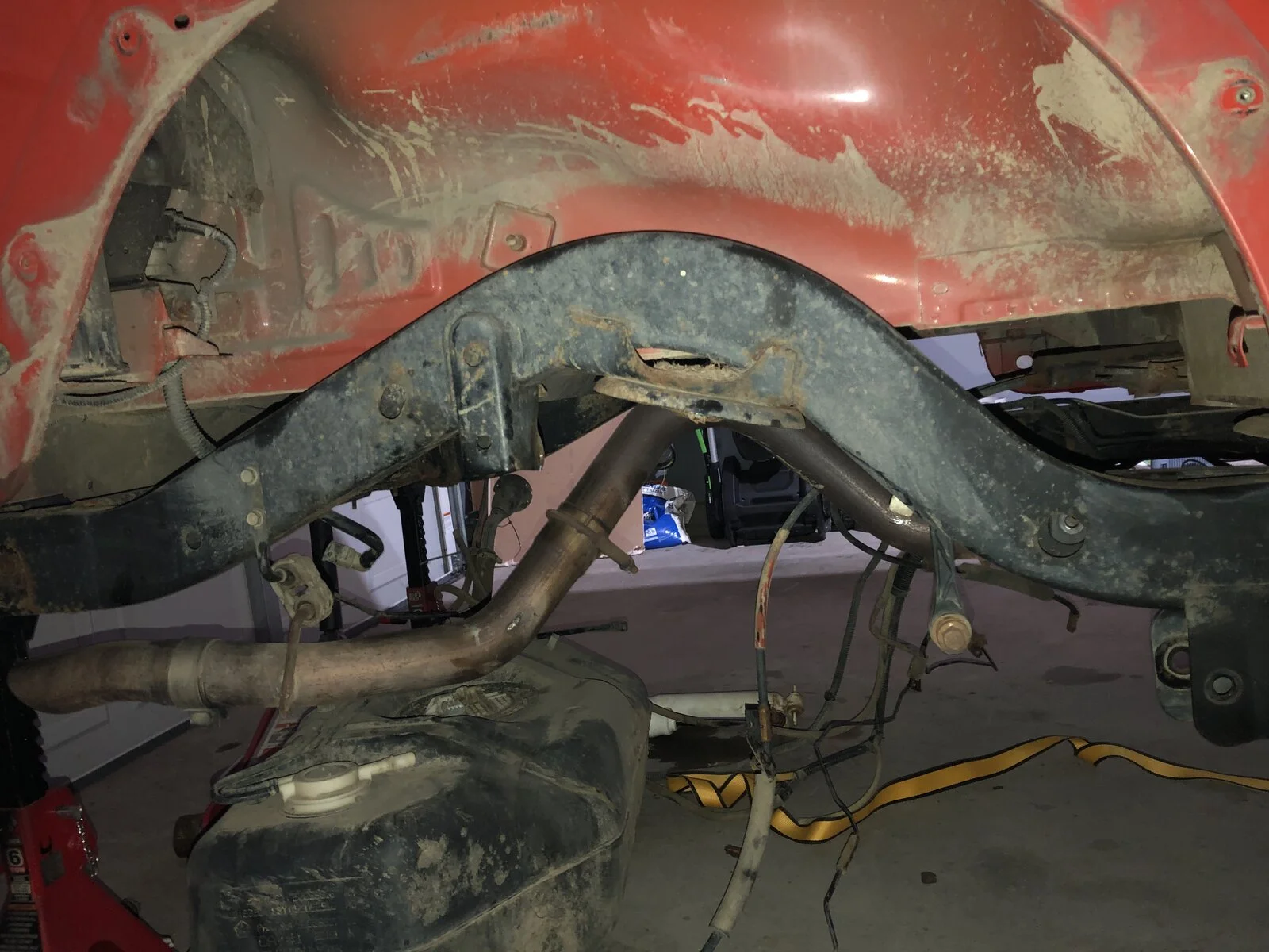

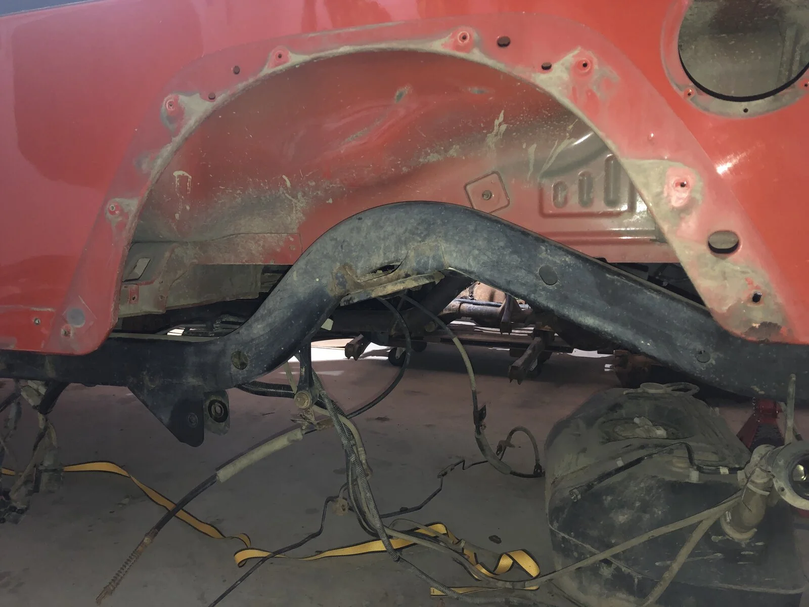

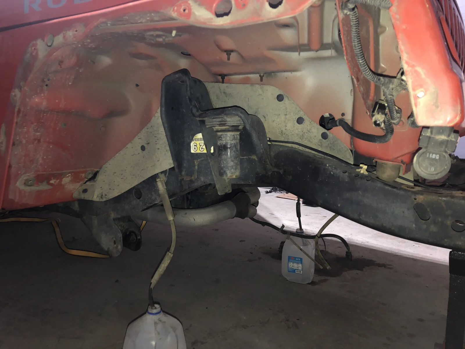

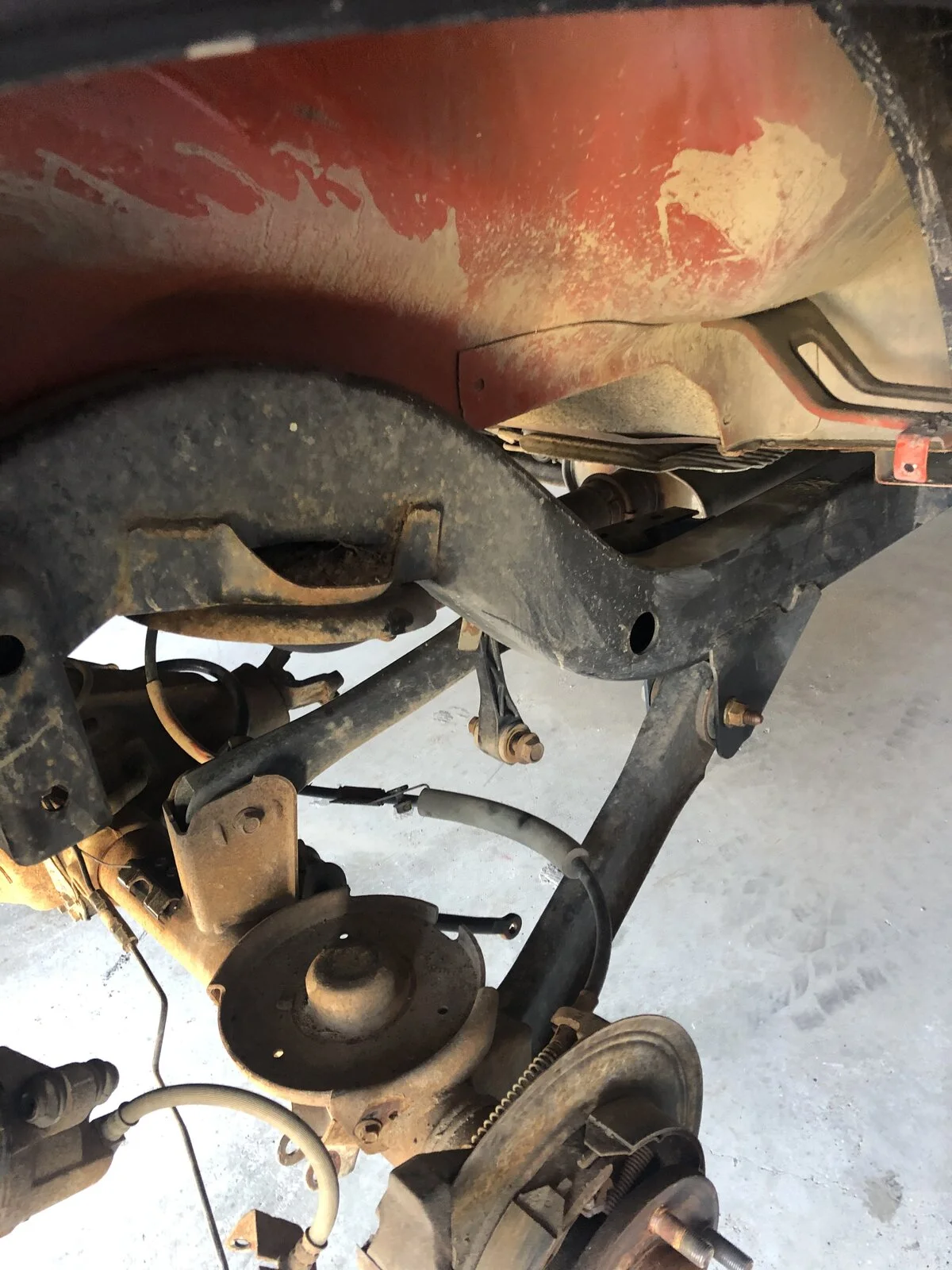

Pulled the inner fenders earlier and was pretty pleased with what was behind them. Everything just needs a solid cleaning/detail.
So far, my assumption has been correct that the axles are the only surface rust for the most part on the entire Jeep. Frame and tub supports are clean. Just giving them a refresh. Axles will be a night and day difference here soon and no one will ever know they ever had surface rust to begin with once I’m done with it.

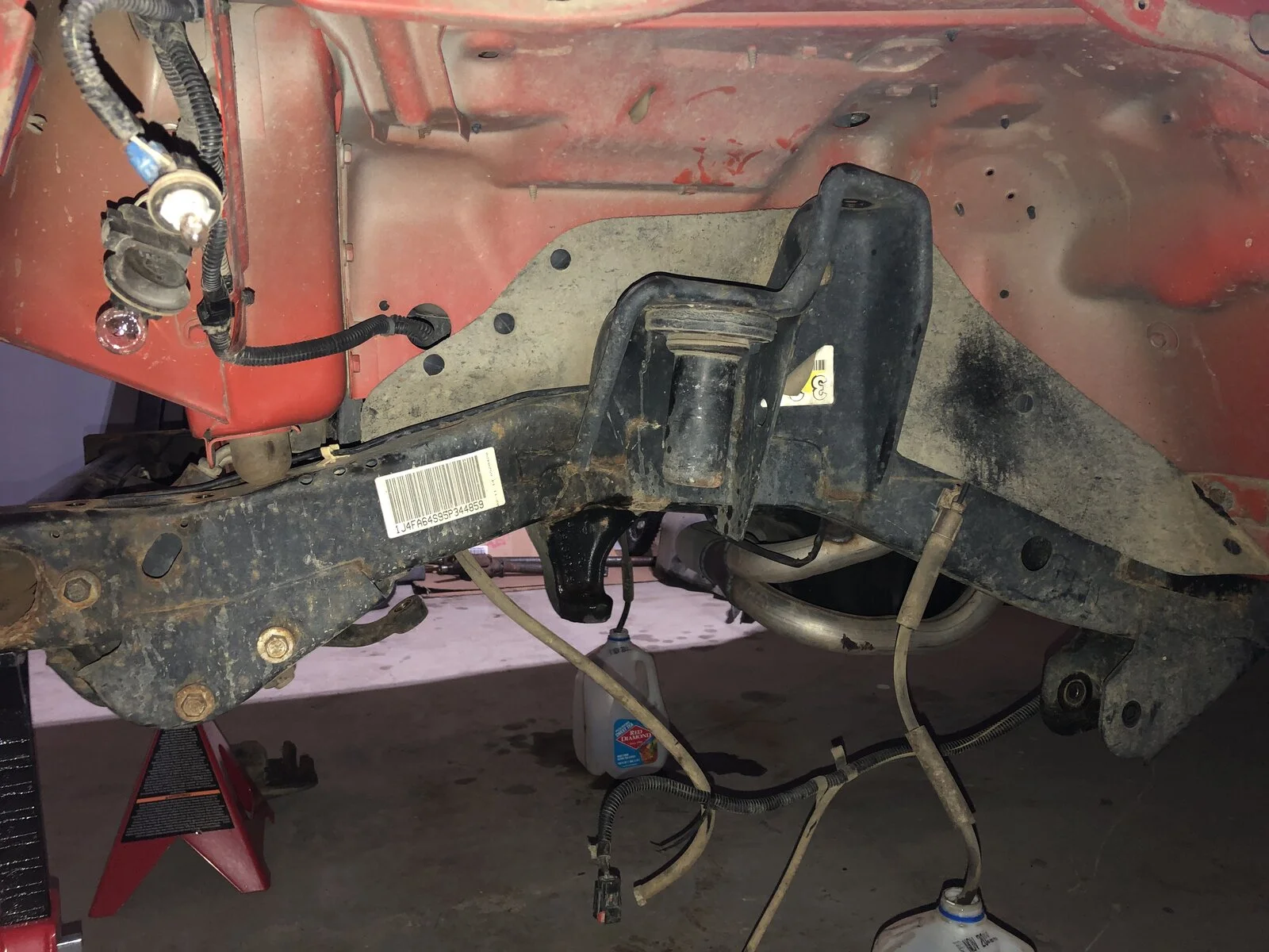

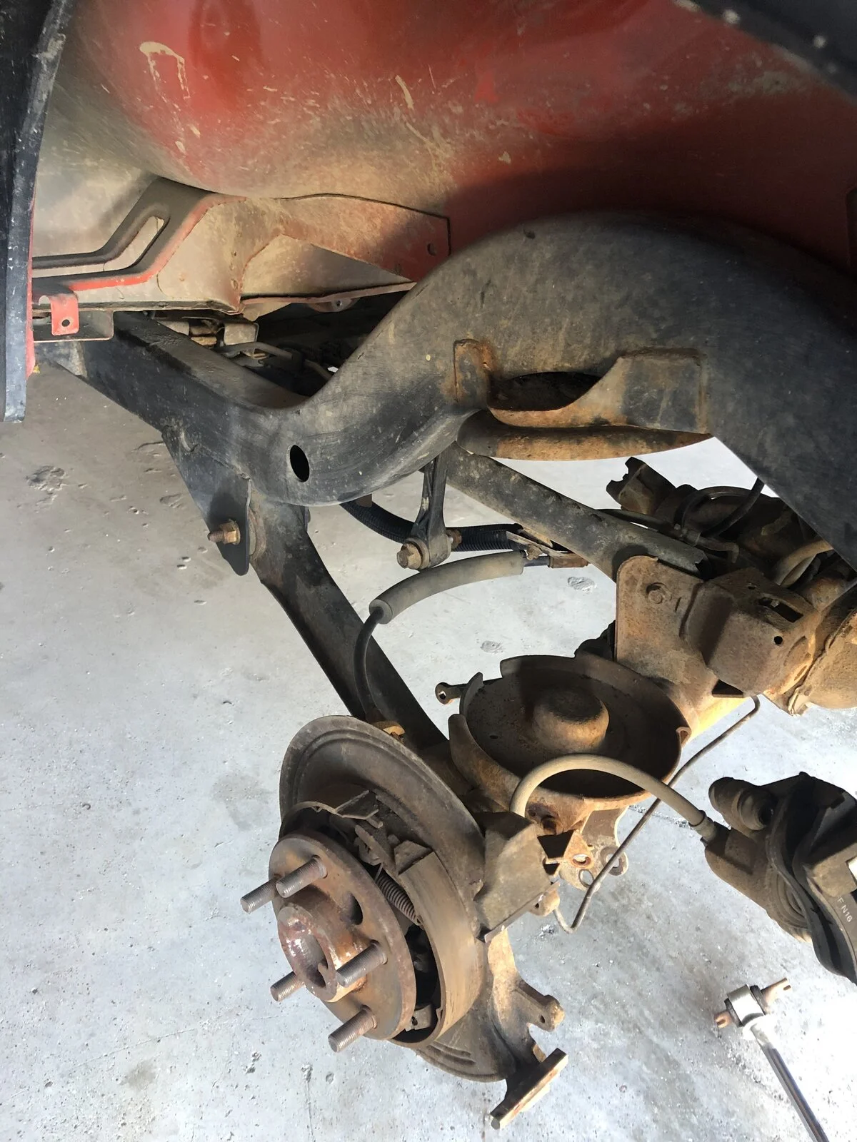

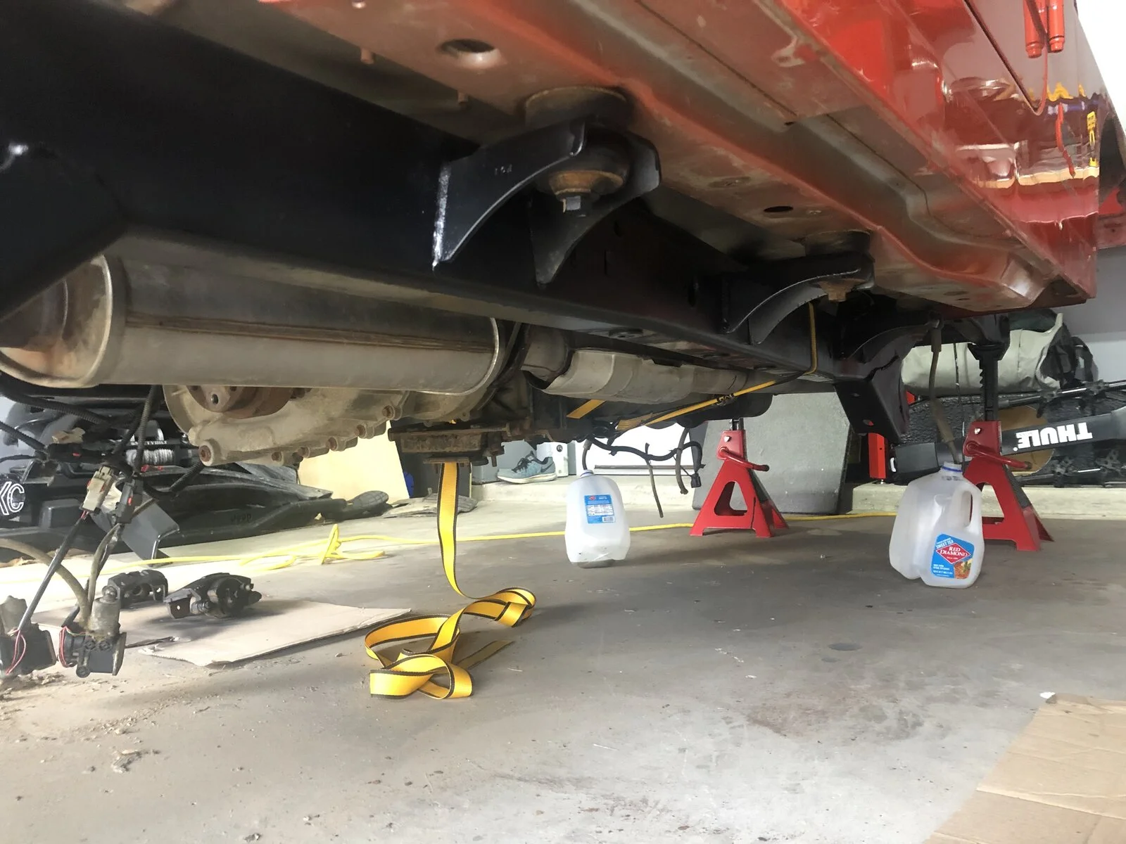

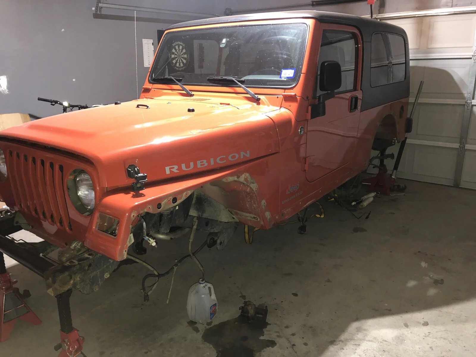

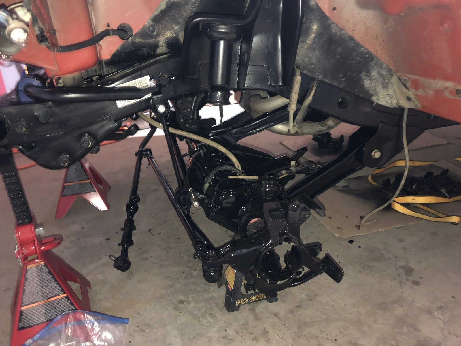

Big day today!! I love that you can take a Jeep apart from the frame down in a solid days worth of work. Not very many vehicles you can do that with in your own garage with a buddy.
next thing to do is get some parts ordered, power wash the in every nook and cranny, start scuffing up some areas and get the frame painted while the axles and other parts are being sand blasted/painted by my uncle.

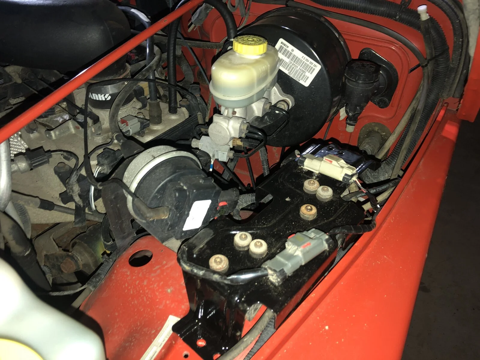

Here is all the parts I’m getting ordered this week to get it back together. Also going to relocate the locker pumps under the hood in the process. I found @Chris ’s write up which helped a lot!

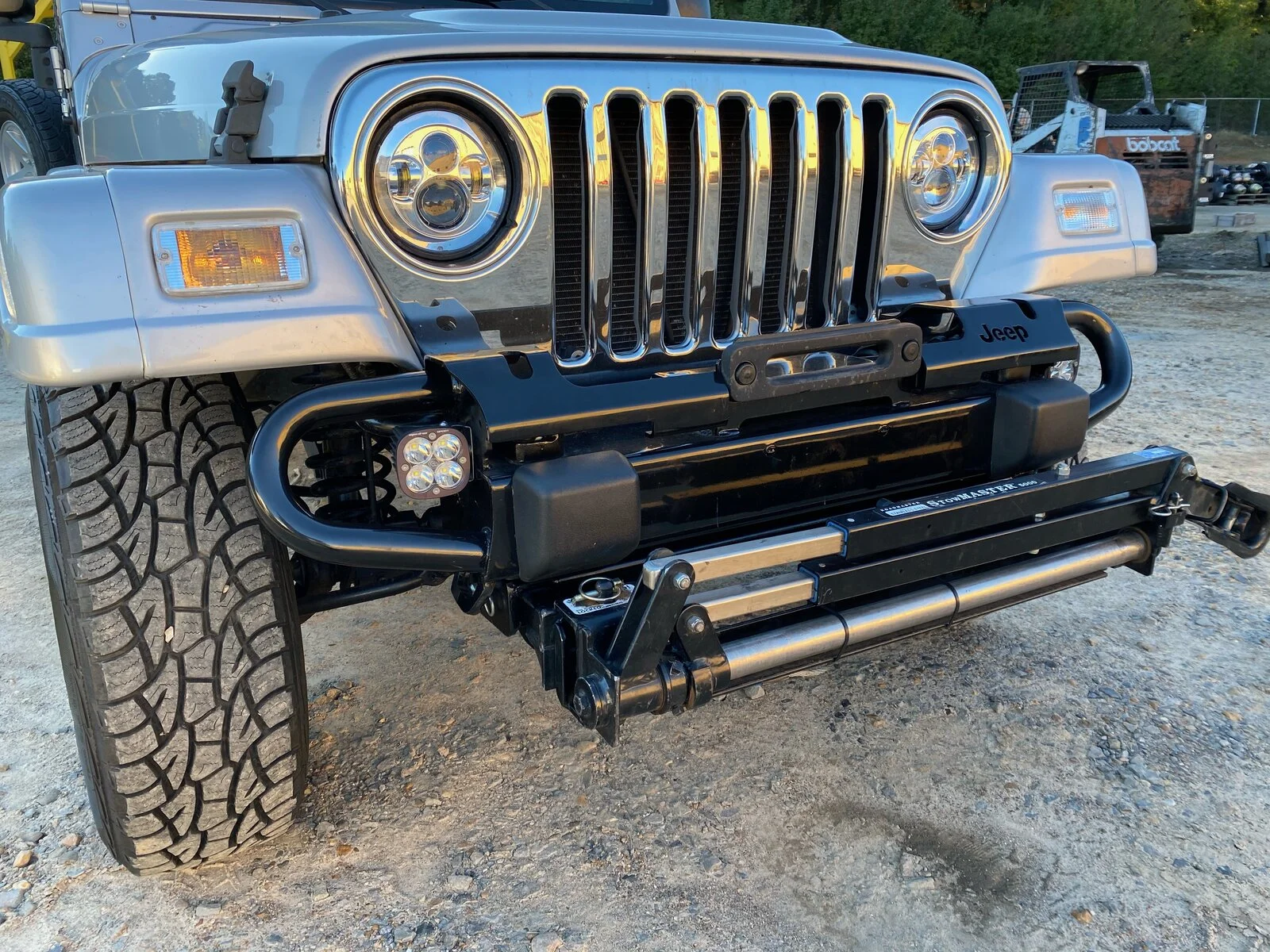

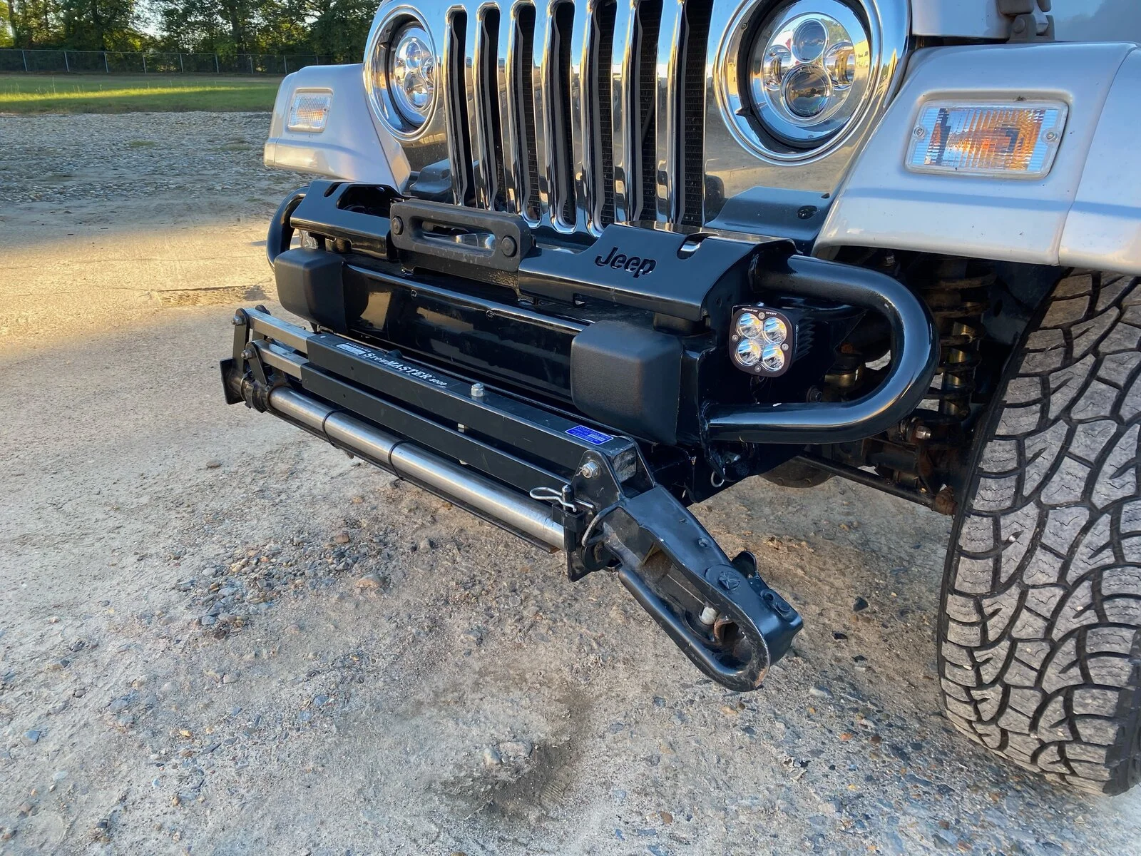

Also, my uncle just got done building a bracket to mount underneath the Mopar bumper for his Jeep to mount the tow bar. He is going to make one for us too! As you see, he has a pretty awesome set up lol.
Will be nice to flat tow the Jeep at any point in time if wanted/needed!

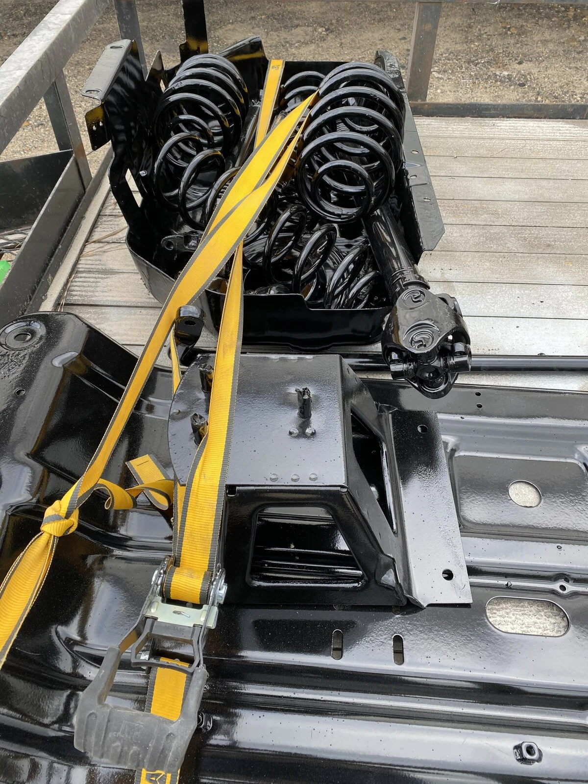

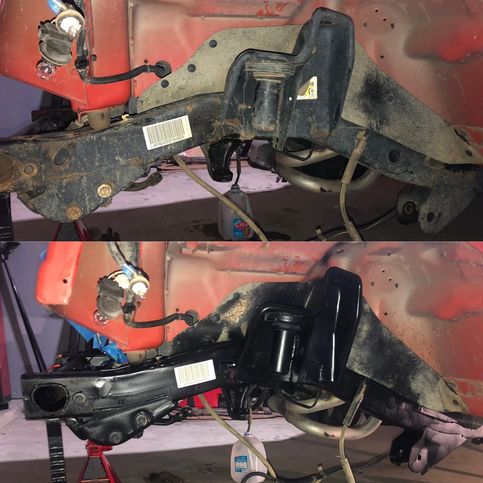

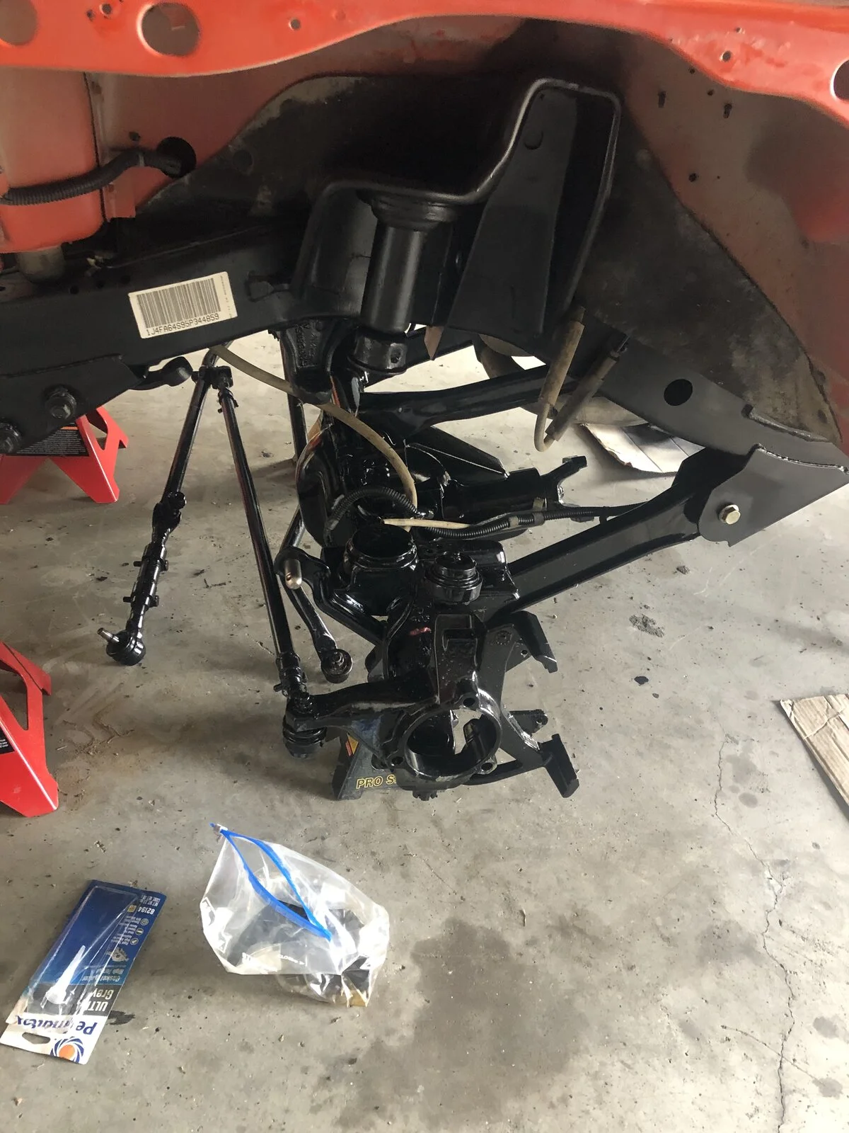

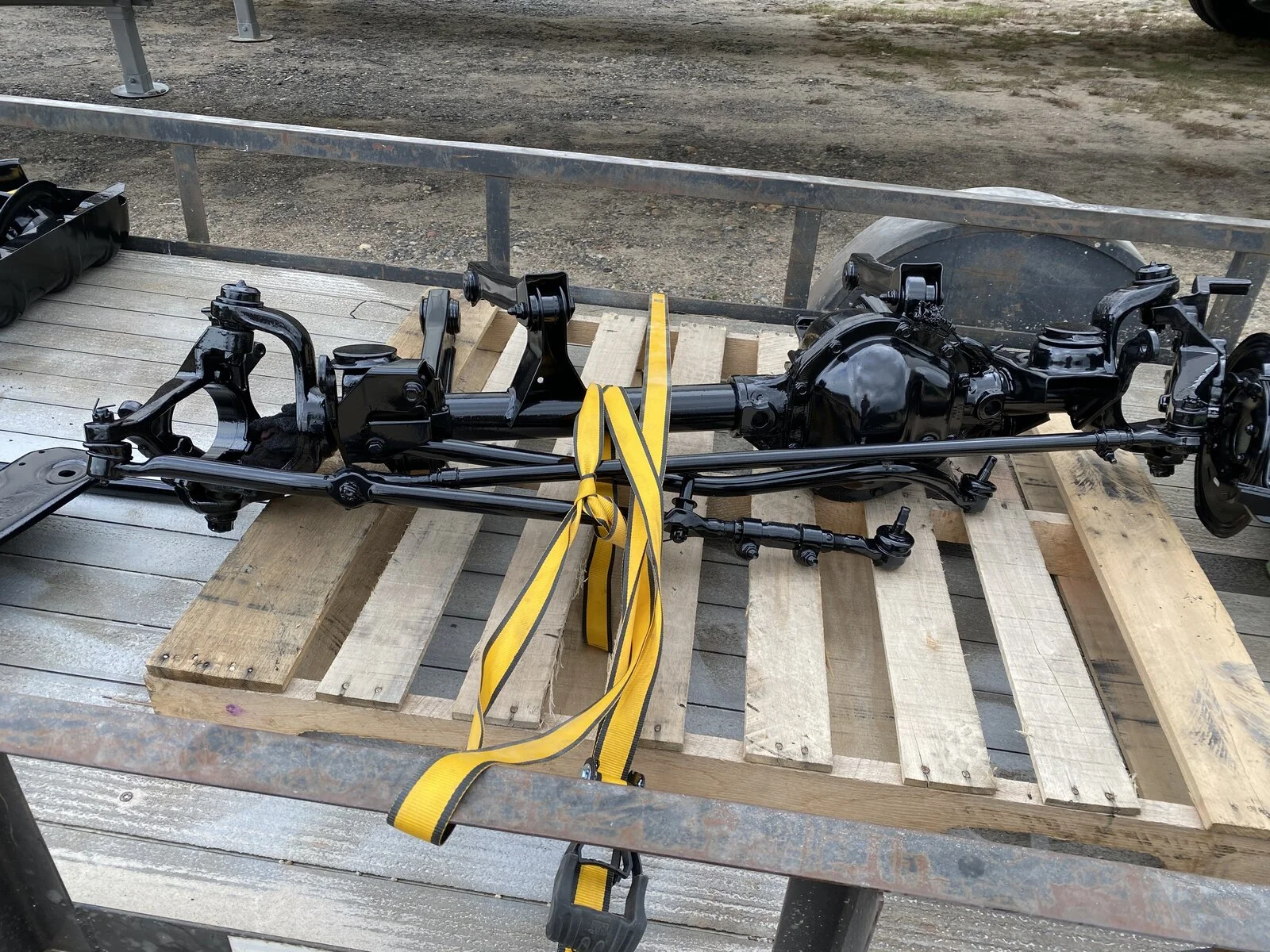

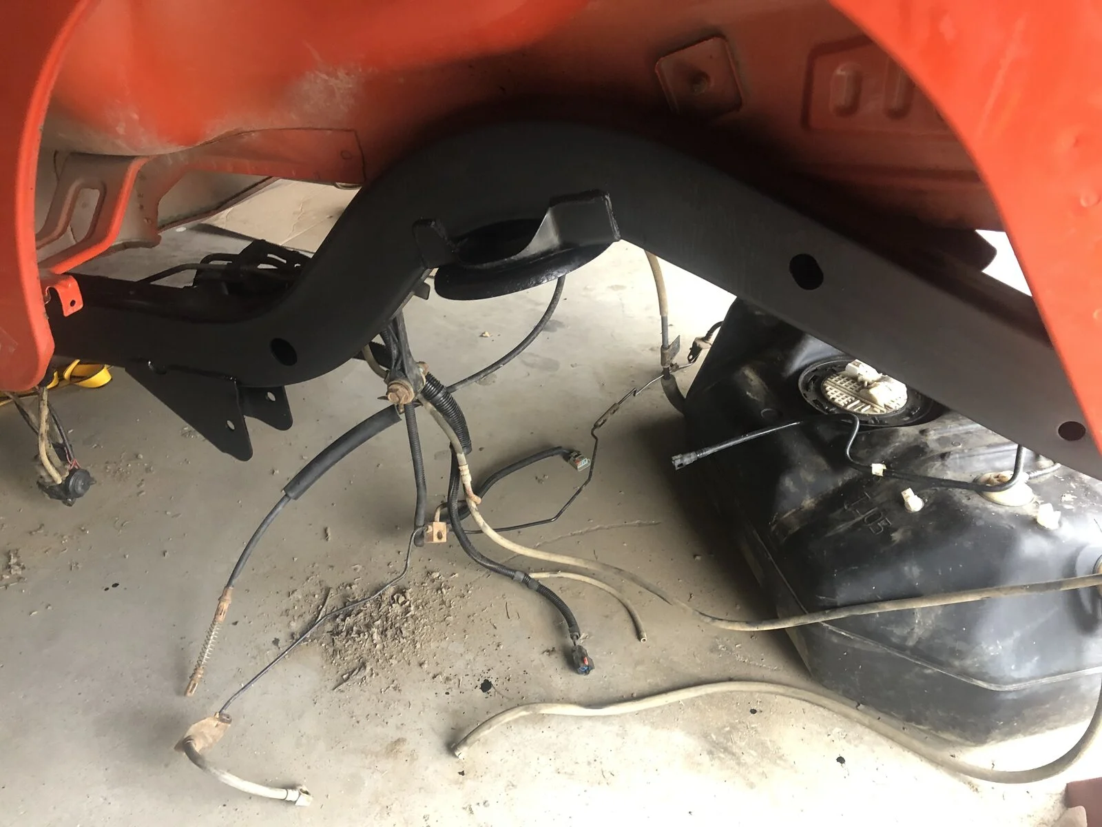

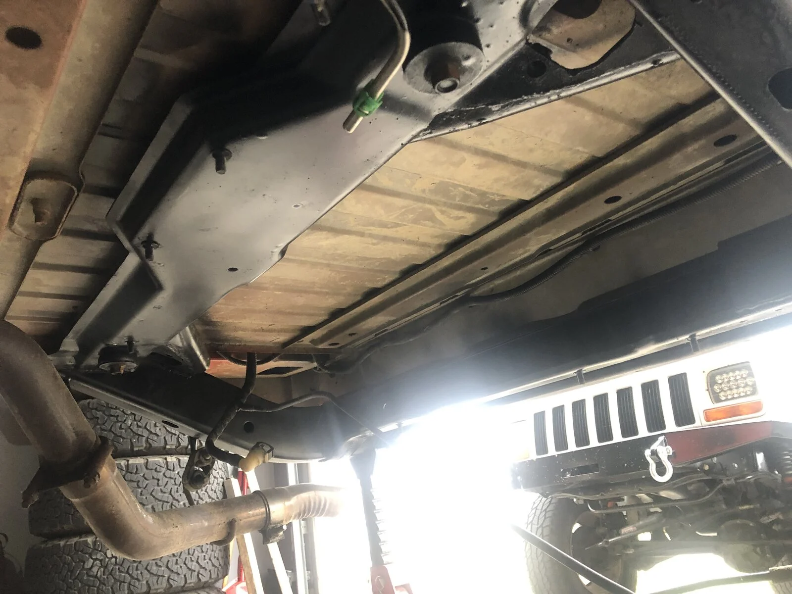

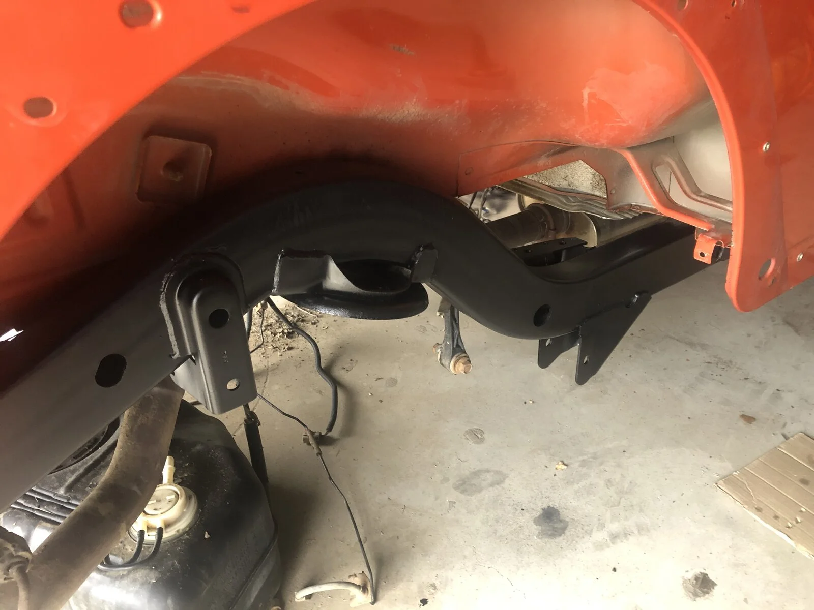

Got the frame cleaned up and the axles, skid plates, and suspension parts sand blasted and painted. I didn’t worry too much about cleaning up the body bolts since we will plan on doing a tummy tuck and will be replacing them in the near future.
All “Phase 1” parts should be in by Saturday and will hopefully have the Jeep back together and on the road by Sunday! Getting pretty excited about it!
Did I miss what was used to paint the axles? Looks nice.

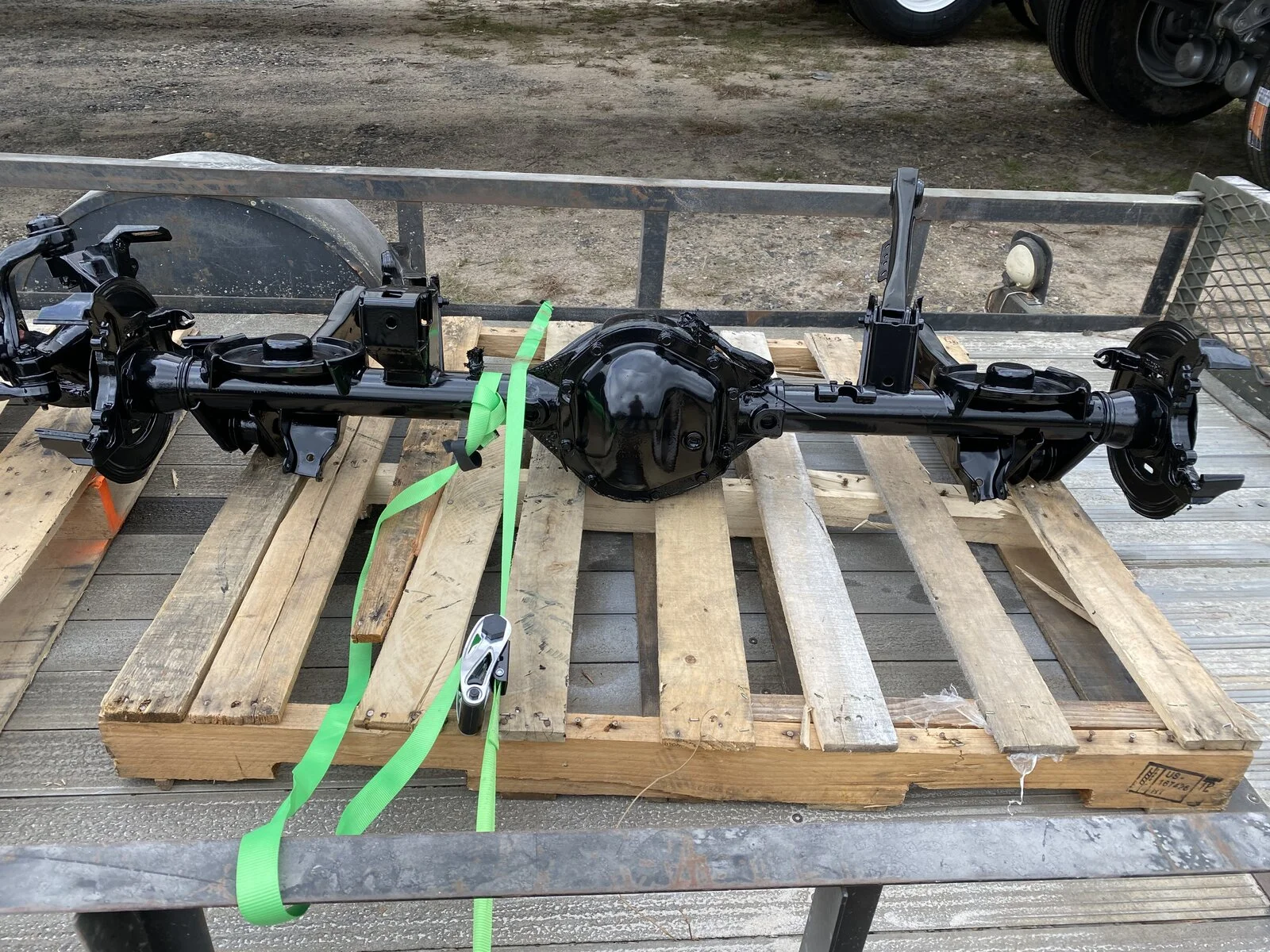

I used VHT chassis and roll bar paint on the frame. I cleaned and degreased everything thoroughly before painting. Even used a wire brush in some areas.
My uncle owns a shop that builds diesel trailers. He sand blasted the axles, skid plates, springs, steering. And a few other pieces. They have a zinc coating rust prohibitive spray that they use before applying their chassis paint. The chassis paint they use is some really high quality thick stuff too. When he sells a trailer, it never comes back for rust or paint issues. He makes sure of that.
the parts he painted came out a little glossy but I’m sure the first puddle I drive through and some roads grime will tone it down some. Everything is turning out really nice so far.

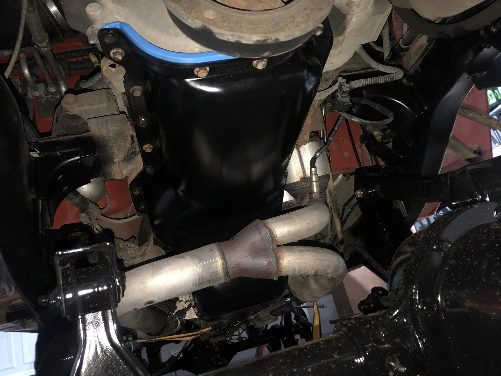

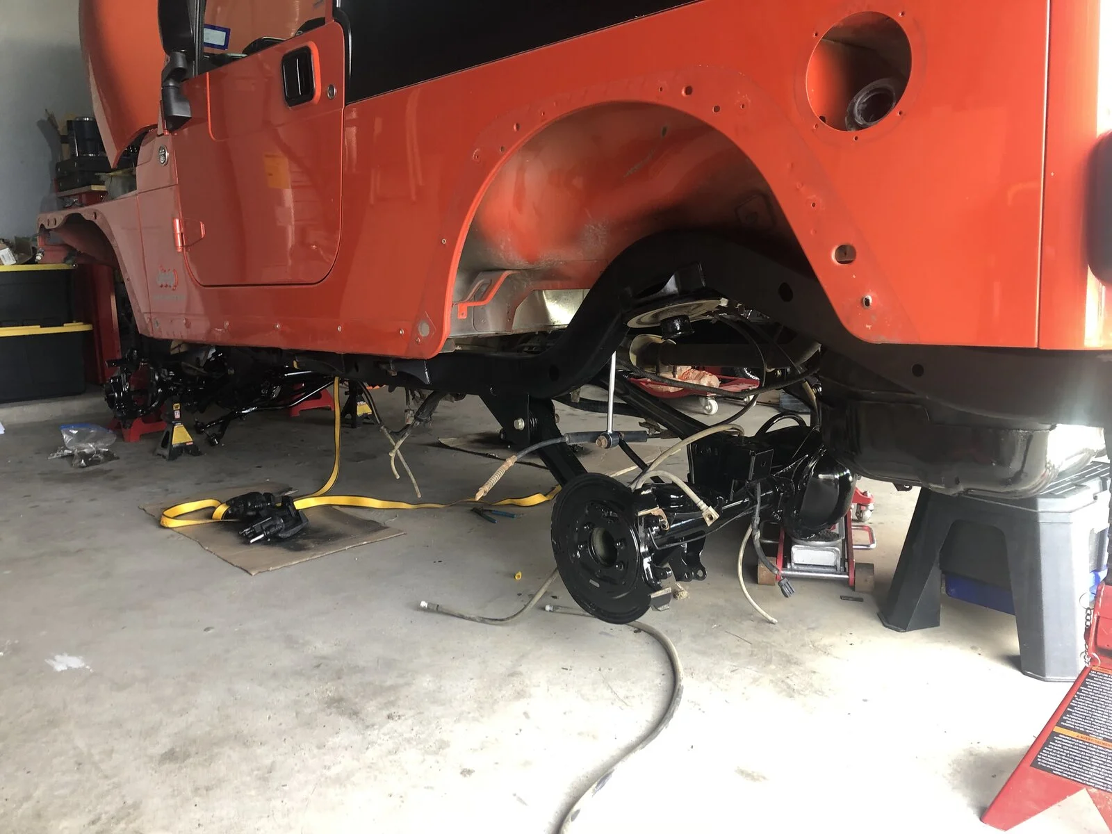

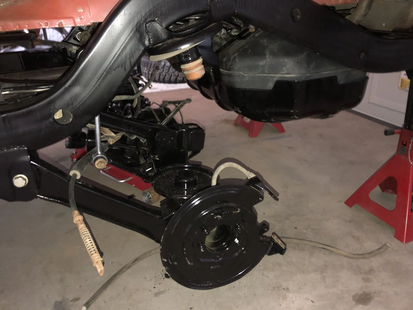

Got a lot done today!
Rear main seal, new oil pan/oil pan seal, new fuel pump/gas tank installed, axles are in, and the locker pumps have been relocated under the hood.
My buddy is taking the front axle shafts and both driveshafts to rebuild for me tomorrow and coming back Sunday to help me button everything up. Excited to have the Jeep back on the road!
