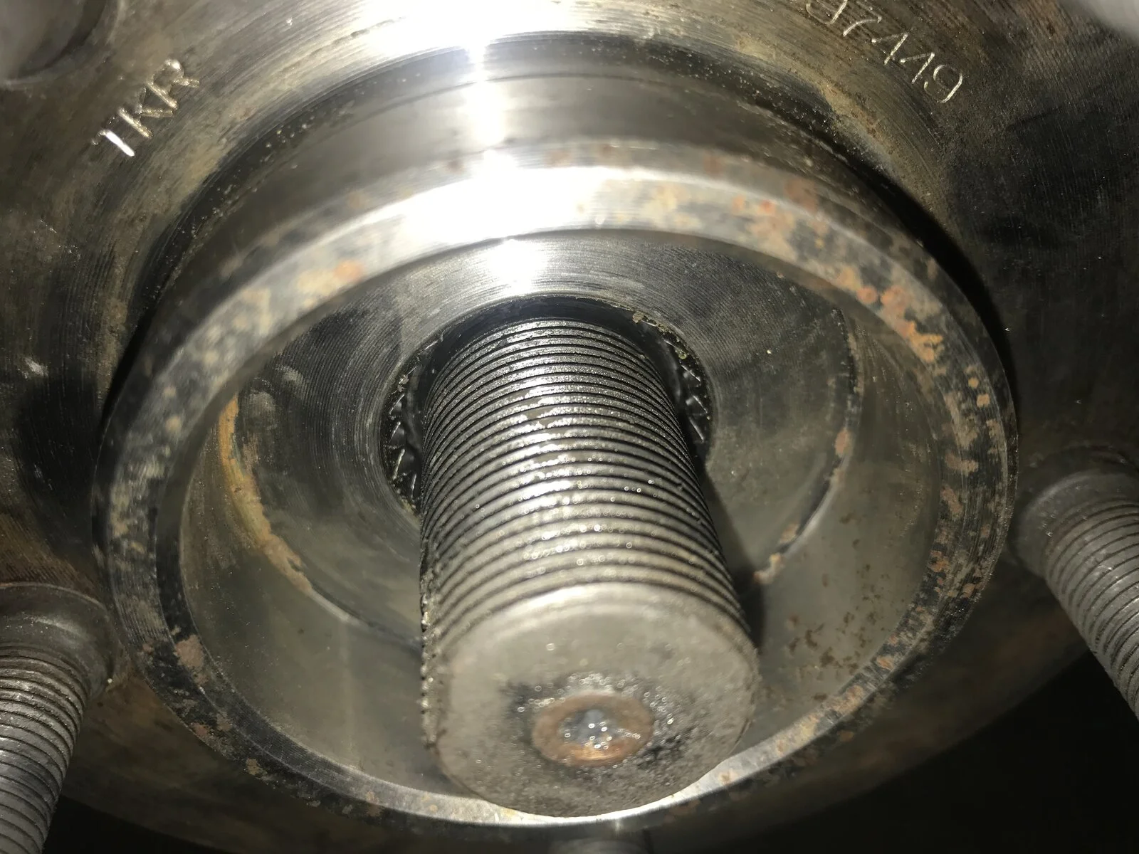

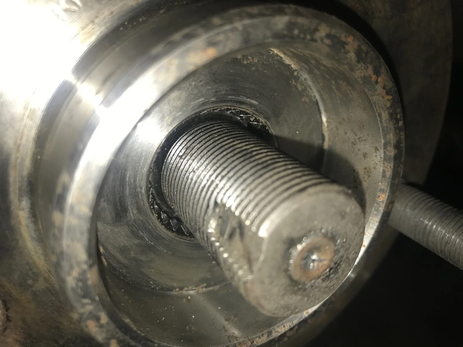

below are pictures of the bearing in question before I replace it. It looks like there is a bit of space between the surface of the bearing and the splines on the shaft. I assume this is normal but I don’t have a point of reference to think otherwise and I am able to torque it to the appropriate amount. Does anyone else have this issue or am I just being paranoid? I still need to pull the shaft and rebuild it but just looking for a second opinion from someone who has run these.
