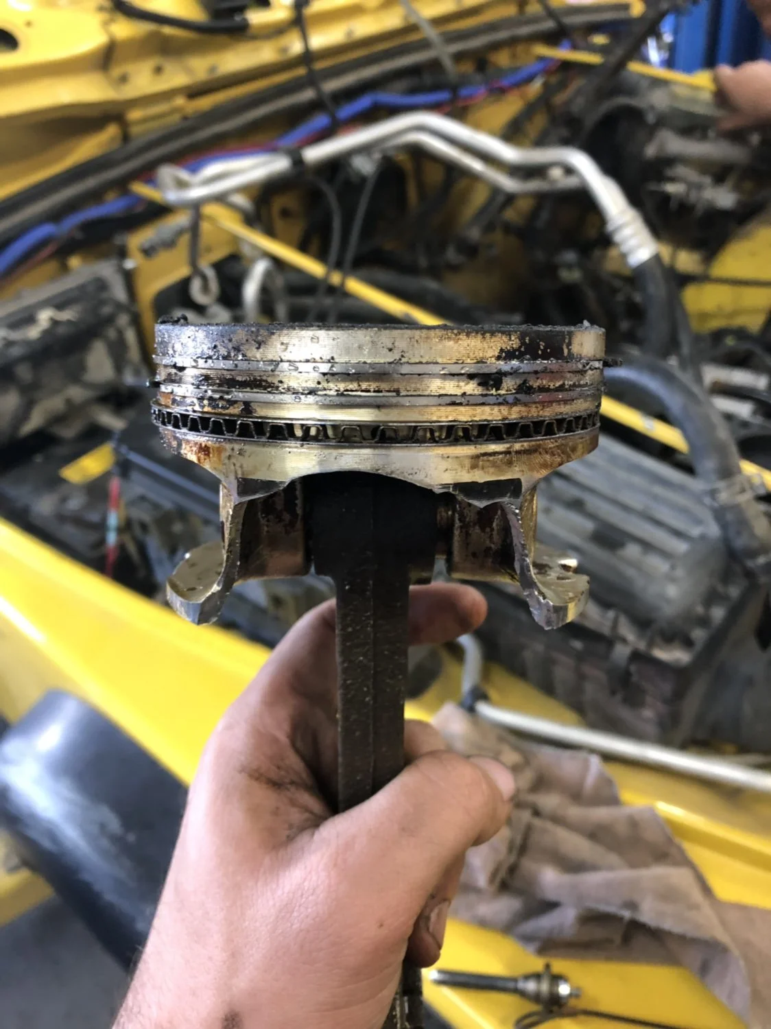

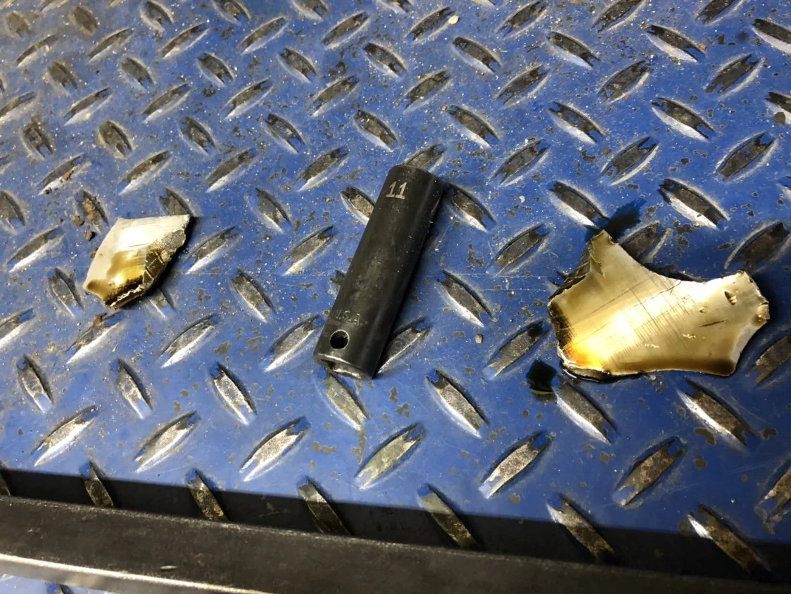

Not to freak you out. But I had a “ ticking” as well. Number 2 piston was missing half it’s skirt.

Your doing an in frame re-build? how are you going to take care of the beat up cylinder wall? A piston that looks like that, your going to need a bore job?
Cylinder wall is untouched. No damage, no scratches. Nothing. We were all shocked to see that.
