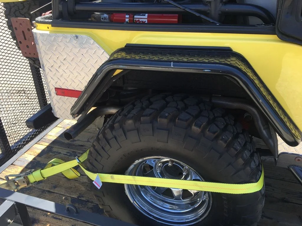

I have long thought that I’m trying to pull the axles out from under the Jeep tying it down the way I do. I have been intrigued by the tire straps but never used them. I thought about installing track and using them though as it seems like it would be much less stress on the suspension joints. Are the 3” straps you use strait over the tire or a basket or halo type set up? As far as a bulkhead I could certainly build a removable one that could pin into the stake pockets From one side to the other for when towing my Jeep pretty easily to take care of the front. I’d have to figure out the lateral but I’m sure it wouldn’t be too hard.
I wouldn't cross your straps like that... What happens if one strap fails? And if they won't fail, than why not just use one big strap?

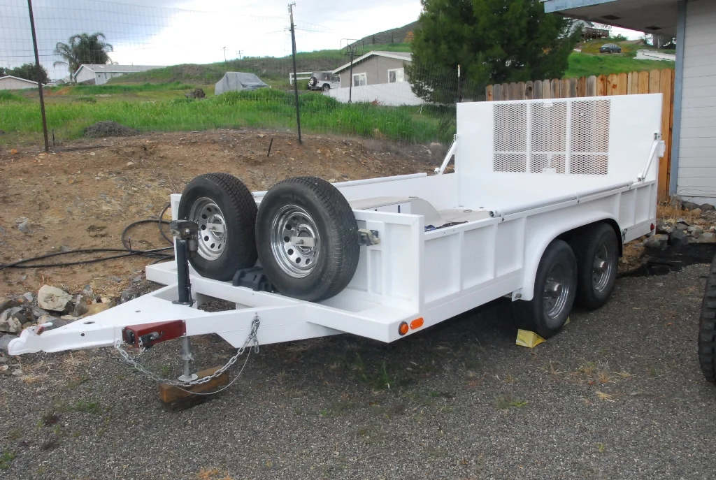

That's a good price on the trailer though! My 2020 suretrac cost me 4500 before the great state of ct taxes and that was the cheapest I could find here and around CT.
I have been using these for about 5 years. they cinch down good, no climbing under the Jeep. Repo guys and car haulers use them. Simple D ring. I don't have any pics of them on the TJ.
My belief is to keep the pulls short. cross tying can loosen if one breaks or for whatever reason lets go. With single sided pulls,they individual strap will stay tight. JMHO

This one was $3800 with the upgrades I added. It’s a 20’ so 18’deck and 2’ dovetail rated for 10400#. I got brakes on both axles, a total of 8 d rings welded on and another 4 movable d-ring mounts that go into stake pockets, rub rails, rear stabilizer jacks for loading, rear pull out ramps, removable fenders, and a spare tire and mount and a winch mount. Then I added a front storage box when I got it home. I drove to TX to pick it up and saved myself about 1500 over what they wanted for the same trailer here in CO. Plus I was going to have to wait 8 weeks for them to get one. That’s why it’s hooked to the Jeep in the picture. Much better mileage than my truck. I averaged 21mpg pulling that empty trailer with the Grand Cherokee from Amarillo to Colorado Springs.
