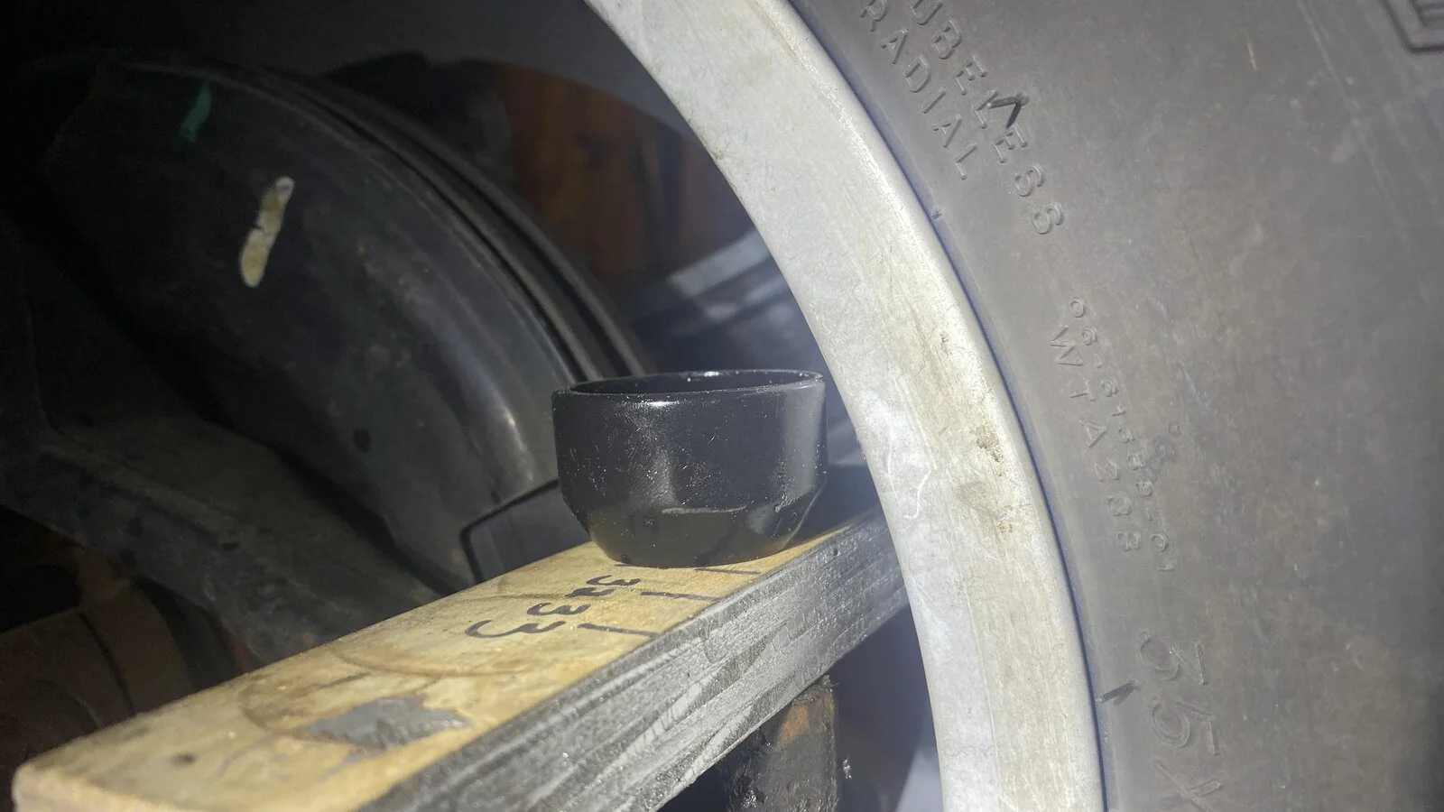

It will work with 4.25” BS. It is very close, but here’s what I did bc you can’t sneak the Currie TR end to mock it up due to the sway bar bracket we’ll eventually cut off when we do this. I measured the Currie TR diameter. It is 1 3/4”. I measured its height torqued down which was 1 1/2”. I crudely mocked it up using an extra TR end boot that was exactly 1 3/4” diameter and sat it on top of a piece of wood l. All said and done it was 1 3/4” tall, which is 1/4” taller than required. Then I put the wheel on and while it’s very close to the wheel at 4.25” BS, it did not touch. That’s good enough for me, especially since the actual TR End is 1/4” shorter than my mock up.

Great visual. My knuckles are off the axle so couldn't do much of the same. Thanks for mocking it much. Looks like we both should be good to go.
