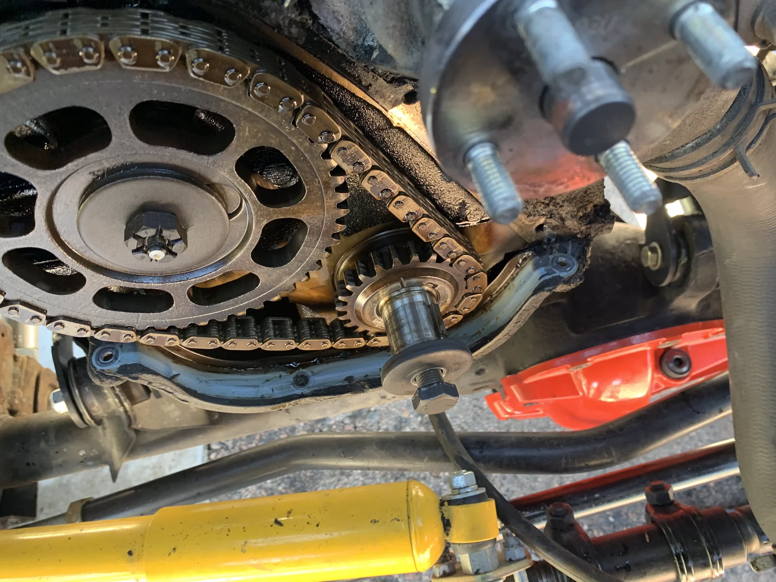

I have a 98 4.0 that I replaced the timing chain on about a month ago and put everything back together the same way I took it off. Before I replaced the timing chain, I had been diagnosing a very annoying engine rattle that I could only hear when the engine was being lugged (quite often with the 3.07 gears), and only figured out it was the crankshaft oil slinger a few days after everything had been put back together. Now I'm ready to tear it apart again, but my question is, how important is it to keep this oil slinger on? This rattling has gotten on my nerves and I have searched everywhere, and have not found a clear answer. If it is important, how do I stop it from bouncing around?
