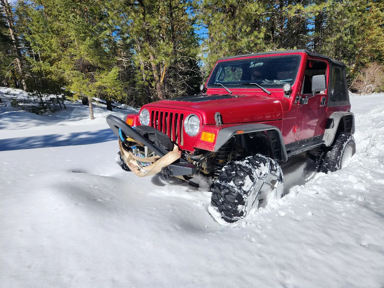

35 KM3s and 4-6 psi (and a winch) and I don't need chains.
