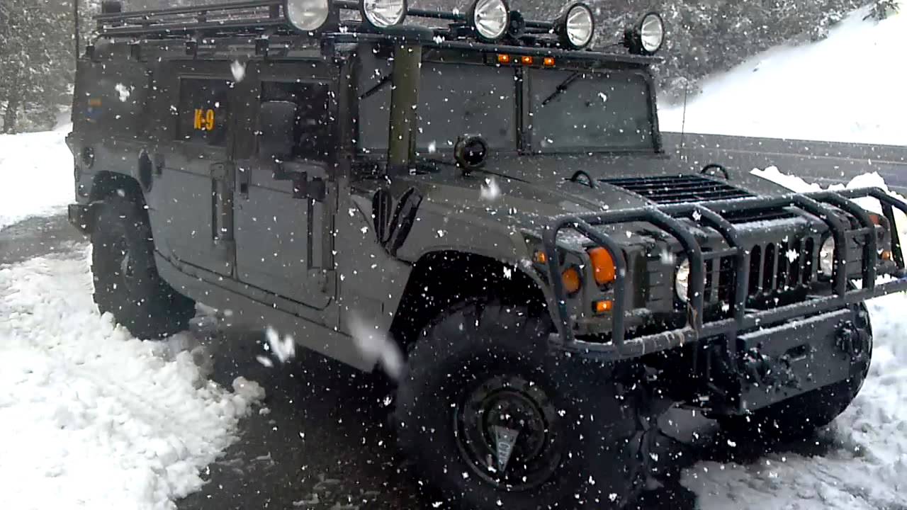

Vulture. If you still need a chain for your TJ, you need to trade it in for a hummer for you do not need a TJ.
Personally, I have never seen a TJ using a chain on winter. I had KO2 back in Chicago, and I did just fine :) and I know you will too!
Thanks for the quick reply. I guess I wasn't clear when I posted my question. Just to be clear, I've driven for about 50 years in the snow and ice and sleet and freezing rain and drifts and frozen mud and cold temps so I'm not really inexperienced at it. I'm not asking anyone to advise me on IF i need chains. I'm respectfully asking those who have experience with chains to forward their first-hand knowledge and recommendations on the topic. You're right though, the TJ is absolutely amazing in the crap. There are limits though and I've reached them. By the way, I'd dearly love to have a real Hummer (not the fake Chevy "hummer"). Around here though, they won't fit between the trees and won't really make the tight turns. It's awesome that the one on the pic is a K9 unit!!

Vulture--AM General (division of Chevy) made the HMMWV. I have worked on these POS for over 20 yrs now. I would never have a Hummer even if it was given to me. There only real quality is the Torque-Bias Differential. Its a brake modulated locker. Works great but with the weight of the stupid thing, I will gladly take my CJ2A over a hmmwv any day! Just my two cents...
