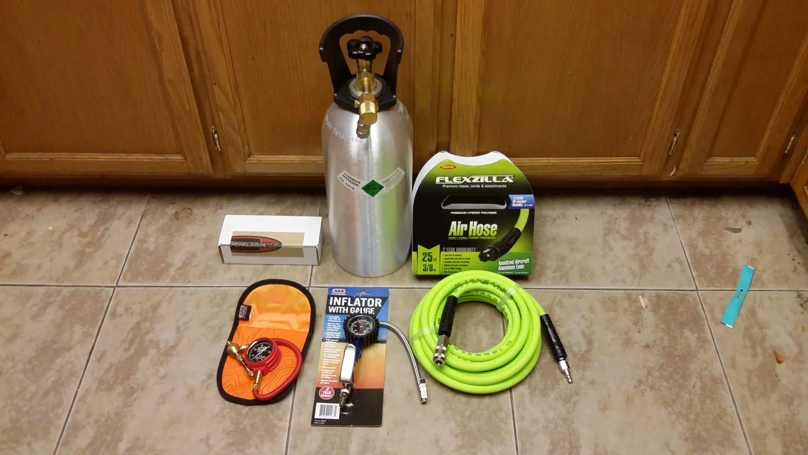

I built a co2 tank. 10 lbs, inflates a 35" tire 16 plus times. It is amazing! This is my full deflate/inflate set up. About $250 for all of it. Works very well, and one less thing to worry about needing electrical power hook up.

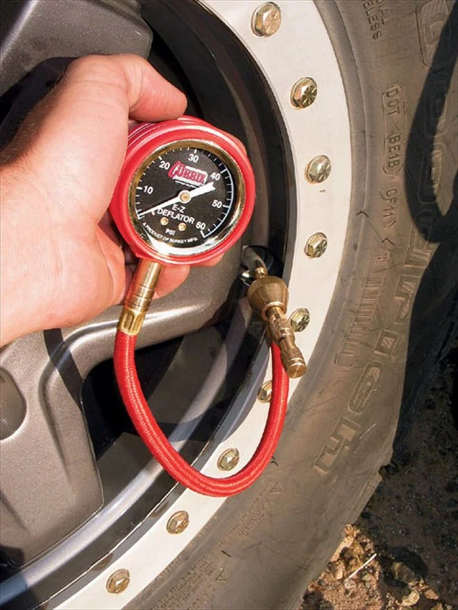

I've had multiple types of tire deflators over the past 20 years but settled on the type of deflator sold by Currie and ARB I bought 12-14 years ago. Their design is faster than most other methods as it uses a cool design that both completely removes the tire stem valve for fast deflations, as well as keeping the valve confined inside so it can't be lost.
This one...
None of the automatic tire deflators I ever used were consistent enough. They'd never get all the tires to the same pressure every time. That was even after I had a set I had owned for some time 'calibrated' by the manufacturer's rep at a 4x4 show. Not to mention they're slow since they only depress the valve stem, they don't remove it. And since these types are all dependent on a small internal spring to know when to shut the air flow off, it's not likely to keep its setting for long.
Even this "octopus" deflator rig I made many years ago that deflated all four tires at once was nothing but a PITA that for some reason that still doesn't make sense never got the tires evenly deflated either. This was slow too for the reason as the automatic deflators, it didn't remove the valve stem.
Only my Currie deflator has worked so well that I've never wanted anything else. That it's fast is icing on the cake. That people using those little screw on deflators consistently want to borrow/try my Currie deflator is pretty telling.
