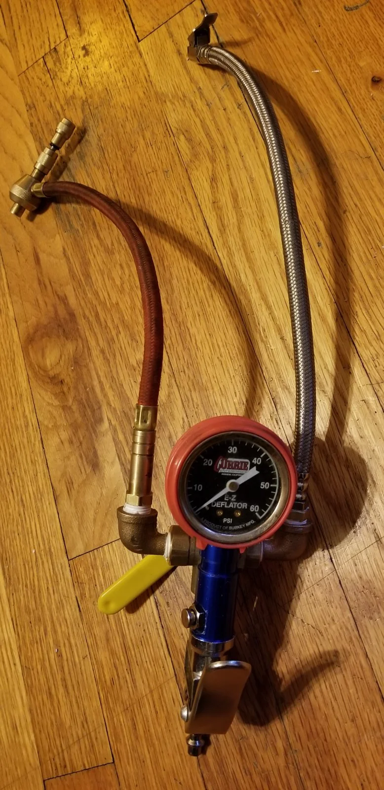

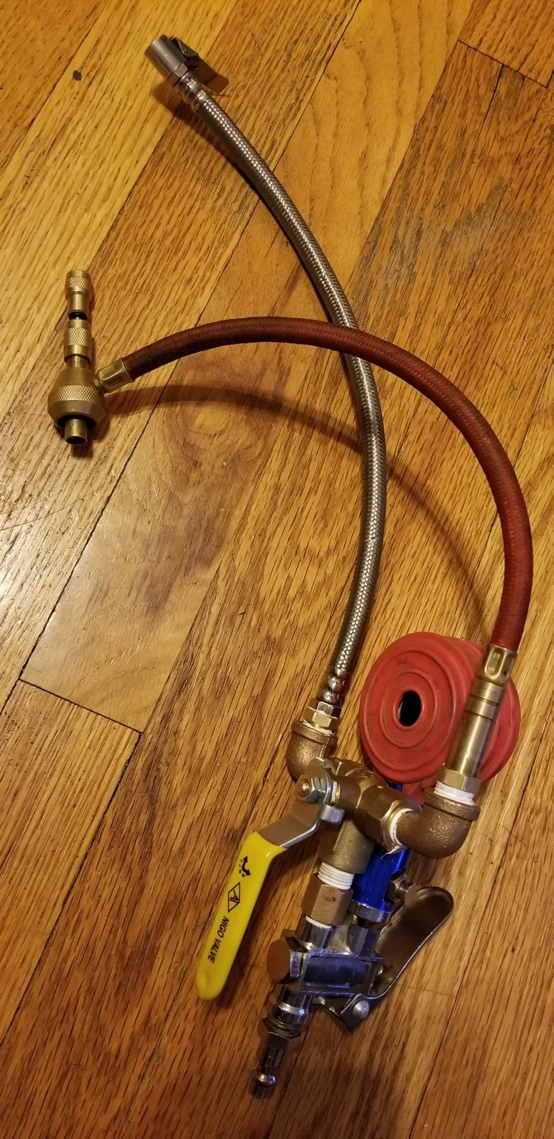

jjvw
0-60 in 18 seconds
Feb 17, 2018
5,722
Colorado, USA
Is the gauge removable? Might be worthwhile to replace it yourself, if it is. (y)
It is. Recently I made my own Frankenstein single tool inflater/deflater. I couldn't find a 40 or 50psi max gauge, so I kept the Currie 60psi.
