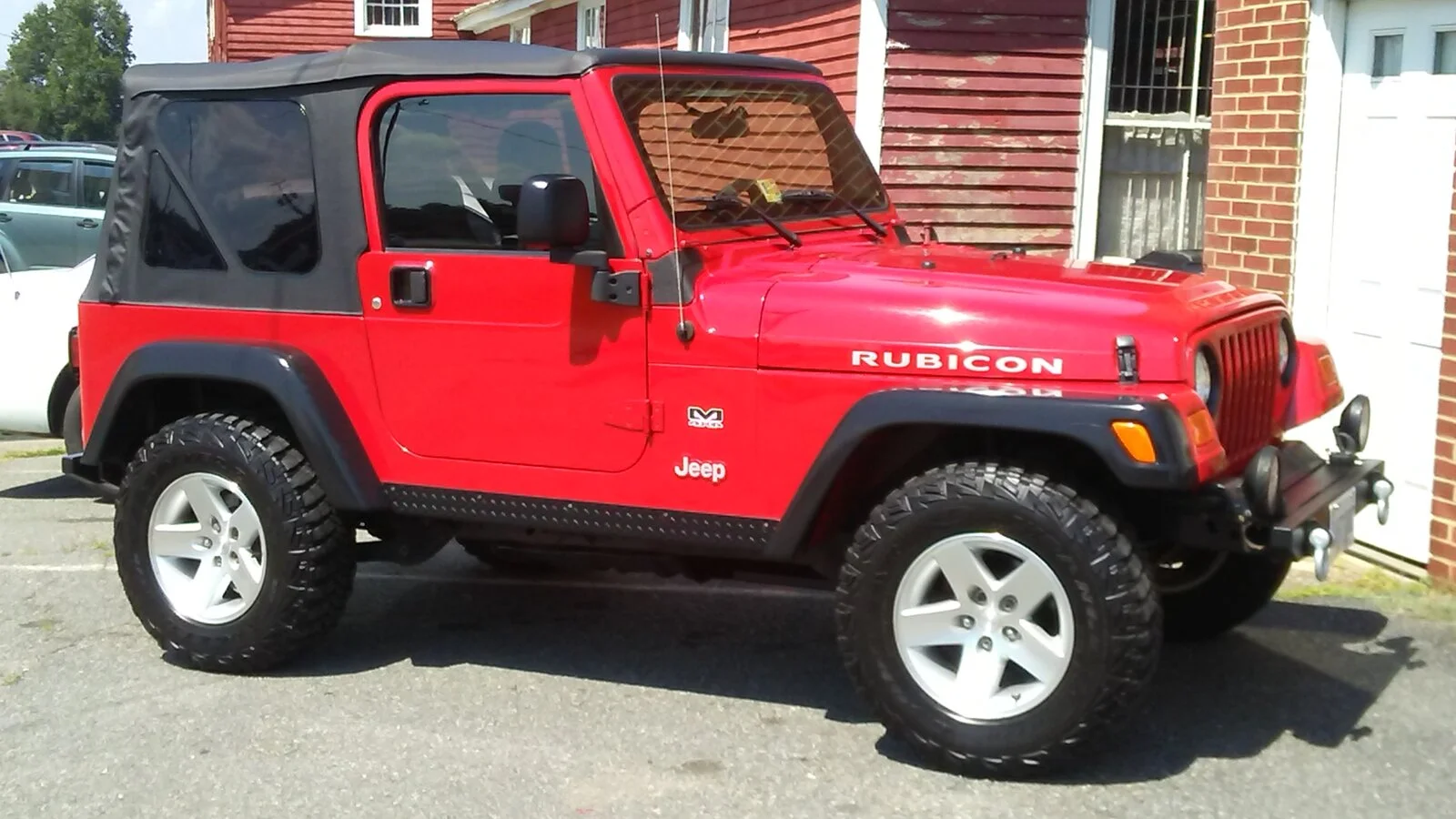

I’ve had 31x10.50 ko2’s that rubbed stock and I now have on a different Jeep 31x10.50 crappy no name brand street tires that do not rub stock. So if you can find some all season 31’s you should be good.
This falls under the category of I don't need new tires, I WANT new tires!
I you want new tires, you should want new wheels. A 15X 8 wheel with a 31 10.50 X 15 tire will fit perfectly.

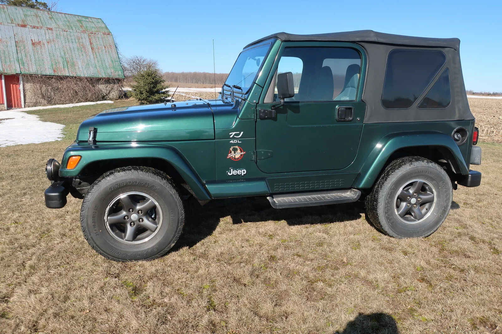

My 99 had 31 x 10.5 x 15 tires on stock rims when I bought it. They weren't aggressive tread but they rubbed on tight turns. To me, they looked way too fat.
I replaced them with 30 X 9.5 X 15 Firestone Destinations and optional "Gambler" wheels. The 30 x 9.5 tires were original equipment on '99 Saharas.
Pictures of before and after.
