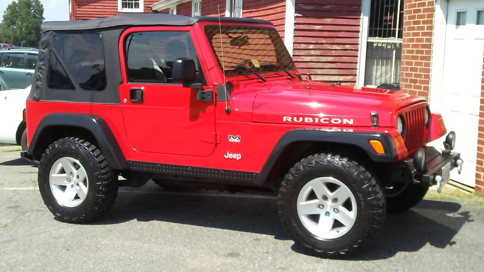

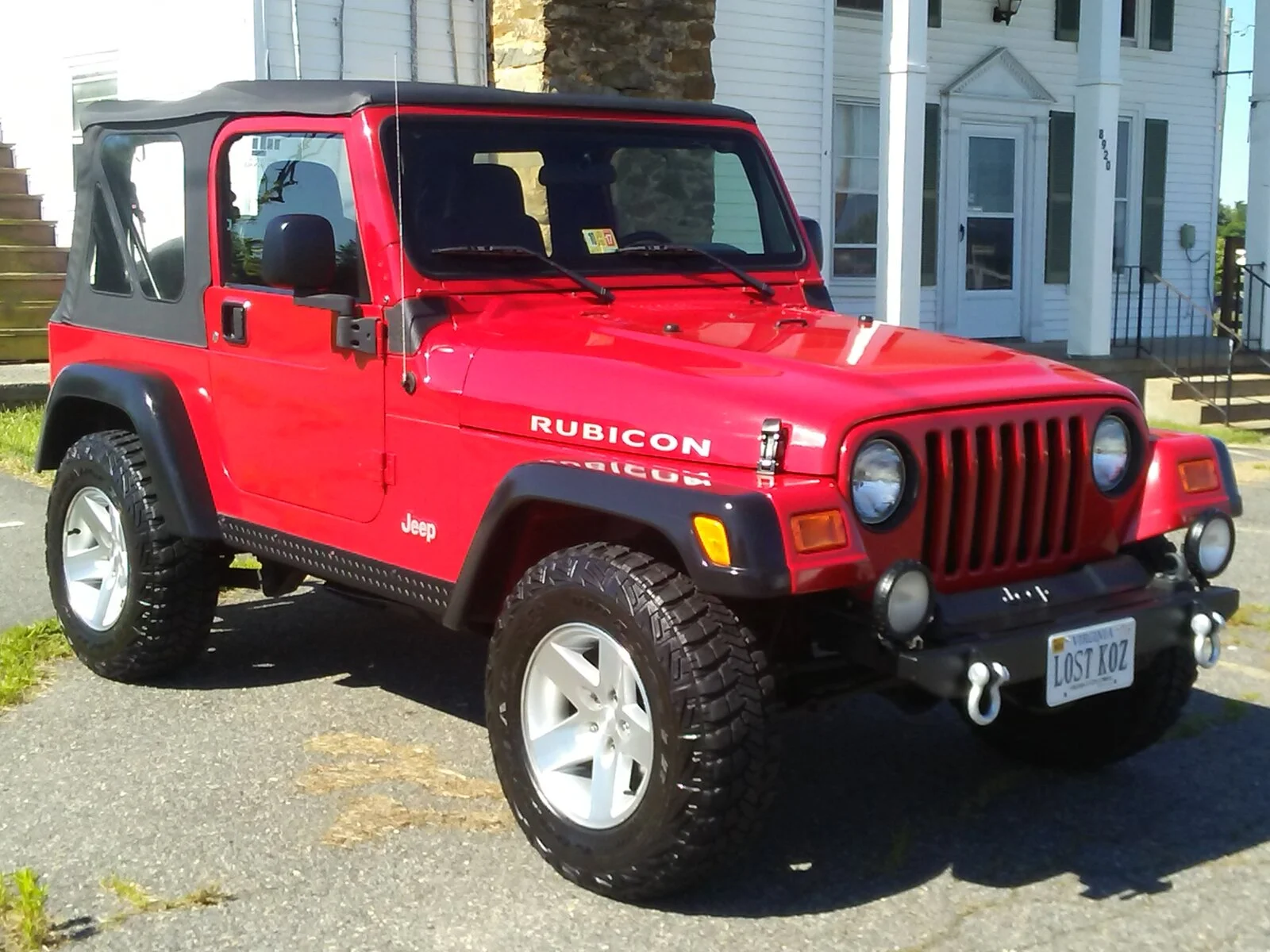

I'll agree that looks nice? That's 31x? On a stock lift? Also which tire? I'm sure you've said but I've been through too many threads to recall. Also, how much is your speedo off? Hers is currently off and 4mph with the 235s vs 30" it came factory with. Maybe there's an easy fix for that?31s are proportionate with no lift.
Technically a 31. Goodyear Wrangler MT/R LT245/75R16 (30.5"x9.6") that come on Rubicons, so the speedo was accurate.I'll agree that looks nice? That's 31x? On a stock lift? Also which tire? I'm sure you've said but I've been through too many threads to recall. Also, how much is your speedo off? Hers is currently off and 4mph with the 235s vs 30" it came factory with. Maybe there's an easy fix for that?

That looks super easy! Thanks. I know some cars aren't that easy. If i go back with a close to 30" tire, i might be spot on again. Those handle well in all weather?Technically a 31. Goodyear Wrangler MT/R LT245/75R16 (30.5"x9.6") that come on Rubicons, so the speedo was accurate.
p.s. You need the correct speedo gear to fix yours. $20-30 and 5 minutes of your time.
