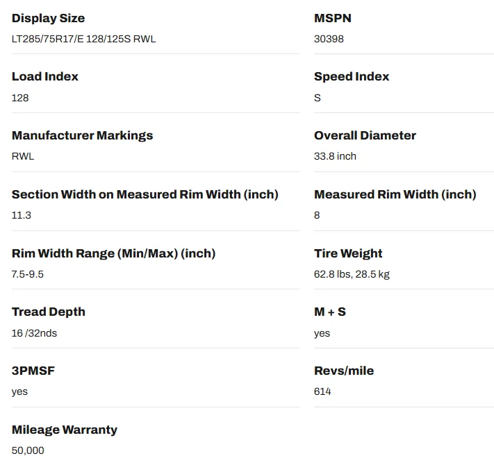

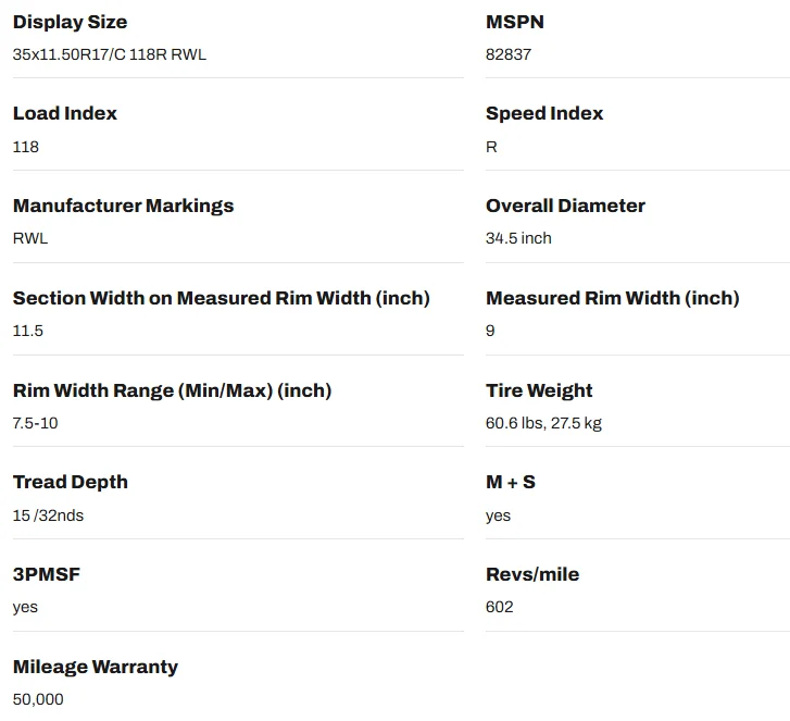

For example, in KO3s, the 285/75 is an E load, it's actually smaller, heavier, and has deeper tread. The 35x11.50 is a C load. They also have different speed ratings.

The KO3s:
