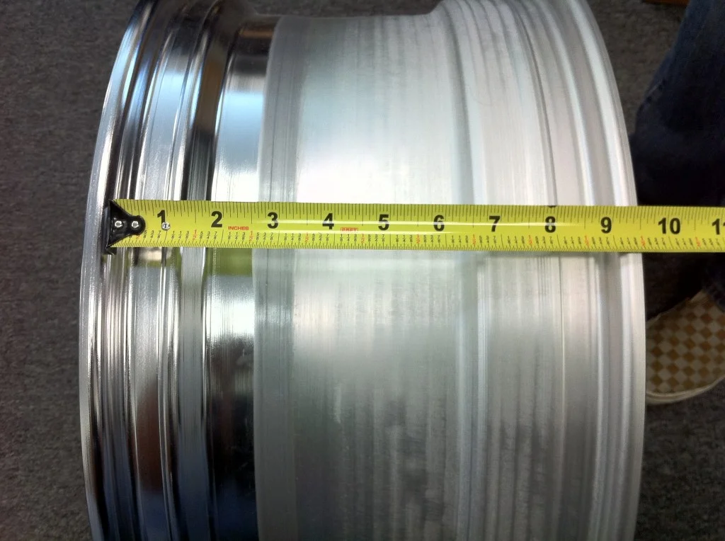

Measure the distance between the wheel rims to get width, but unless you go to 12.5 tire width, you should be fine.
