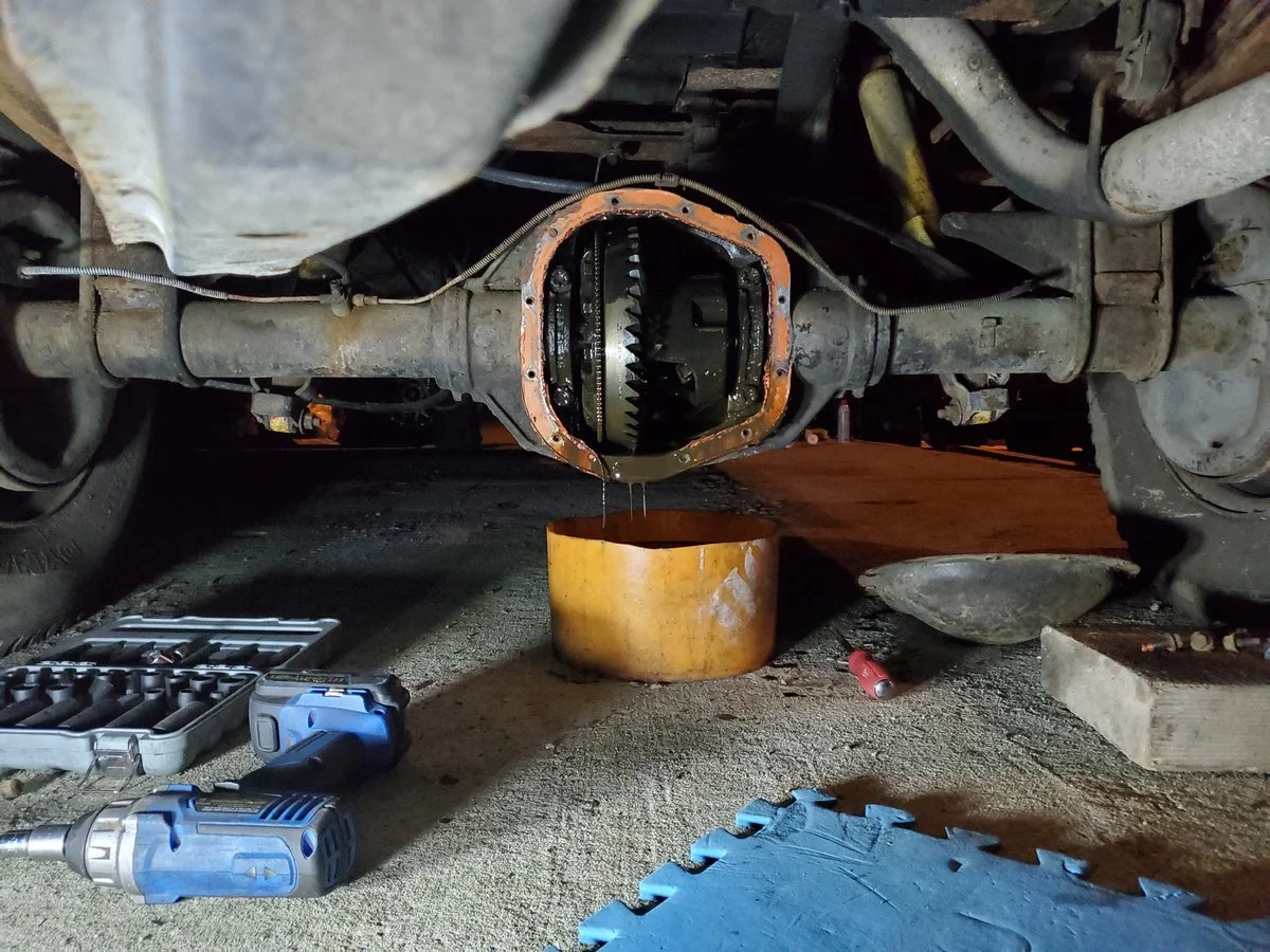

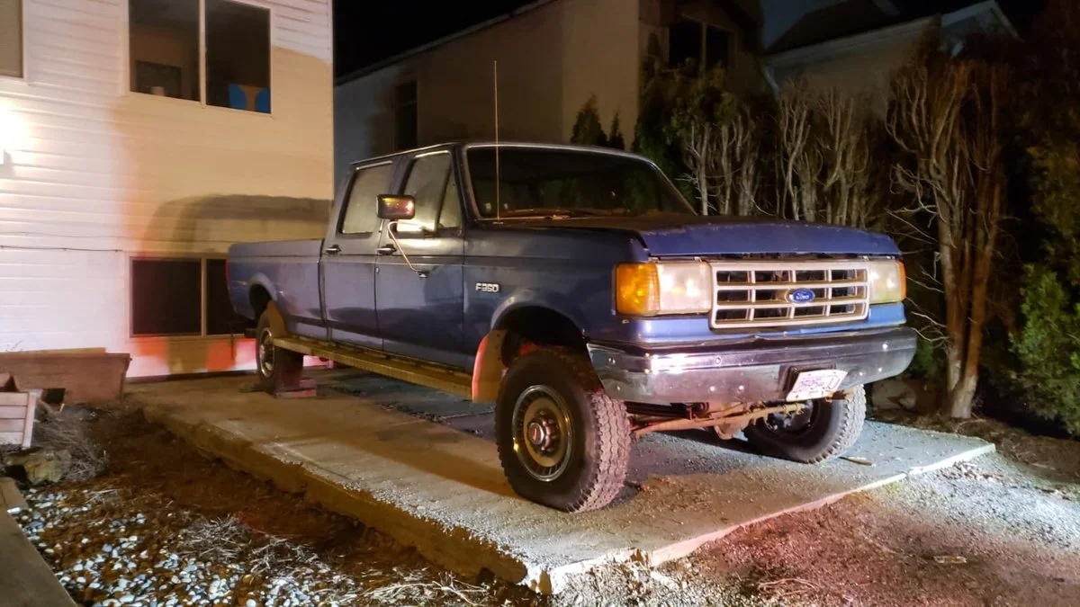

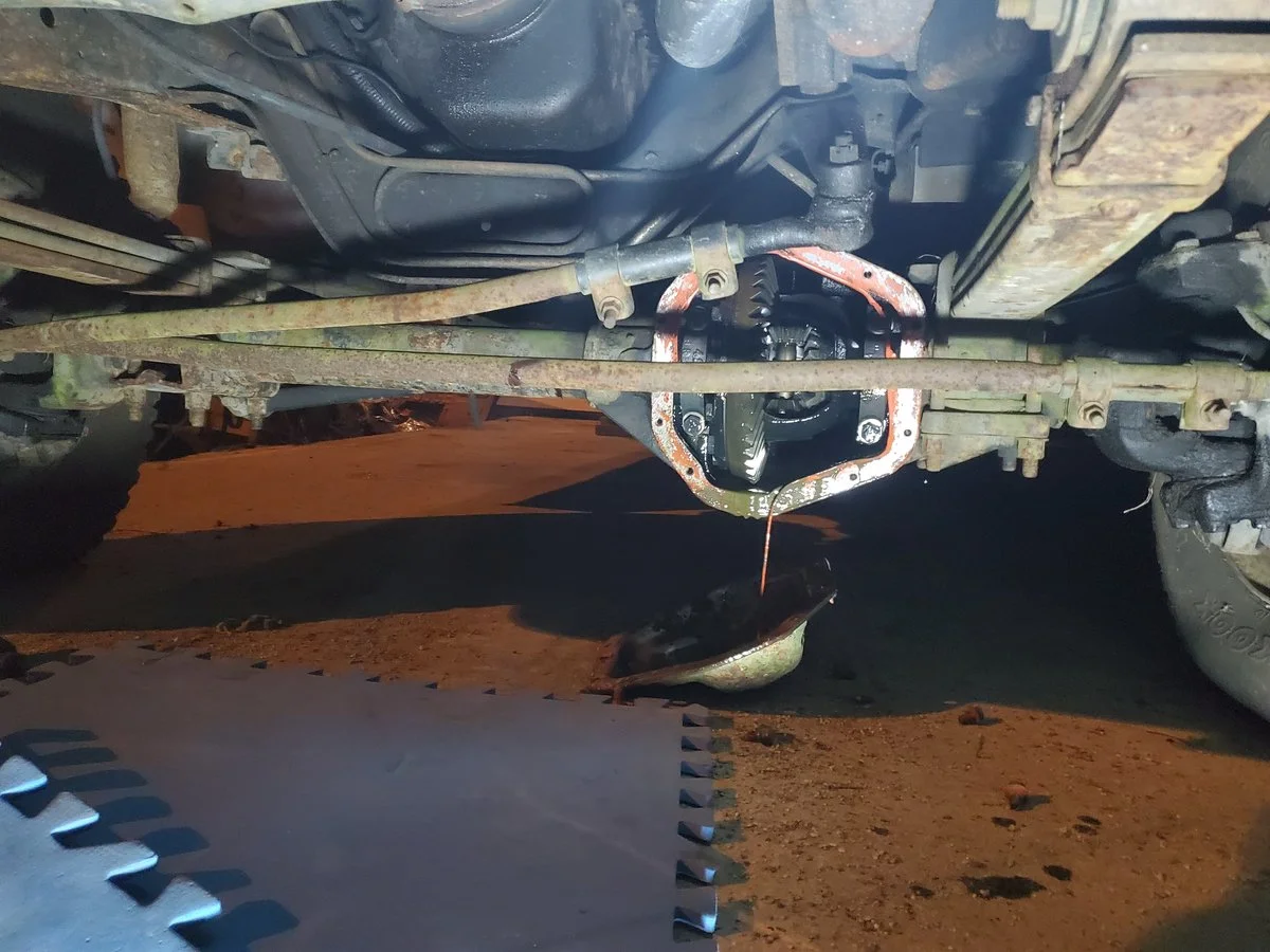

So I was at a tipping point for my Jeep LJ too. I have been running 36s on stock Rubicon lockers for 4 years. I blew up the limited slip in the rear locker last year, this year, broke a front locker (spiders) that I put in the rear.
Sooooo, it was either fix with an Eaton E locker in rear , and sell jeep OR go 1tons...
I am sure the pictures can tell you what my decision was....hahah
I plan to sell my TJ built Rubicon D44s with new Eaton in rear, my steering, (5) 36" Tires/rims, all 8 of my new TMR dbl adj CAs w/ JJs, to fund this new project.
LJ will be getting a shortened kpD60 (65.5") and 10.25 (65") w/rear disc conversion, TMR 3 link front/ 4 link rear with all new steering and 40s.
