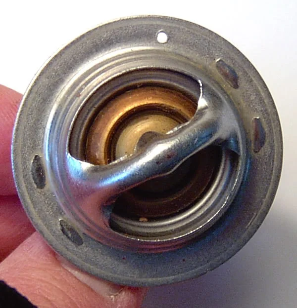

I just ordered a Koyorad A2102 based on information from Irun's research . Also a Robert Shaw 330-195 thermostat based on macLeanflood recommendation .
