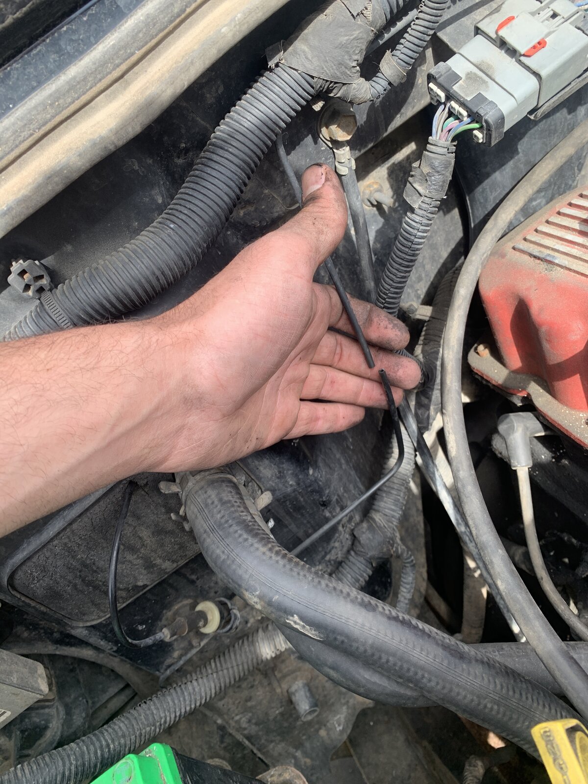

I checked my plugs. All good. I did however find this wire split in two. I have no idea what it is or does.

That is the vacuum feed for your heater controls. It is a small vacuum leak.

The vacuum leak wouldn't be enough to prevent a start. You can fix that with just a piece of rubber hose to spice it.
