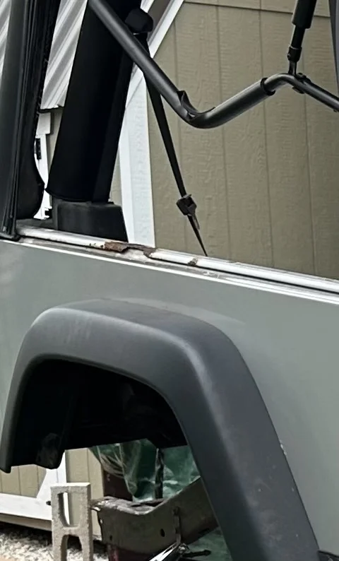

I’m looking to see if anyone has info on sourcing a replacement tub rail. My passenger side has a section rotted out of it.
I have seen one company that makes the body fill section for a TJ stretch that has it on there but never found just the rail. I have also seen that Rugged Ridge makes a plastic cap you can buy to cover it up.
I’m thinking at this point I need to find someone with a donor tub and cut it off.
Does anyone else have any other suggestions?

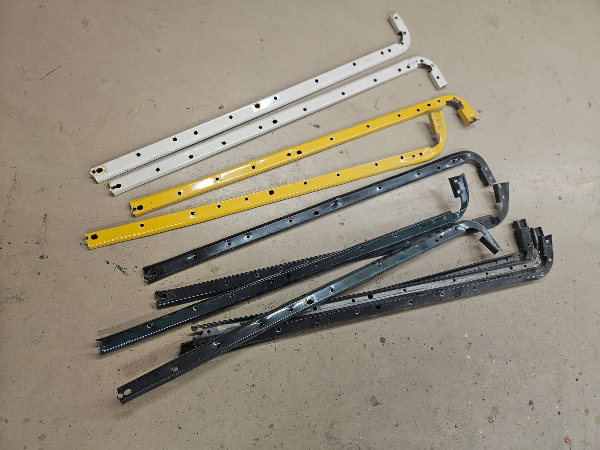

I've used a bunch for other projects and I've always gotten them at the u-pull junkyard, there are lots of TJ's there. Just bring a battery-powered drill with a spot weld cutter and they come off pretty easily. I still have a supply...

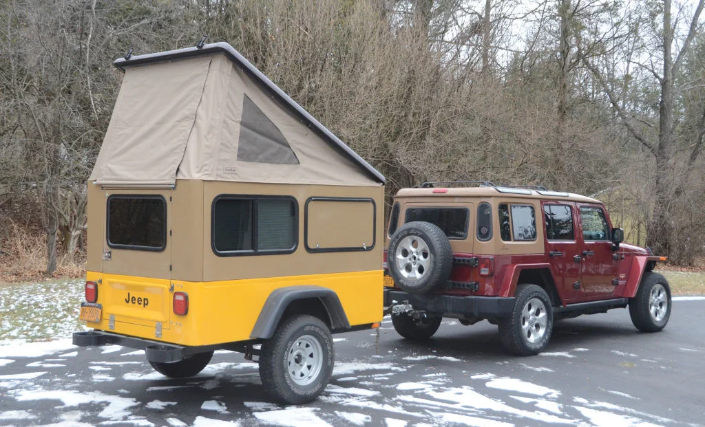

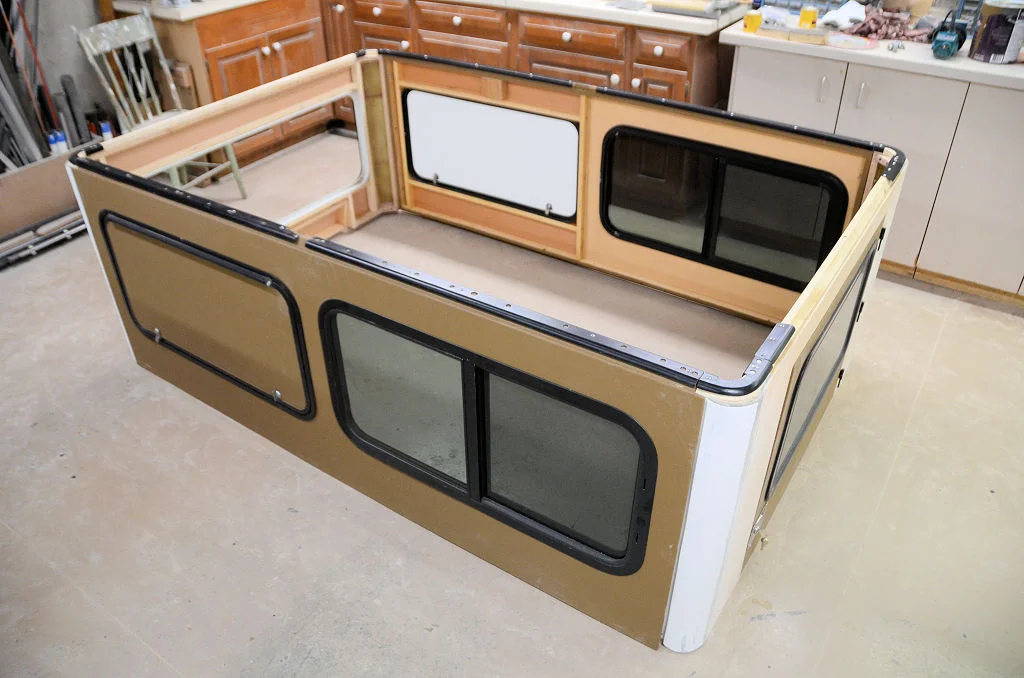

I used them when I was building the camper top for my Jeep-tub trailer, I made the top of the shell the same profile as the TJ tub and added tub rails to it:
I use them to secure the bottom of the pop-up:

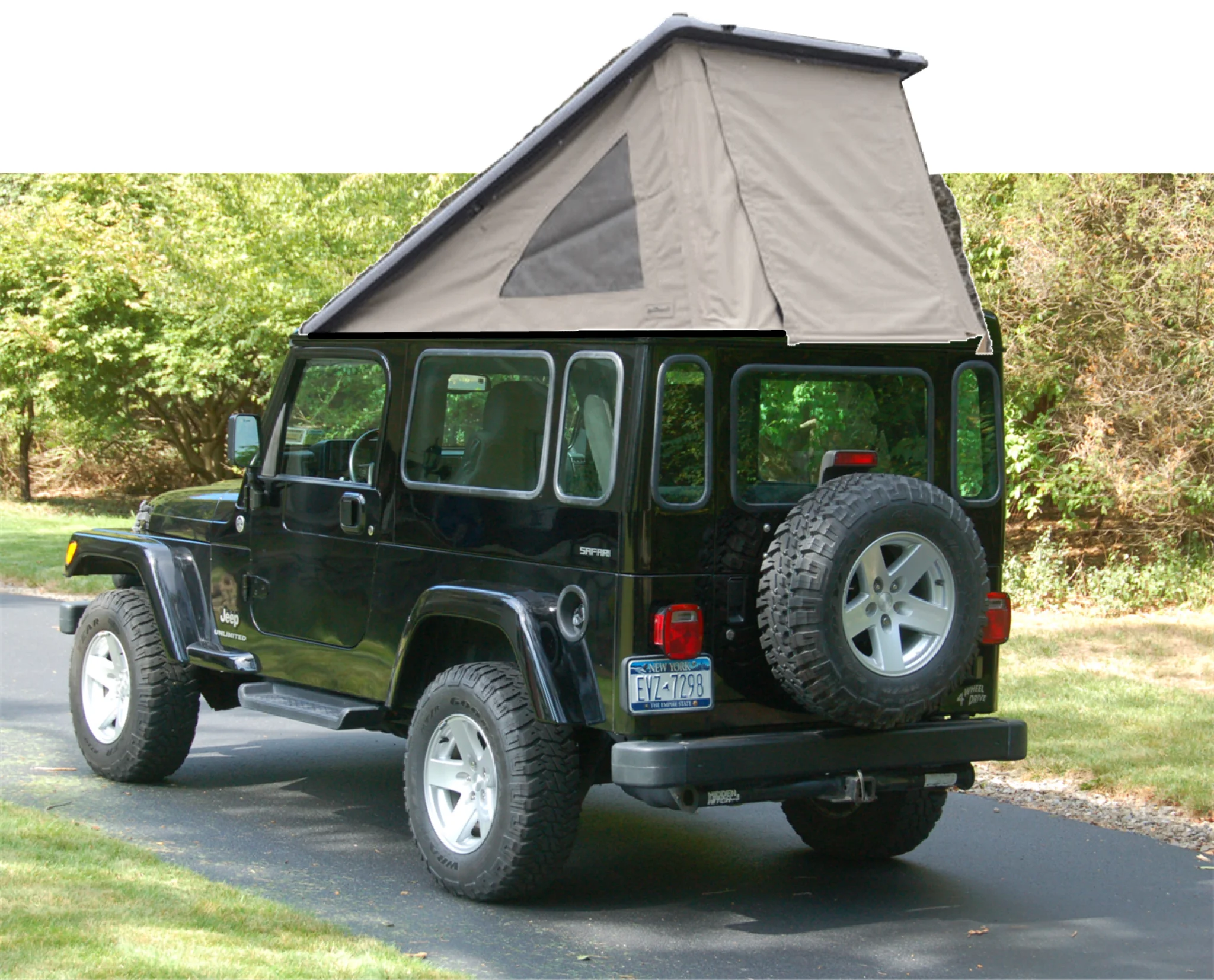

When I designed the Safari Cab hardtop for the LJ/TJ I made provisions for a pop-top camper, which would work the same way as the pop-top on the camper trailer, so I stocked up on tub rails :).
You are lucky to find wranglers in your junk yards. Any of the local ones around me never have them. Guys that specialize in Wranglers always wind up with them and sell the parts for premium money.
I did happen to find one of those guys kinda local to me that is willing to sell me them. He has a bunch of other stuff I need as well so I’ve got a small list going.
I did also see that you can still get the TJ version OEM new still and for cheap money, $20-30 per side. I was specifically looking for the LJ version.
