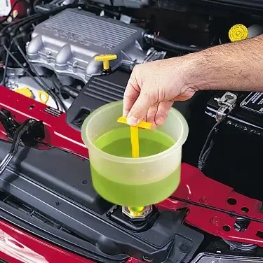

Let it run with the cap off until you see good flow, blip the throttle some, elevating the front a little helps.
I got one of these to avoid splatter and keep the rad full
Emphasis on elevating the front end to better force the air out. If you just run it on flat ground after filling you may still have some air in there.
I backed mine into the ramp for my driveway which was good enough to get my front end angled upward to burp mine after flushing my cooling system.
