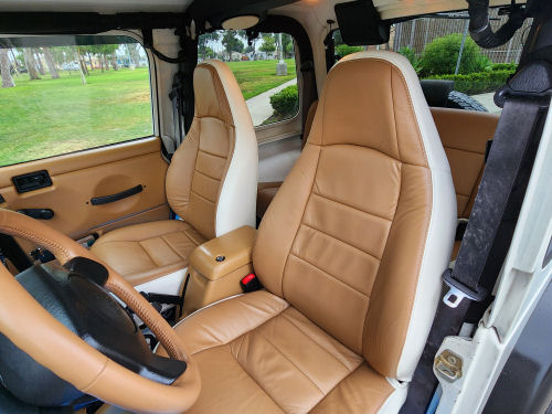

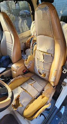

In my case, seat foam wasn't a issue. It was fairly cheap. It cost me about $120 to replace all my bad foam. It was mostly on the drivers seat and a little on the rear seat. The higher cost was to replace the material, which I went with leather. Replacing all the seats with two tone leather, including installation cost me about $1100. That is much less than the cost of a good lift. I was extremely happy with the results. The matching steering wheel was about $300. Five years ago it was only $200, but I waited until I found the proper upholstery shop to do the seats too. I eventually did my seat belt material too in white. I covered them in stain repellant. My interior is real nice now. I need to update the pictures to reflect.
After
Before
