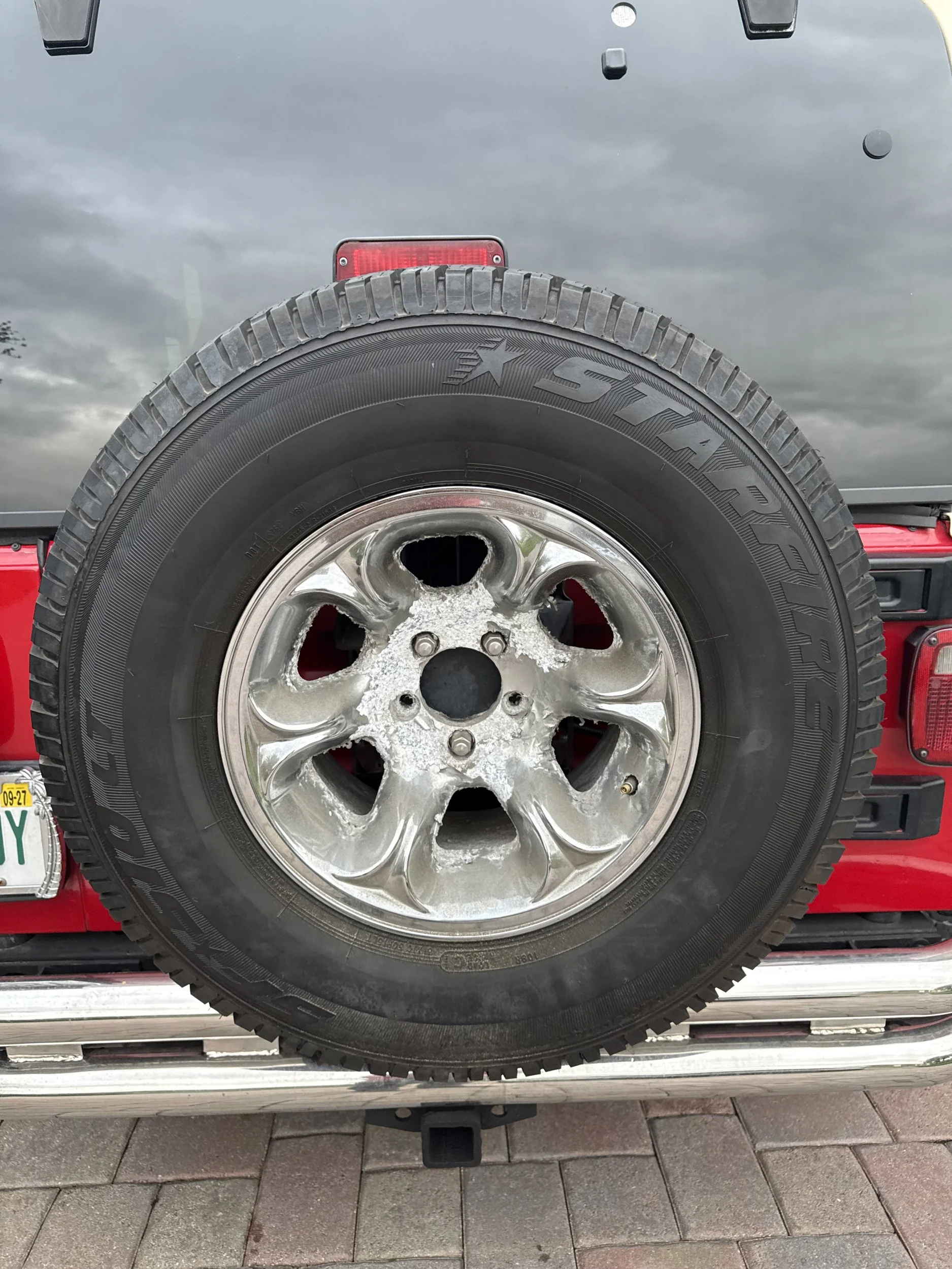

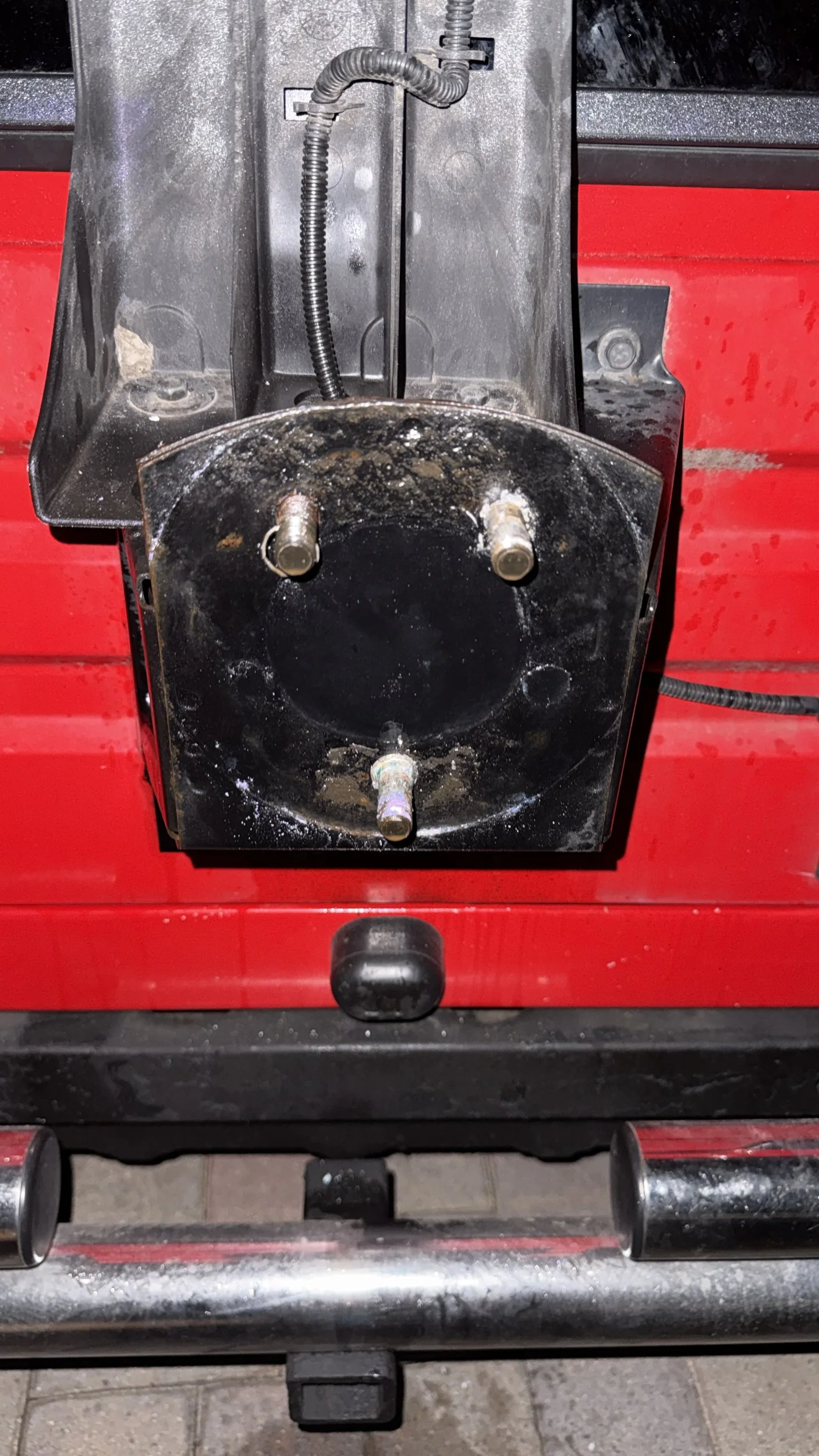

The “aftermarket” non-matching alloy wheel had fused to the rear carrier… Lugnuts came off just fine but the rear of the rim was corroded and fused.
I tried a few hits, kicks, and all that “percussive persuasion” and decided it was time to hit the Wally World for some liquid wrench. I am away from my main garage so I’m limited in tools and supplies unfortunately.
Sprayed it all down and a few kicks later the top sprung free - a few hours later and a few more blasts of the spray and the bottom finally came off when I put my foot on the bottom of the wheel and yanked from the top.

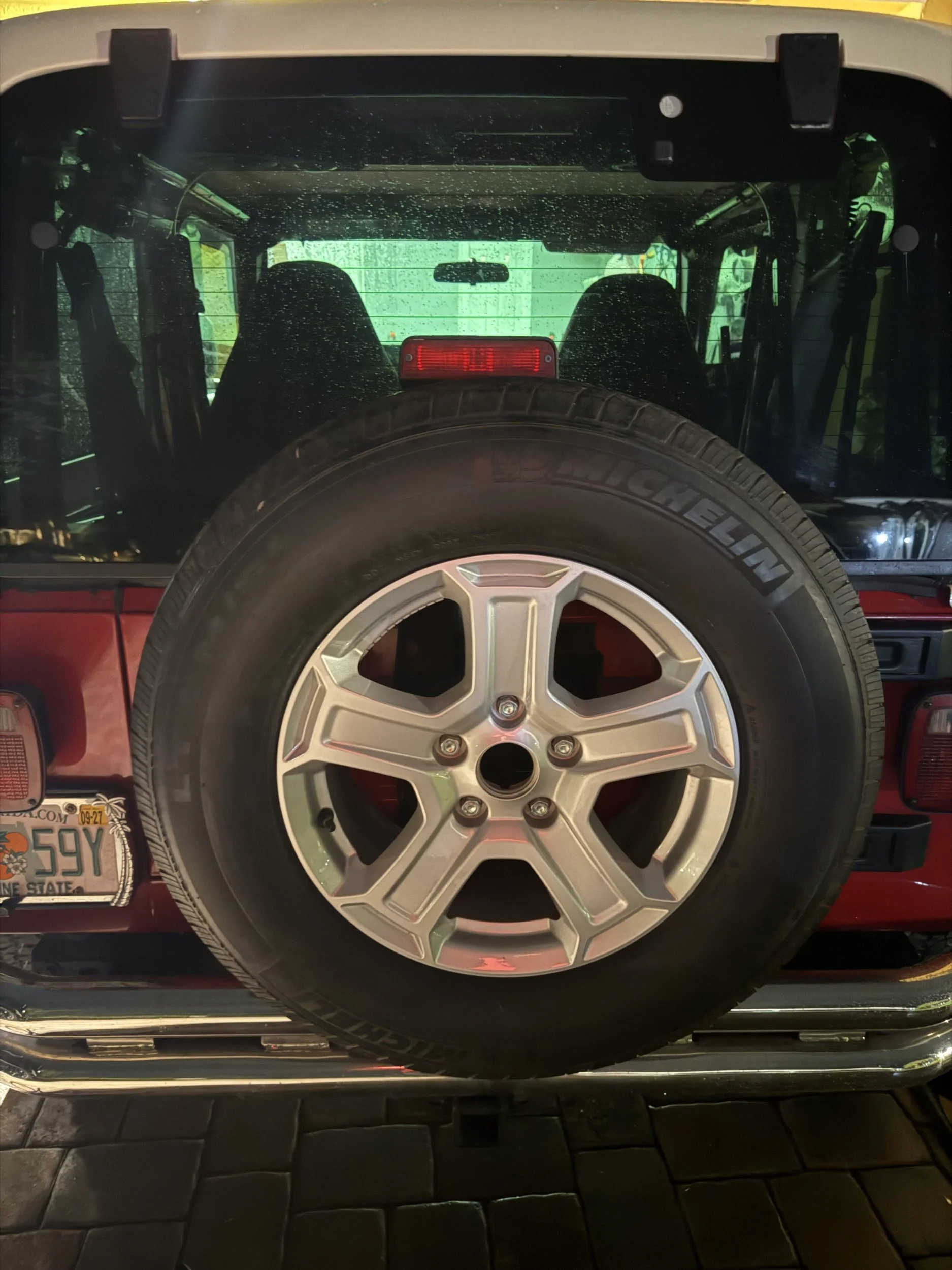

Mounted up the spare adapter and the tire to find the 3rd brake light was now obscured - should have saw that coming… I researched some solutions, hoping to just use the stock carrier as this was supposed to be relatively “cheap” but let’s see - noticing the old tire wasn’t making contact with the bump stops and was much heavier than the new wheel, so hopefully we can just adjust there and send it.

Part 2 - Woke up early and inspired - rifled through my toolbox and garage here and found a set of plastic TV mount spacers that may do the job for now. Removed the spare and brake light bracket and threaded these spacers in under the mount and behold - we had clearance.

Looks like you've already got a set of lug nuts for the spare, but just in case, there are two different threads available in 5x5, JK 1/2"-20 and JL M14x1.5. Both will work with the wheels, but, of course, you'll need the set matching your adapters for them to thread on.
All of the TJ and JK are 1/2" 20. You can use the standard 19mm hex 1/2-20 lug nuts with JL wheels but if it makes you nervous, you can get some 1/2-20 21mm hex lugs that have a little larger cone to them

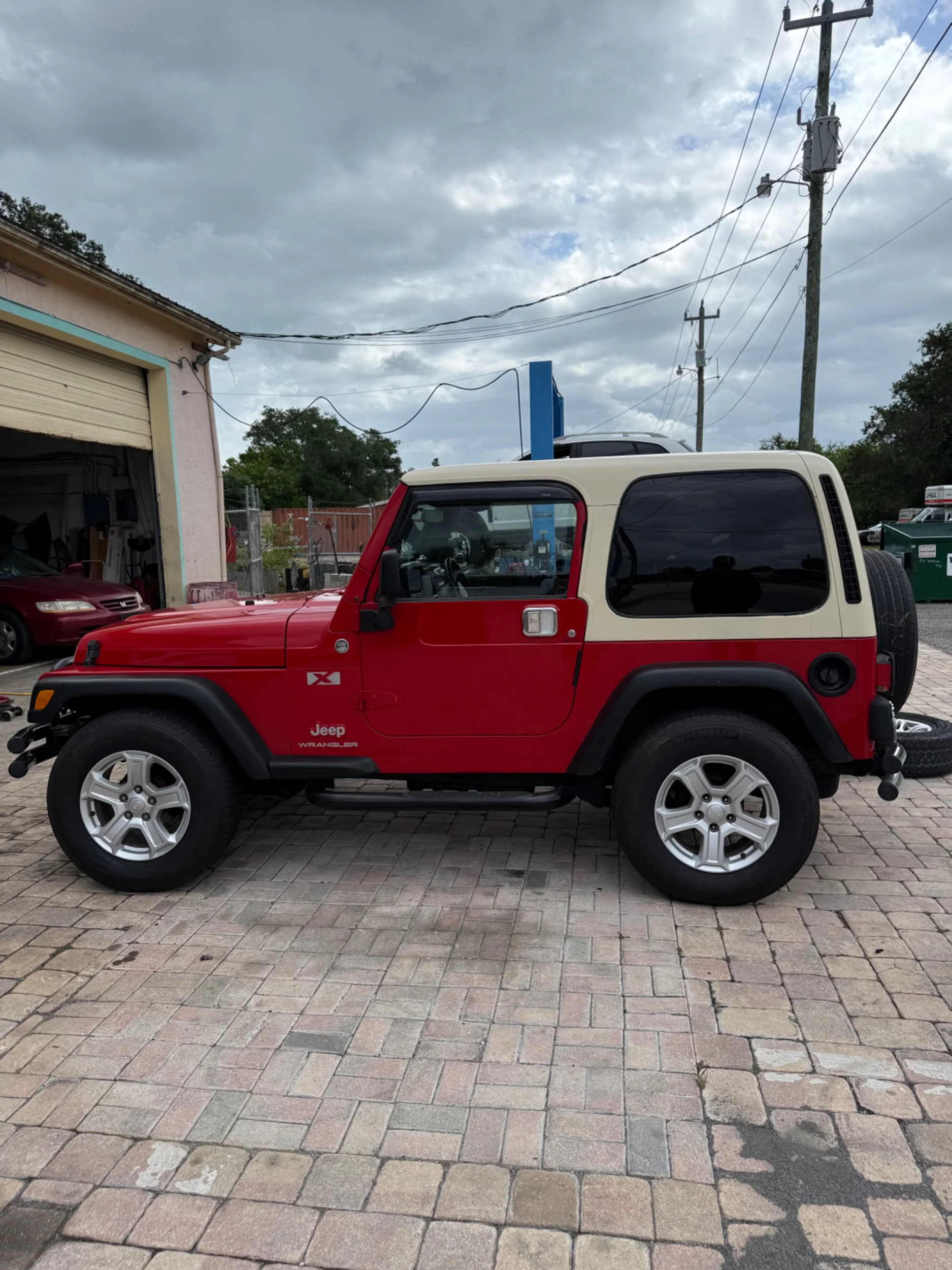

Part 3 - Well, not much more to report. The install of the remaining wheels went surprisingly well. The synergy manufacturing adaptors came with open ended lugnuts to attach to the hub and I opted to get a fresh set of lugnuts to mount to the tires to them. $160 out the door for the lugs nuts / labor / balancing / mounting.
I looked around my garage and found a set of plastic wall-mount tv spacers and installed those (for now) to lift the third brake light up out of the way. Quick / easy / cheap option.
All in we paid $200 for the wheels and tires, $300 for the adapters, and $160 for the install. $660 total.
Not terrible especially compared to the price of new tires today - and the new wheels really modernize the look of the Jeep. Would happily do it again.
