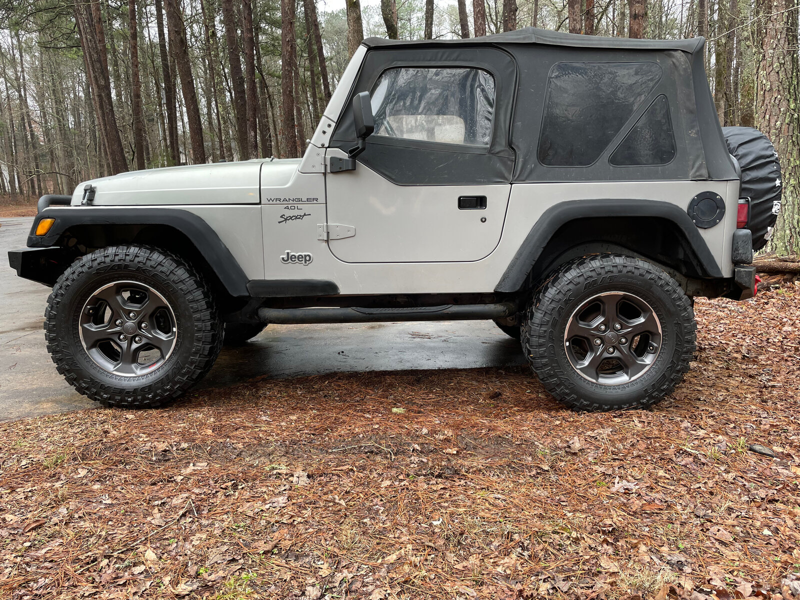

I had gotten the kit at DPG Off-road which comes with a 2.5 inch old man emu suspension lift and a JKS 1.25 inch body lift for a total of 3.75 inches of lift. At the time I was doing my research this setup came highly recommended. At the same time I bought the wheels and tires I also did a regear to 4:10’s and a Super Dana 35 Kit with e-locker in the rear and just a carrier change for the regear in the front axle. I love the setup and have no regrets except the gas mileage that I lost. I use this as a part time daily driver and with gas prices where there at it’s not any fun at the gas pump. I will eventually put a locker in the front axle along with changing out the axle shafts with something a little stronger. I’m completely satisfied with how it all turned out and you will be too if you go with this size lift and wheel combo.
Thanks for the reply! Looks great! When you did the body lift, did you do the engine lift with it as well? Did it affect your shifting or transfer case?
Thanks
Yes the DPG kit came with a JKS 1" motor mount extension and I upgraded to the brown dog motor mount for an extra $75.00. I don't think from what I read that I would have done the body lift without the motor mount extension. After install I had no problems with the transfer case hitting the skid plate or shifting.

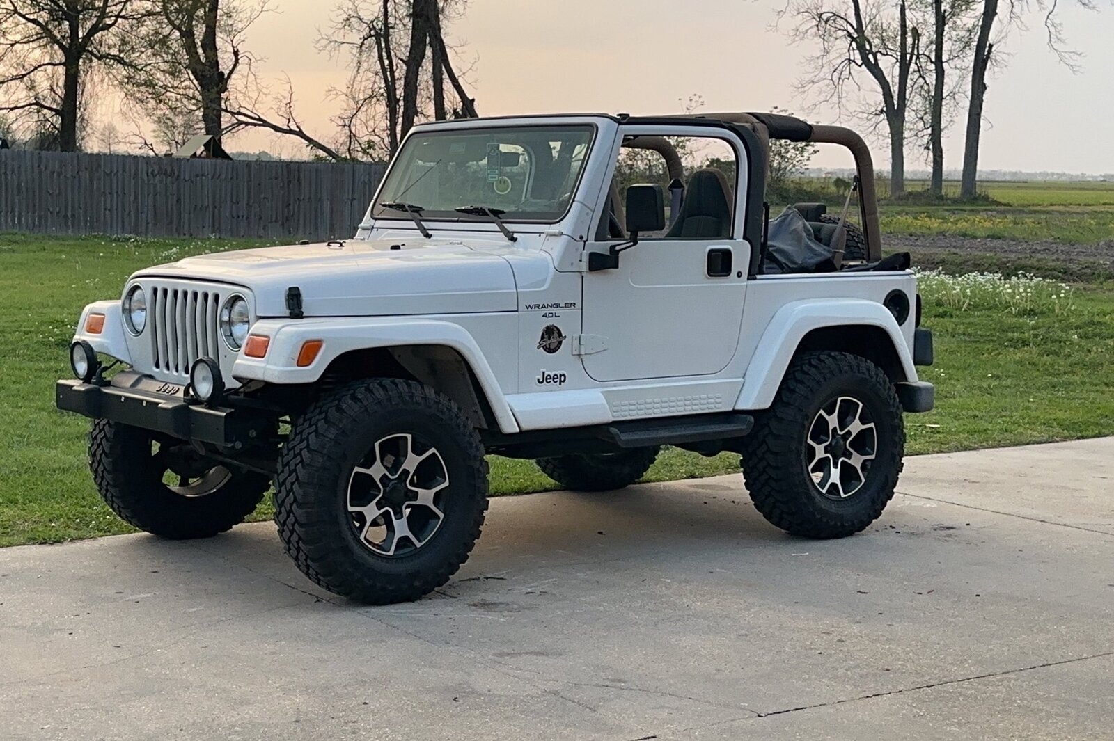

I ended up ordering these and they should be delivered today:
https://lugnutguys.com/products/whe...x4-5-to-5x5-jl-wheels-1-25-thick-14x1-5-studs
They claim to come with the JL-appropriate 14x1.5 studs and were $105 for 4. We'll see... I assume Chinese manufacturing. They make a 1.5" thick adapter/spacer too but they're out of stock and, based on my measurements, I preferred the 1.25" thick adapters. I'm hoping I don't need to replace the rear axle studs with longer ones. They currently have only 1" of exposed threads... obviously sufficient for factory rims but I have no idea how thick the lug nut recesses will be on the adapters. I used to run 33x10.50 BFG MTs on the old "Grizzly" wagon wheels on my 1998 and I just had to put a couple of washers on the steering stops so the tire lugs didn't clip the control arms.

These adapters appear to be pretty nice. They did have the proper hole size for the 1/2-20 TJ studs and also the proper M14 studs for the JL wheels. I've got the fronts on but the factory rear TJ studs were too short with only about an inch of protrusion. I wasn't getting enough thread engagement. I purchased new studs that I'll put on tonight and hopefully be done with this.

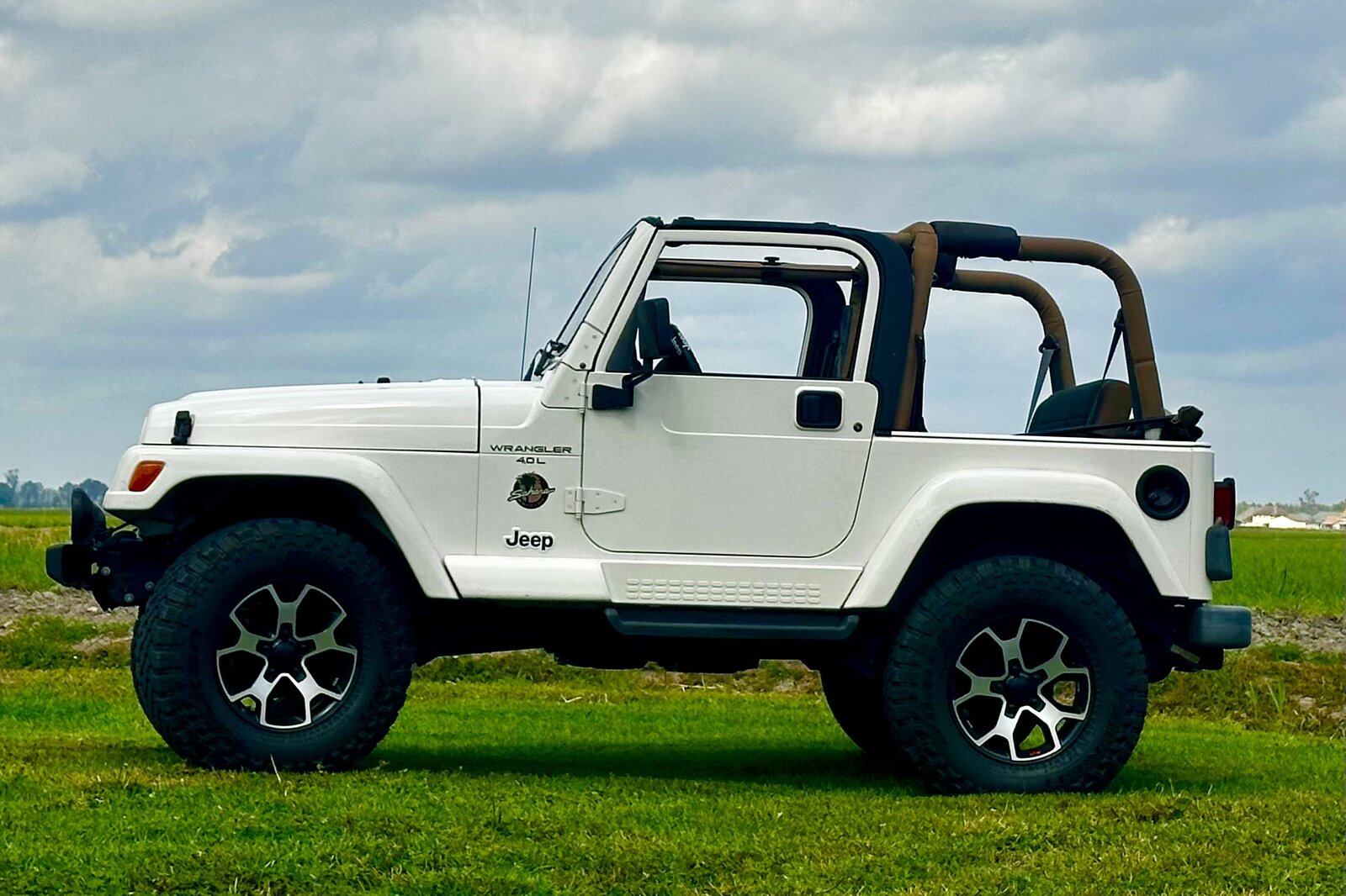

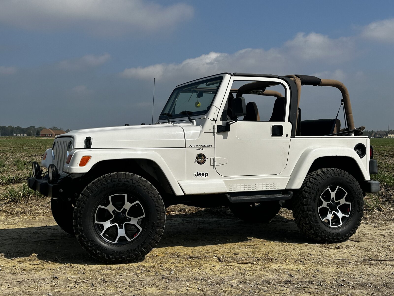

I guess I never posted my JL wheels results on this thread. Lug Nut Guys 1.25” thick adapters and they now have 7/8” M14x1.5 black lug nuts on there. 2.5” suspension lift (Some rough country, some Rancho parts), had to add a couple of washers to each steering stop so they wouldn’t buzz the front lower control arms at full lock. 285/70r17 Falken Wild Peak on what I think are stock JL Rubicon wheels.
