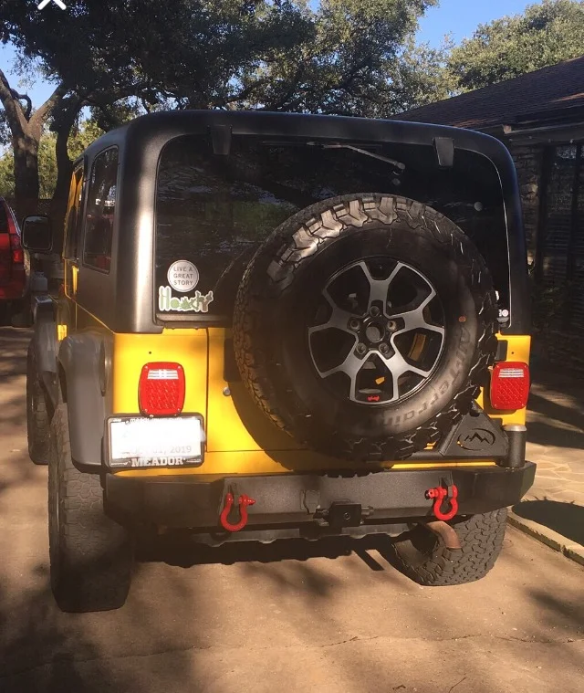

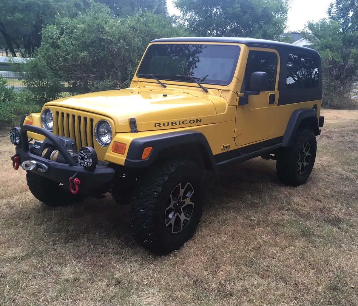

I need to take a better picture, but absolutely love the JL Rubicon wheels on the LJ. No rubbing issues. Have about 4.5" total lift between the lift kit and the body lift. 1.5" adapters.
The spare wheel/tire dwarfs the rear of the Jeep. Hard to believe it's actually riding around on four of them.

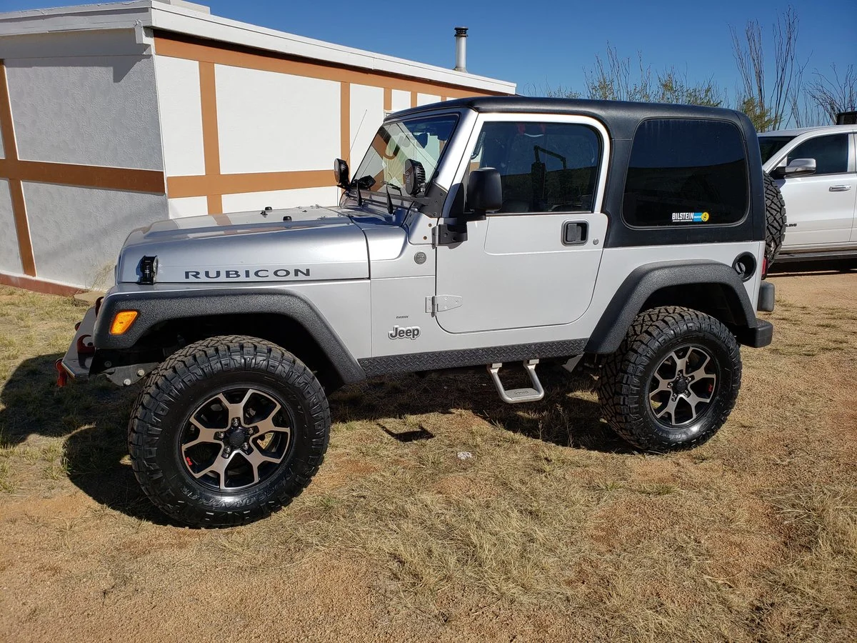

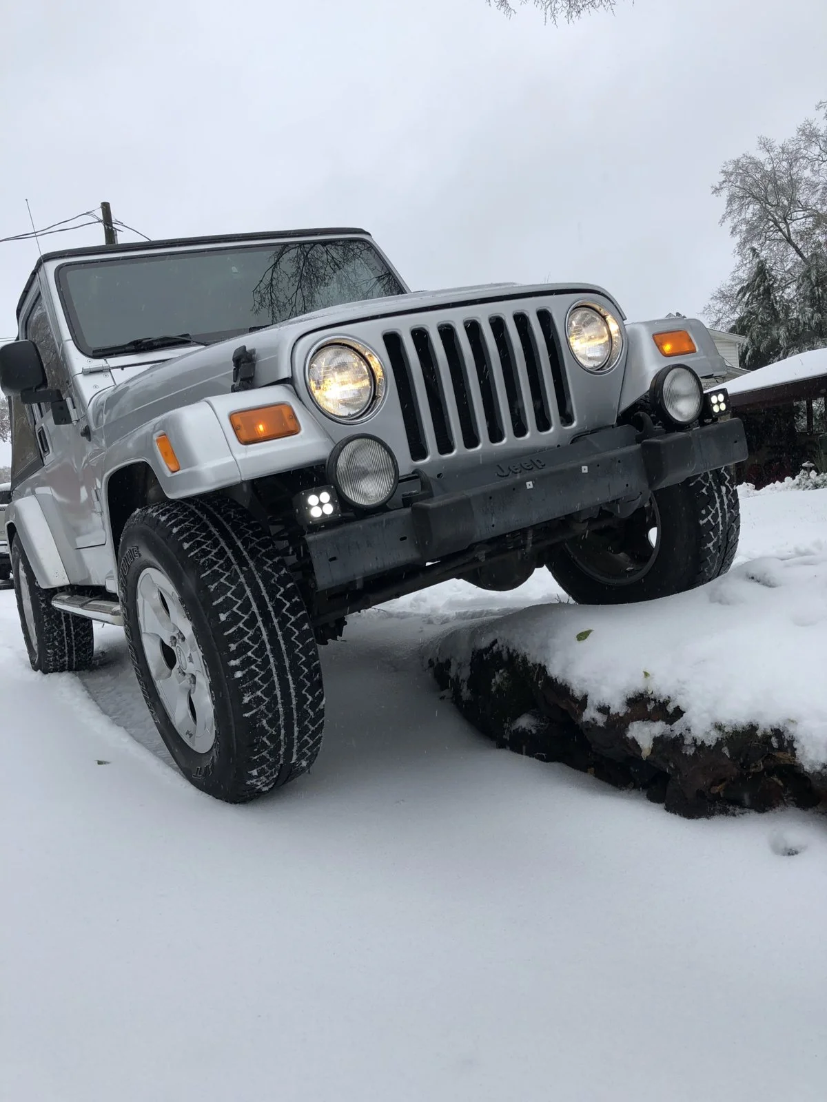

Got the 2" bds springs on today. Used a 1/2" OME spacer up front for just a tad more. Also got a 1/2" body lift but I may just leave it how it is. Barely any vibes at all, I was wondering if adding a little more to the front would help the rear DS angle. This is much better than my last 2 TJ's with 2" BDS springs. LOVE the way it drives now, god those E rated tires were so bad, these are like clouds. 33's are perfect for the Rubicon gearing too. I don't think she's bad looking either!
