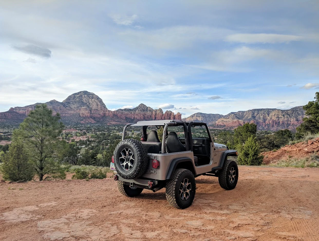

Here's mine
For the spare tire, I'm using the factory tailgate mount, with a 1.25" adapter I got from Amazon. The spare just touches the rear bumper but doesn't really interfere, but as you can see, I have a low profile bumper/hitch that I made. Its little details like that you forget about and why I was hesitant to say "yes, they fit" in a previous post. It's easy to forget about some modifications you made a long time ago, lol. The tires do rub the control arms in the front, but not bad enough for me to stress over and no worse than before with my old 33x12.50R15's and 3.75" of backspacing.
yeah I noticed you had a different rear bumper. It's interesting that your 33x12.5 R15 with the 3.75" backspacing rubbed on the control arms because I have the same exact set up on mine right now and I have 2" of clearance between my tire and my control arms at full lock. Maybe my steering stop bolt is set differently.

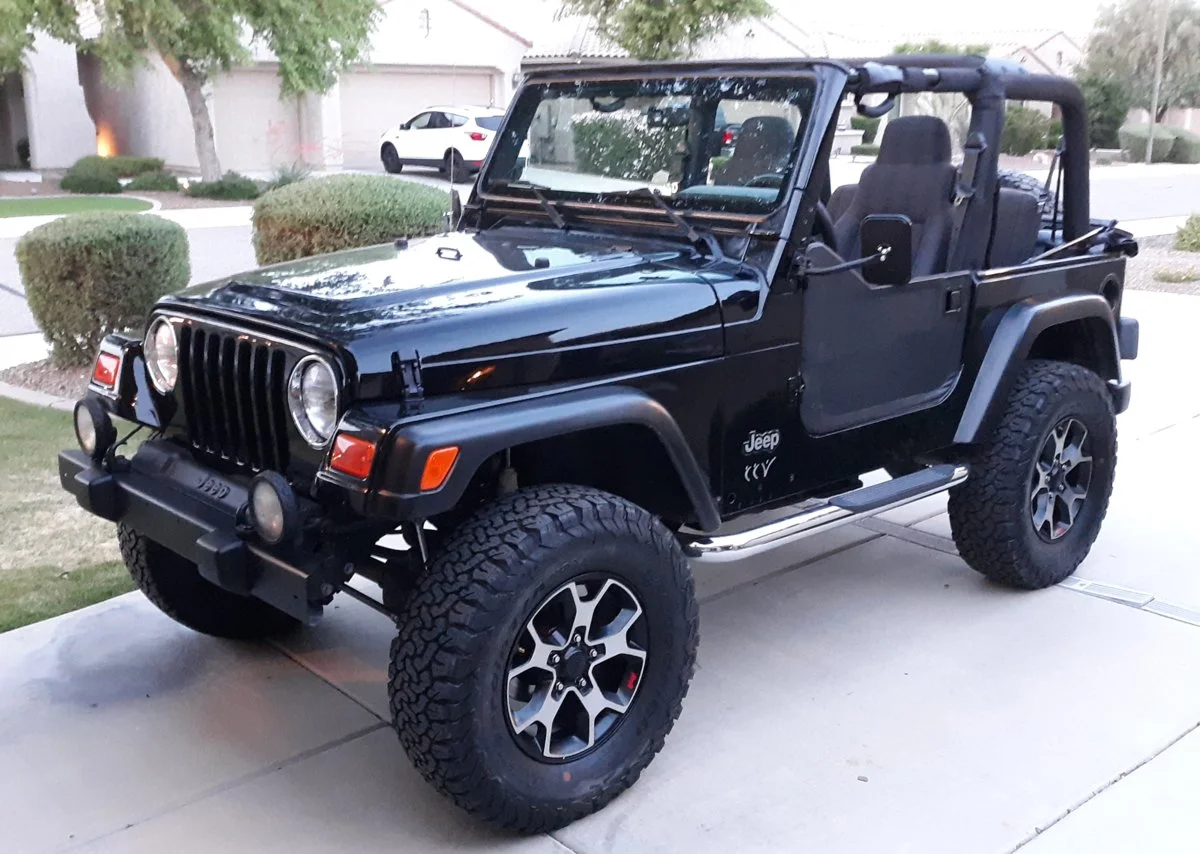

Here's a look at mine with 1.5" adapters. These tires make the Jeep feel like brand new. It's a night a day difference from the 33x12.5r15s that I was running. I don't have any rubbing with the 1.5" spacers, in fact I have a good 3/4" of clearance between my control arm and my tire at full lock.

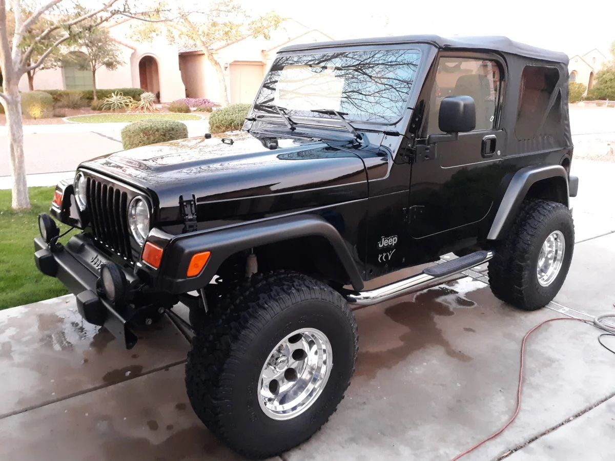

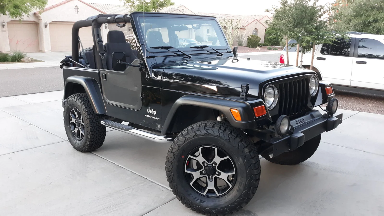

Thanks! I have a 3" Zone lift and 3/4" spring spacers up front . I'm very happy with the ride. It rides smooth and tracts down the road much better now and the scrub radius feels proper. But I do miss the wide stance that my old wheels and tires had. Here's a look at the before and after photo.

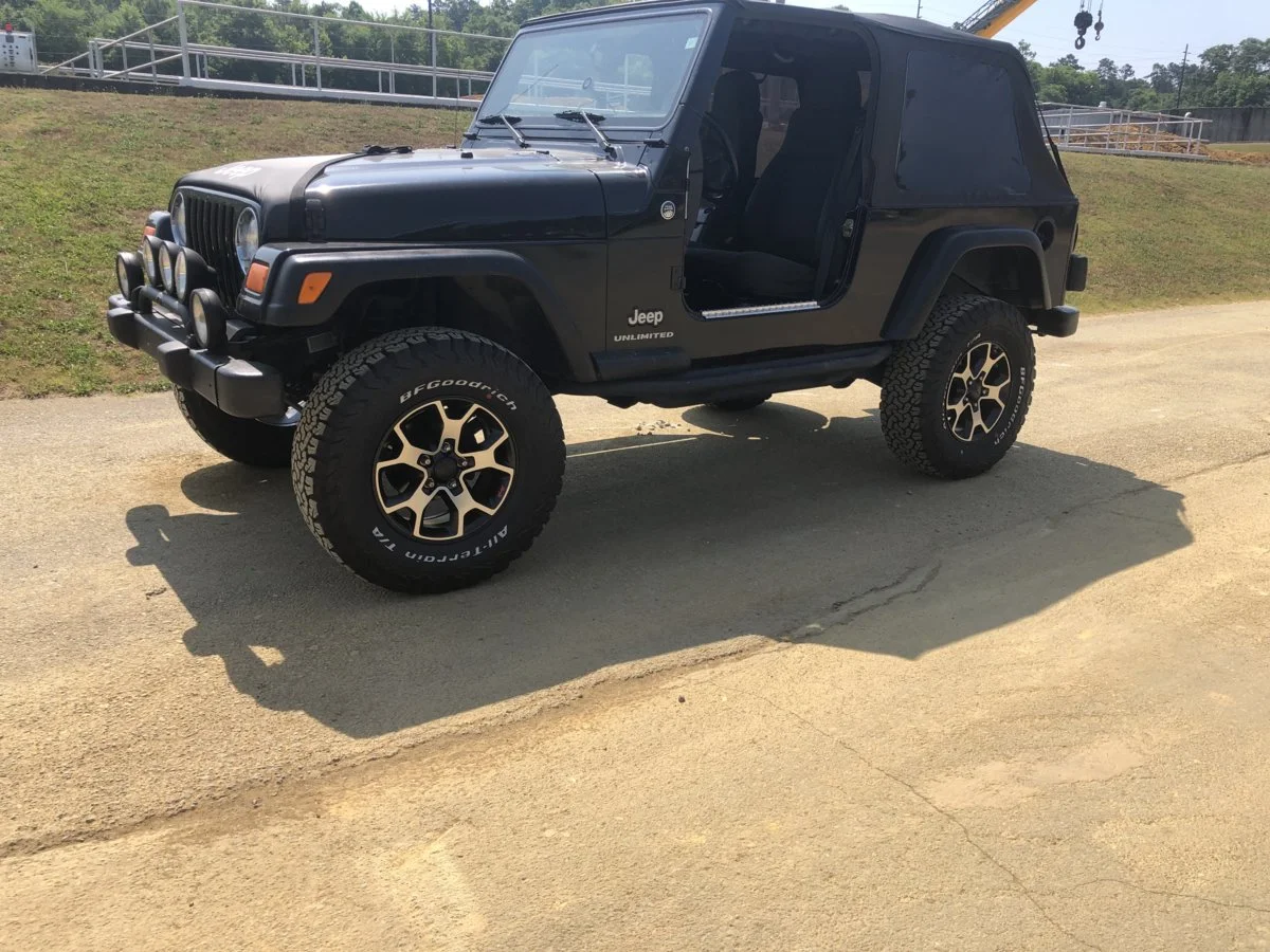

I love the ride but with the new tires and love the look of the new wheels. 35” tires would look better but not looking to do the work necessary. The 1-1/4” spacers worked great and I have no scrubbing at all.
Overall I happy with the switch. Now just waiting on the 5th spacer to install the spare.(Slipped my mind when order the first 4)
