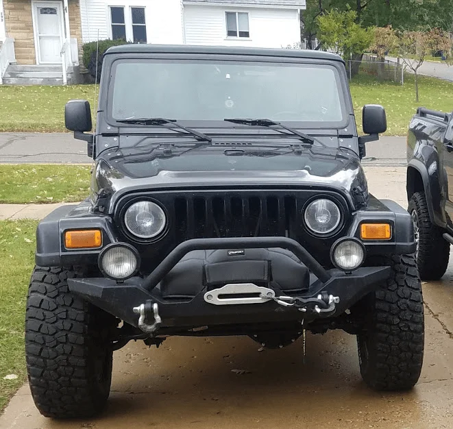

I'm having stock JK rims and tires put on wednesday. And I bought 2" adapters so they would clear and not rub. My tires now (31's) rub alot. And I'm tired of not having my turn radius. And rubbing on my suspension. I was worried I'd gotten to big of an adapter. But your the 3rd or 4th post stating that 255's rub with a 1.25' adapter. Hopefully that extra .75" will clear. And not have my tires sticking out to wide. They are 255/70/17's IIRC. I guess I can have a couple washers put in my stops. But would like to not have to do that and loose some of my turning radius.
Anyone got a guess on how far the tires will stick out on a stock '99 TJ with standard flares - using a 2' adapter?
OP those wheels and tires look great! Either way you go - adapters or more lift - I'd go for it. Rubbing is a PITA. I hate guessing how close I can take a turn. And I think mine are rubbing on the side of my shock too. Luckily my tires now have big knobs on the outside edge. So they are taking the brunt of the rubbing. My new JK tires are just radials - not off road tires really. Without alot of rubber on the outside edge. Will probably rub the not so thick sidewalls of a stock JK tire. SO I want to make sure they don't.

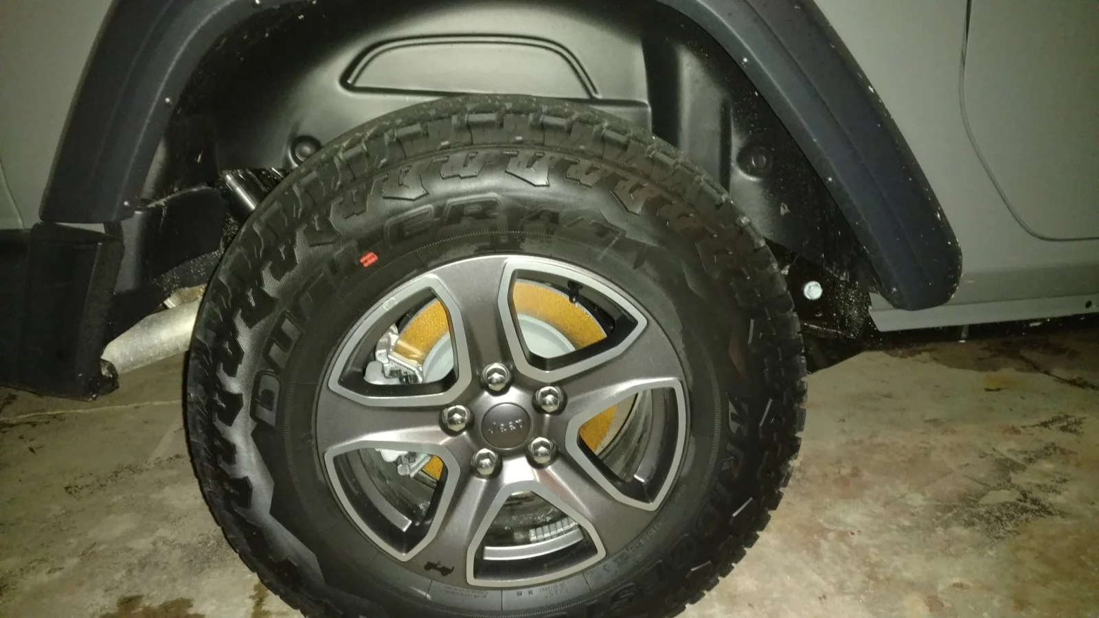

Threads. Big fan of the new JL Rubicon wheel. I think it's the nicest looking wheel Jeep has designed.

I've also been reading the lugs on the JL's are larger than the JK. Keep that in mind as you're shopping for adapters.

And are you running JK or JL wheels? I have stock JL's from my 2018 Sport-S that I'm planning on using, and someone said something about JL lugs being larger so still want to make sure they fit. Do your tires stick out at any with the 1.25" adapter? I have stock suspension with 2" budget boost and running 32"s currently with only a little scrub at full lock on one side only.
I run JK wheels. With the JK backspacing, those 1.25" wheel spacers end up being perfect. The backspacing on JL wheels is different though, and I believe you'll need an even bigger spacer.
