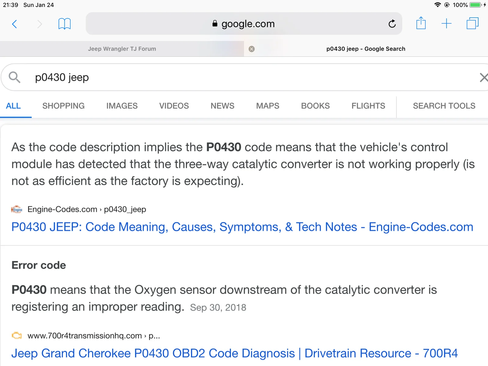

Dnel605 New Member Original poster Joined Jan 24, 2021 Messages 3 Location Las Vegas Jan 24, 2021 #4 It is throwing code p0430. Camshaft position sensor
N never monday TJ Addict Joined Jan 24, 2021 Messages 1,096 Location SW VA Jan 24, 2021 #5 Dnel605 said: It is throwing code p0430. Camshaft position sensor Click to expand... P0430 is catalyst inefficiency
