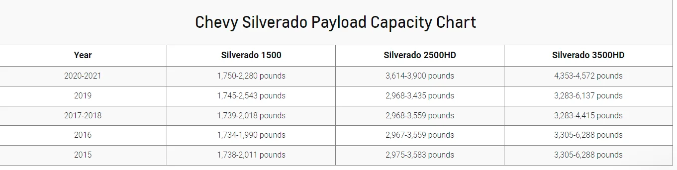

This is one of the things that kept me from buying a 2500 diesel. When I looked at the towing specs I would get a 3,300 pound increase in towing capacity, for almost twice the cost of what I paid for the gas version.Problem you get into with 3/4 ton diesels is they have *hundreds* of pounds less payload than the gasser counterparts. The higher cost of entry, emissions maintenance woes, all add up too. And then folks don't buy base model 3/4 ton diesels, they get a lariat or whatever, which adds hundreds of pounds of doodads to the curb weight=lower payload even further. Nobody looks at their door jamb stickers!
The duramax 1500 payload numbers are abysmal though on the actual trucks, and honestly I would run a gasser half ton long before the small diesel if towing 7000lbs. Also, look at that GCWR on the duramax. 15000lbs. Only the lower rated 5.3 is the same, all other V8's with substantially higher GCWR.
