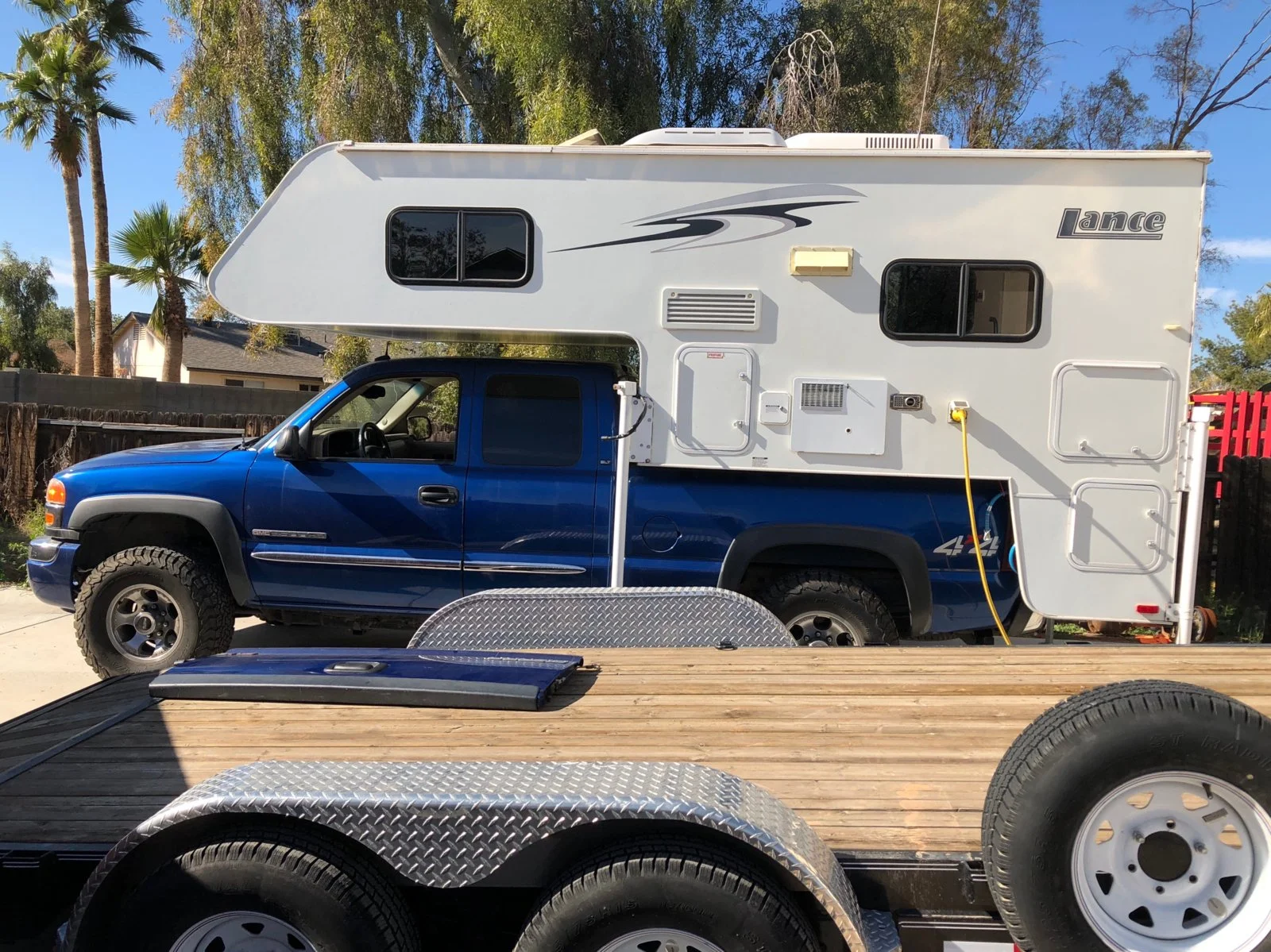

I have a 2005 GMC 2500HD with a Lance camper (845 previously, now a 865) and I use a TorkLift SuperHitch "super truss" hitch receiver and extension bar. The SuperHitch receiver replaces the frame-mounted stock receiver and uses a dual-arm extension (over/under) to support the tongue weight of the trailer. It also uses chains tethered from the end of the extension to the frame to control side-to-side movement. It is very strong and stable and allows a user to move the hitch ball from under the camper to just beyond the end of the camper. It also maintains the vehicle's supported tow rating which would normally be lowered with other hitch extensions.

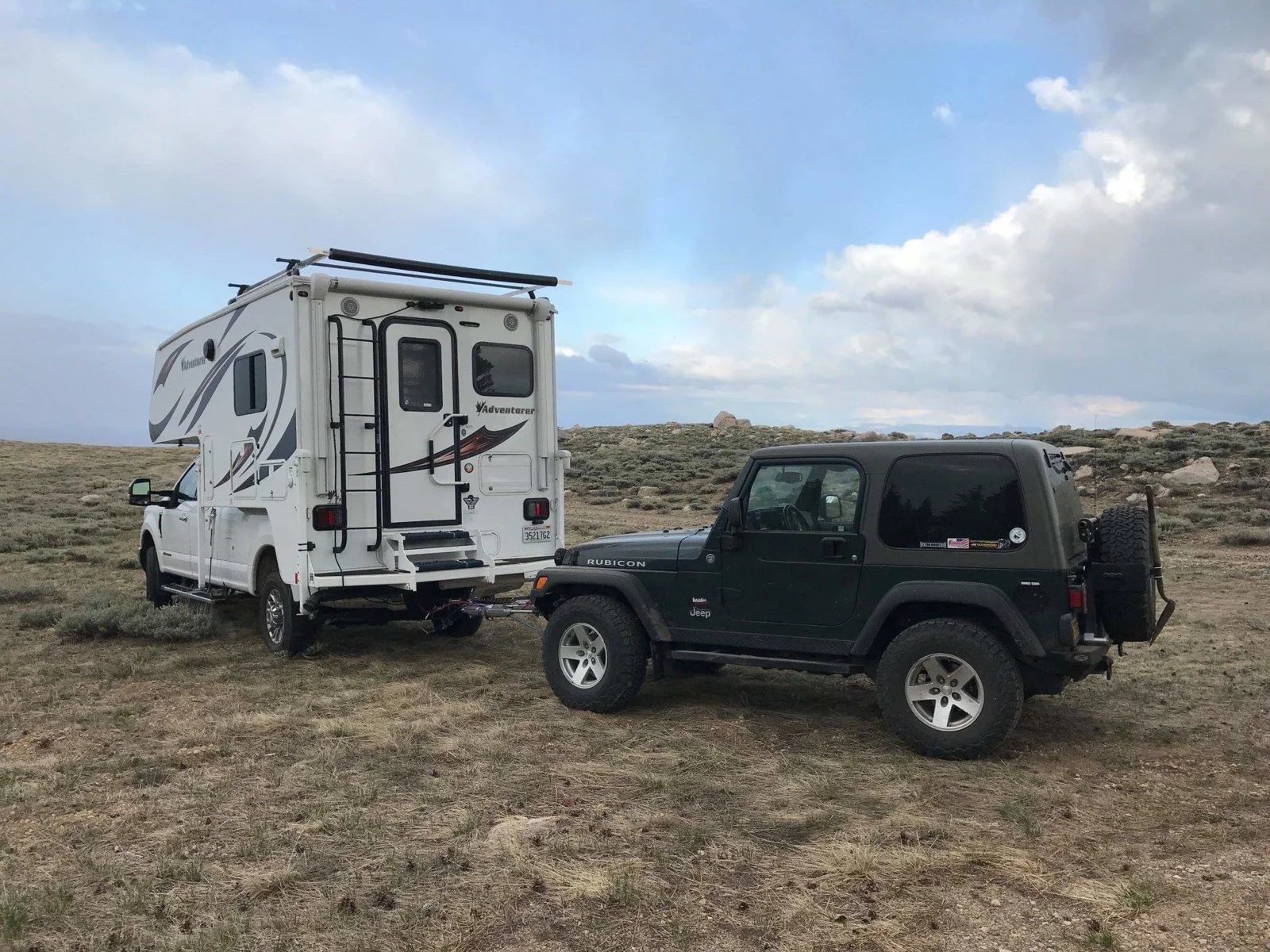

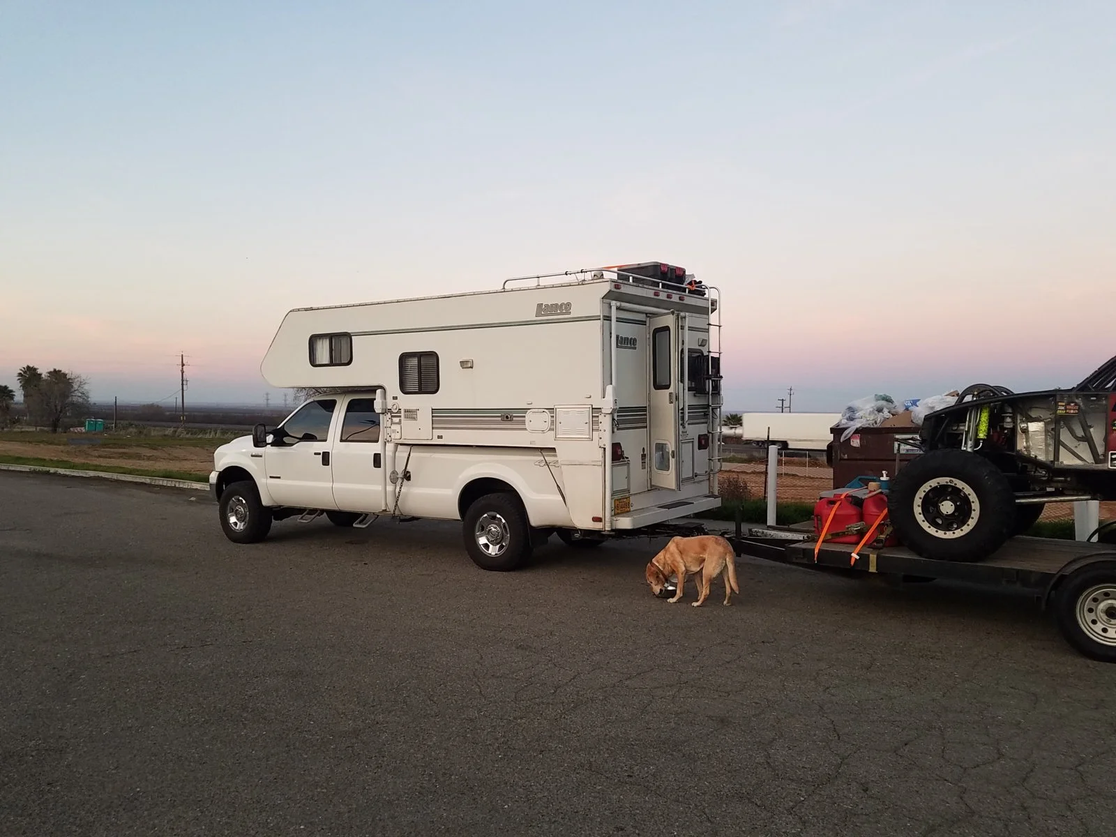

You can use this to either Flat Tow or on a Trailer or Dolly. Each towing method has plusses/minuses that you have to weigh out depending on your intended usage. I use a 16' trailer, and has worked well for me for over the past 10 years.

That being said the tj’s flat tow so easily not sure why you’d trailer it but to each their own. I’ve got about 20k towing an xj another 8-10 with my tj.
