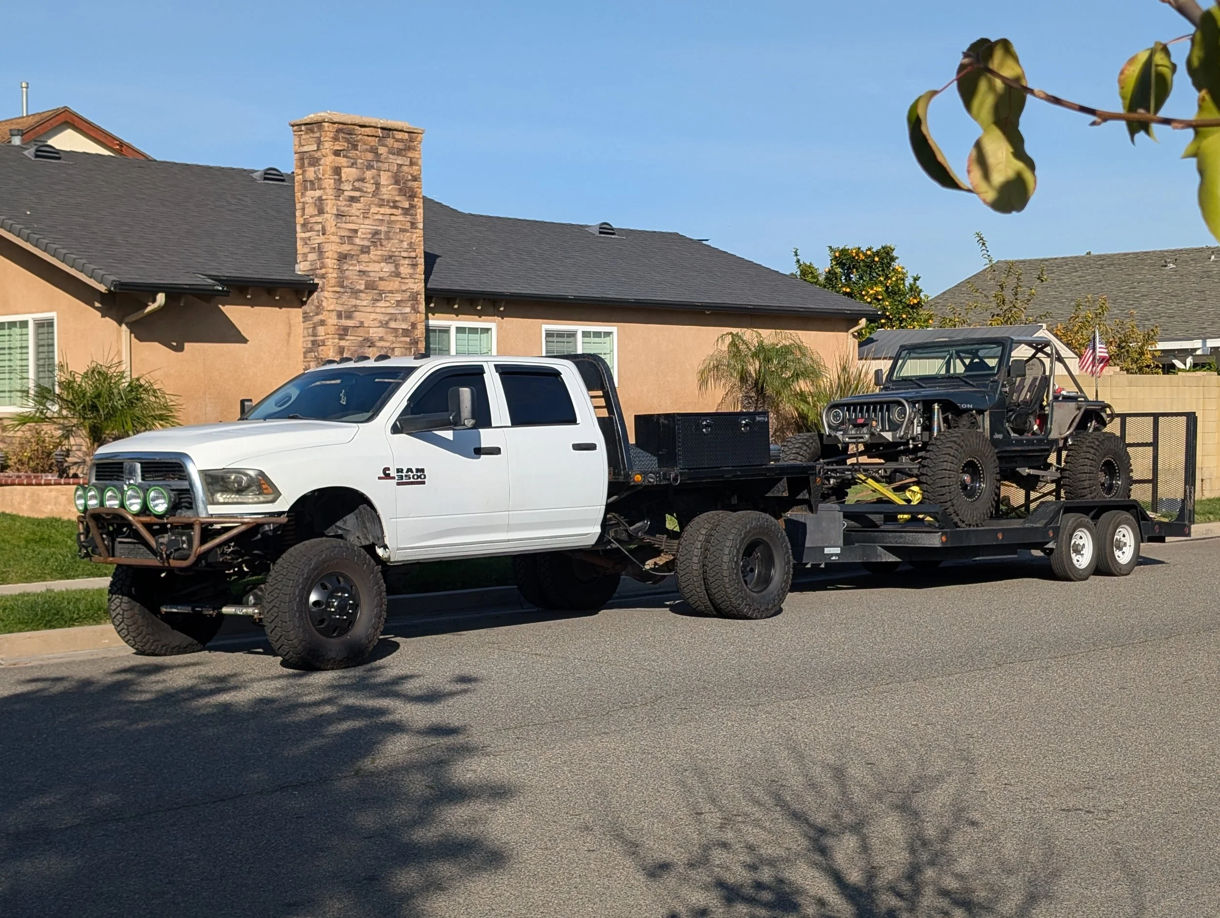

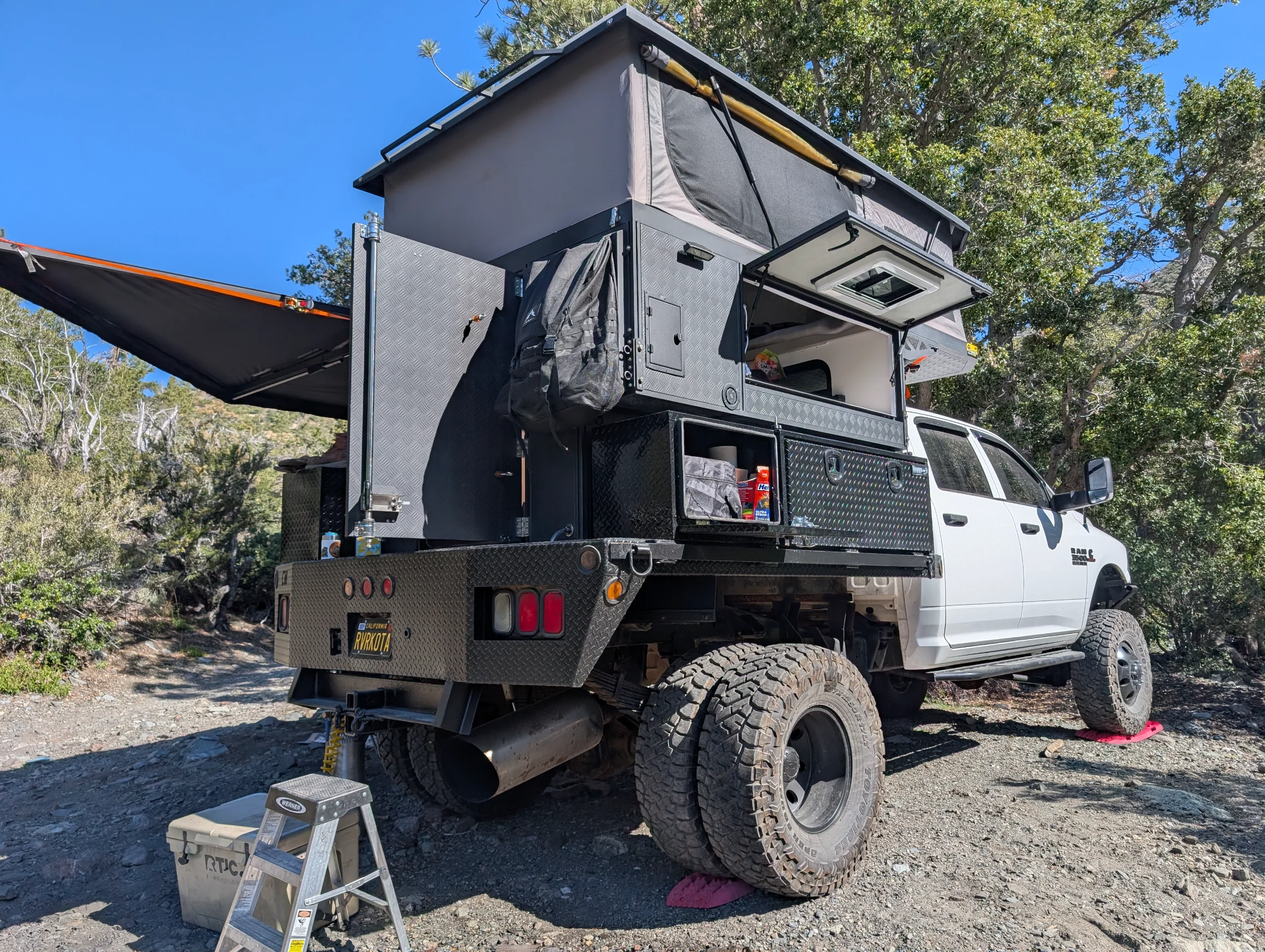

Now that I have this idea in mind I sold my 4runner, sold the S10, sold my old Ram and bought my dream truck with the goal of turning it into my dream camping rig.

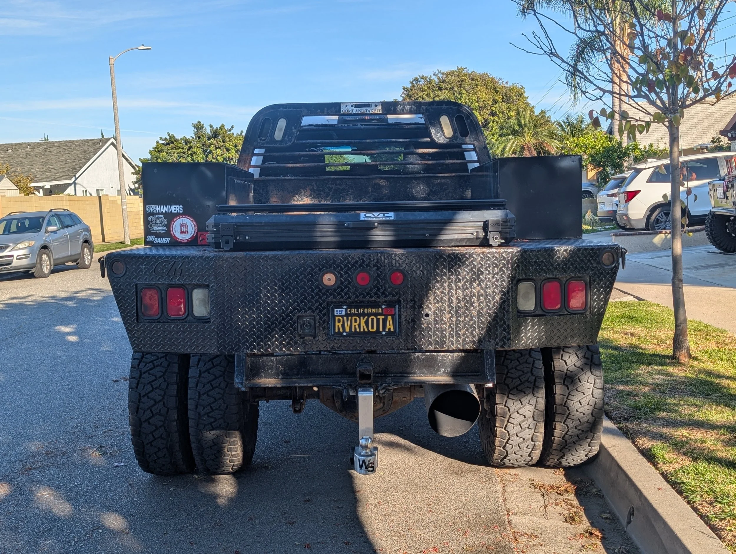

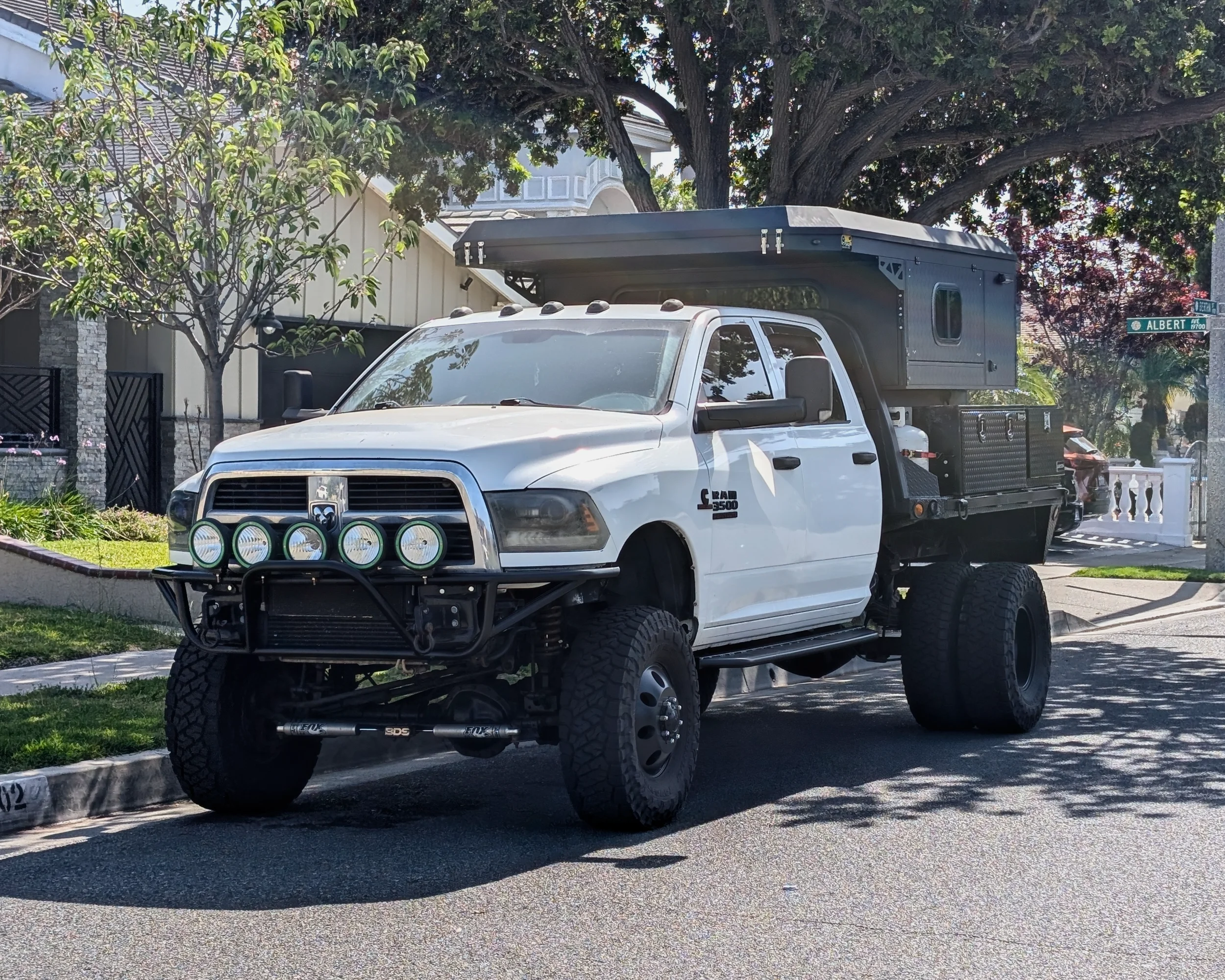

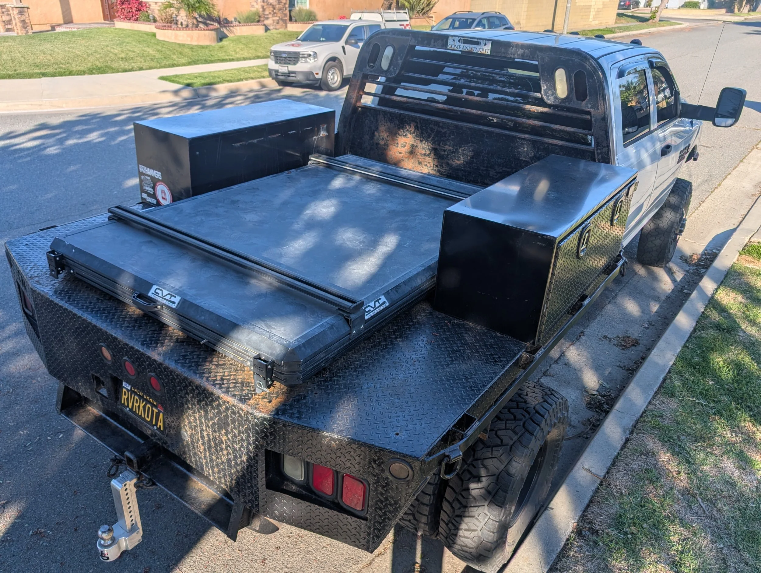

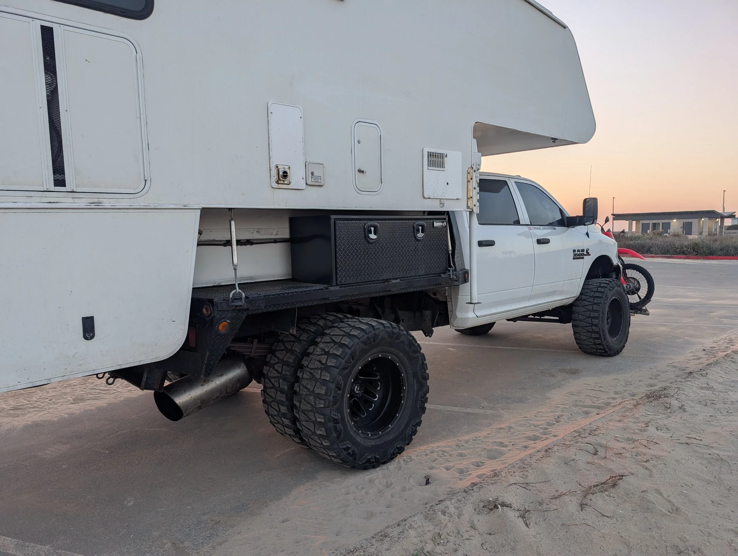

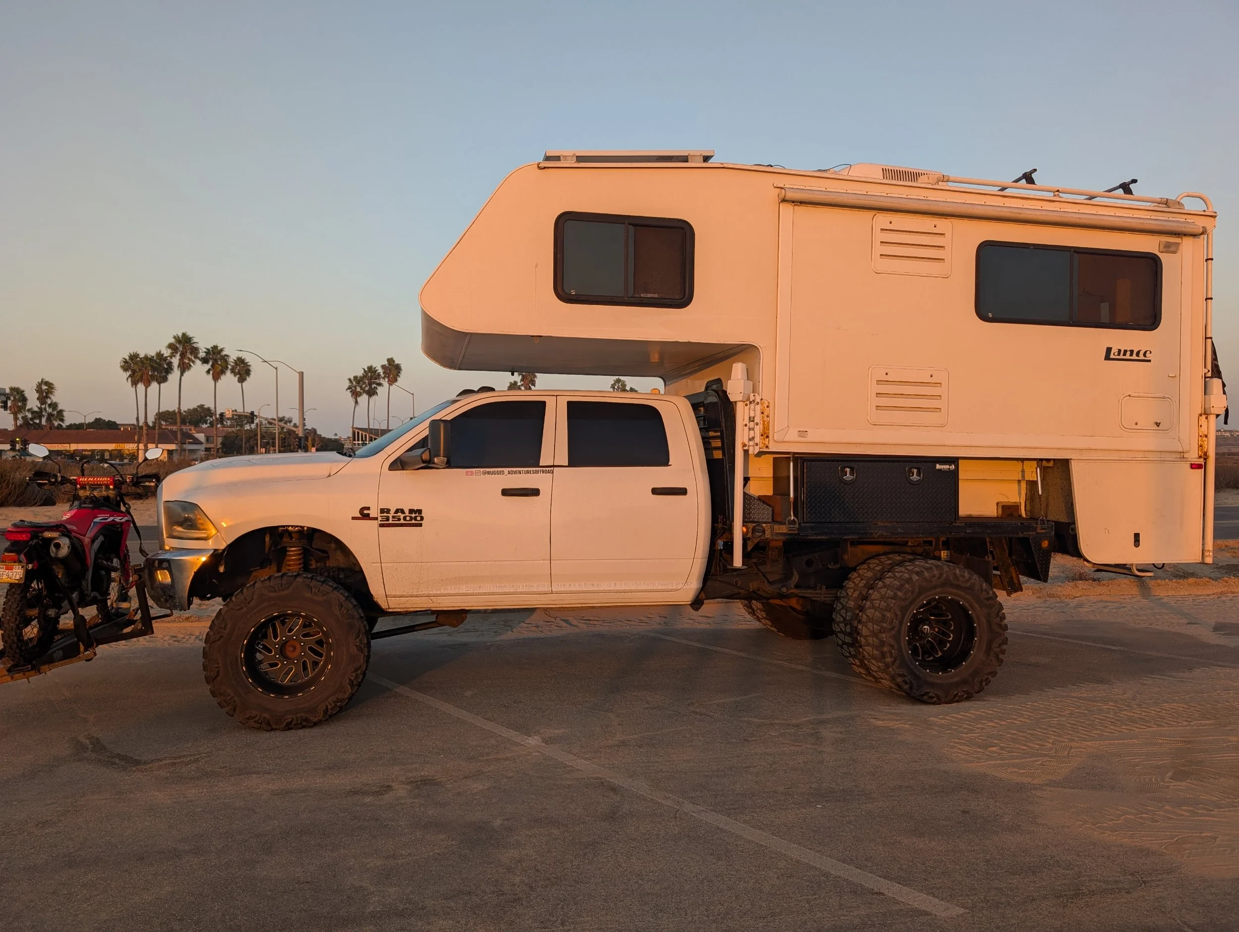

Here's the truck. It's a 2012 Ram 3500 with the 6.7 and g56 manual, 130k miles. I've always wanted a LB DRW flatbed with a manual and I was somehow able to find one here in Cali. I paid way too much for it but this is exactly what I wanted. Ignore the unfinished bumper I started, they're a lot of things I want to do to this truck that's non-camper related.
This flatbed is essentially 8'x8' which gives me a massive platform to build off of.

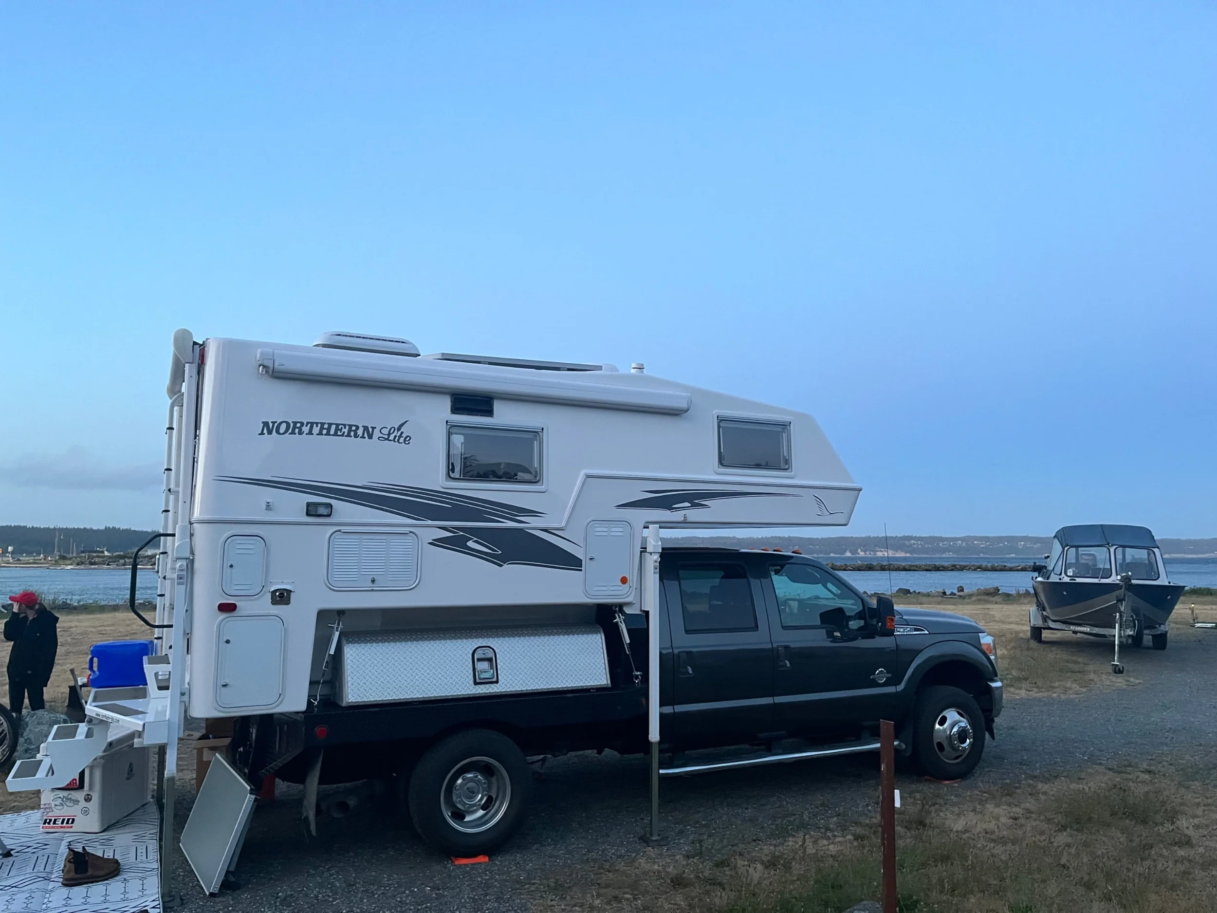

The PO had a massive camper on this truck when I bought it. He offered it to me for a good price but I have no interest in one this big.

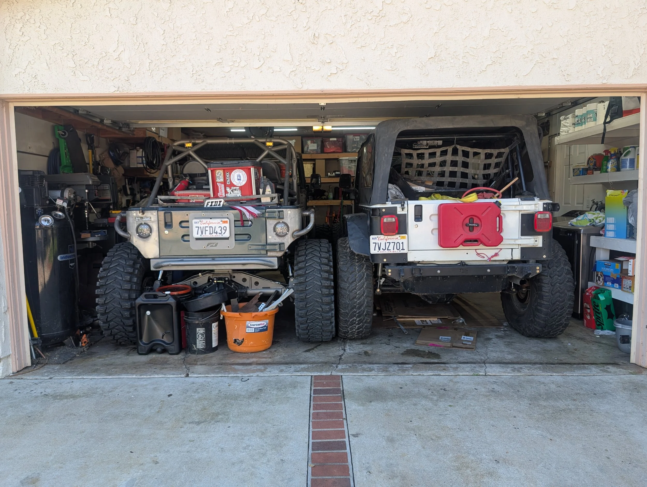

I don't have a shop or even a flat driveway so I'm forced to build the entire camper on the floor in my 2 car garage that's already occupied by a jeep on tons.

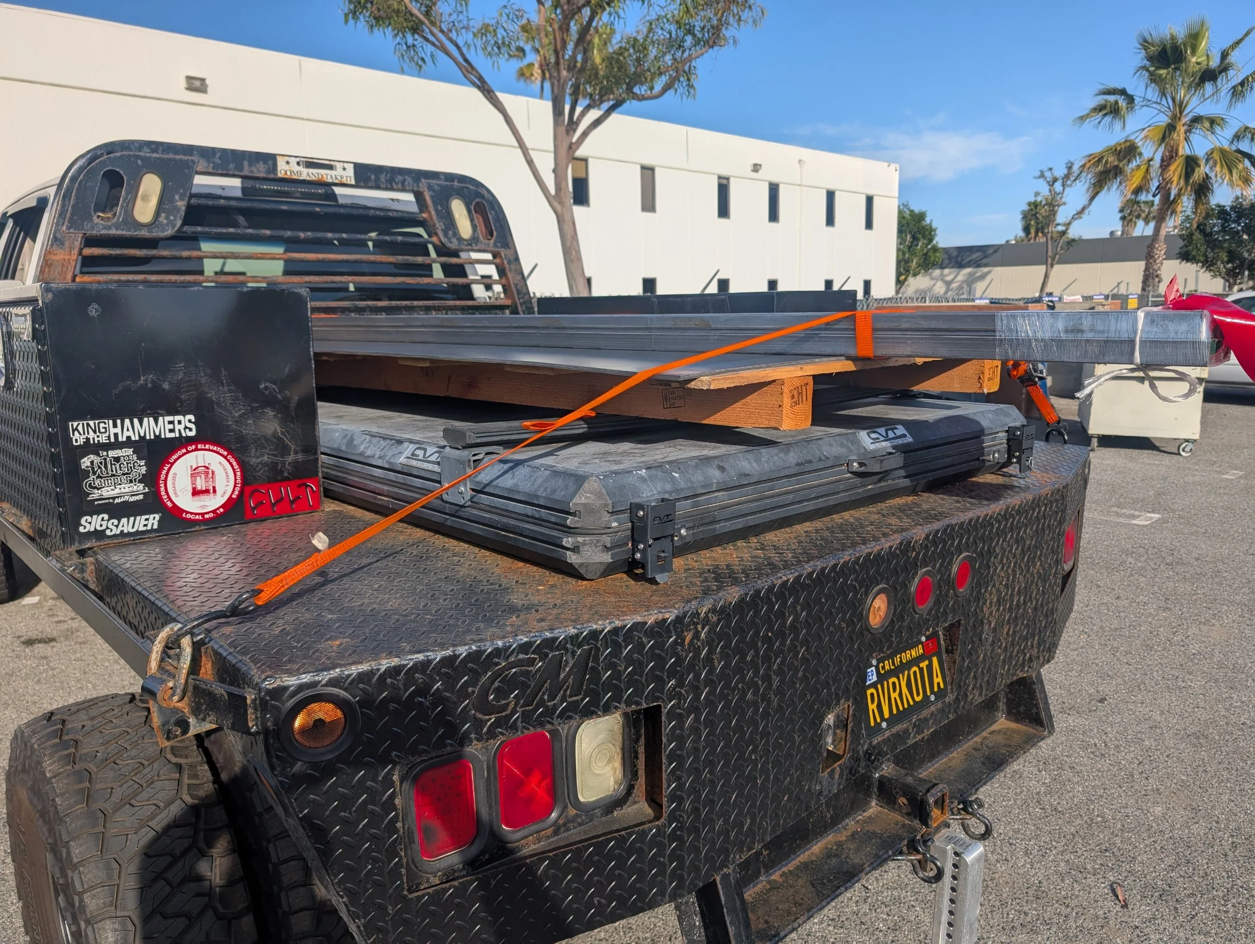

So to finally start this thing I picked up $1000 of material. I'll have to get more soon but this will get the bones built.

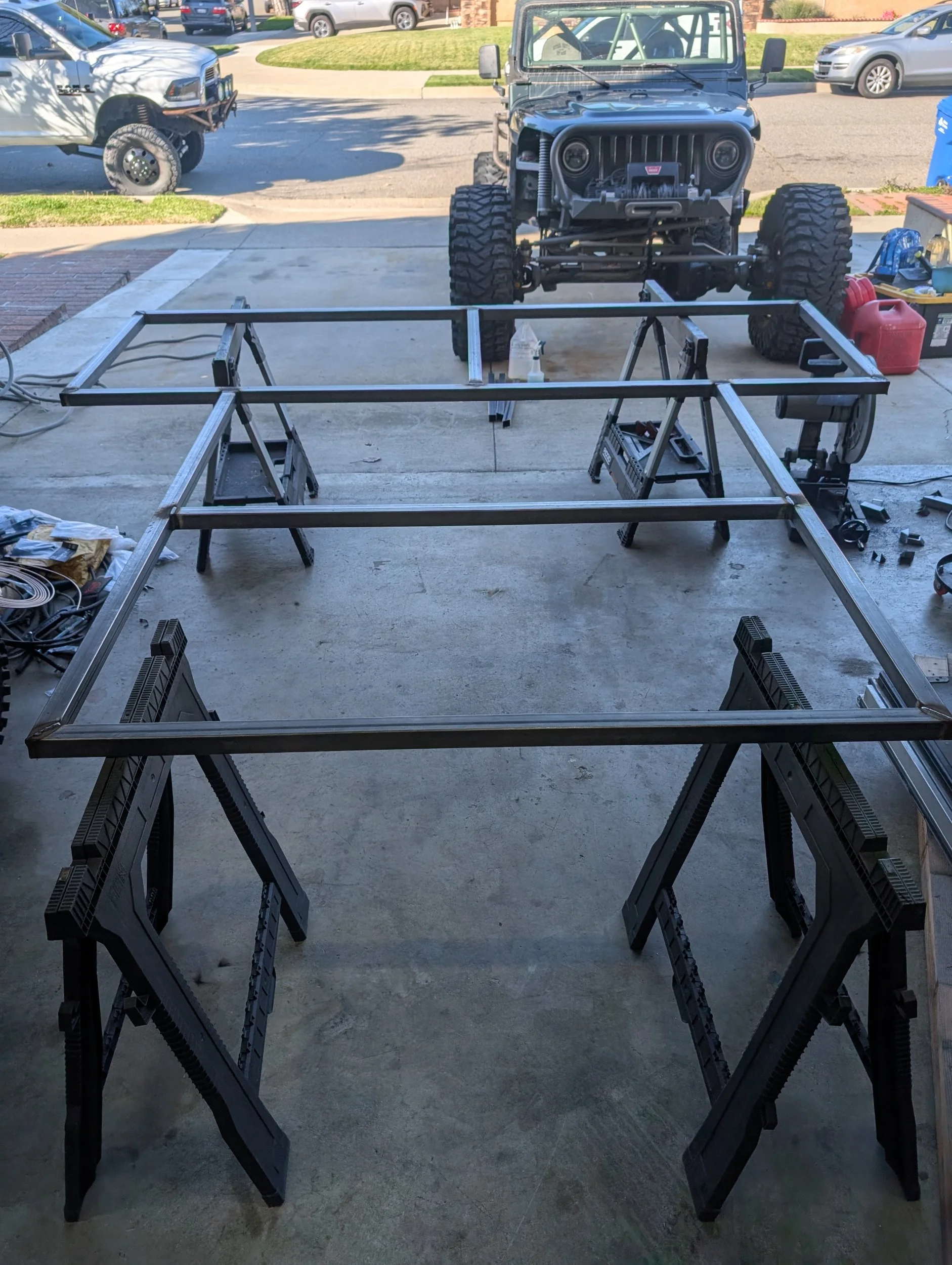

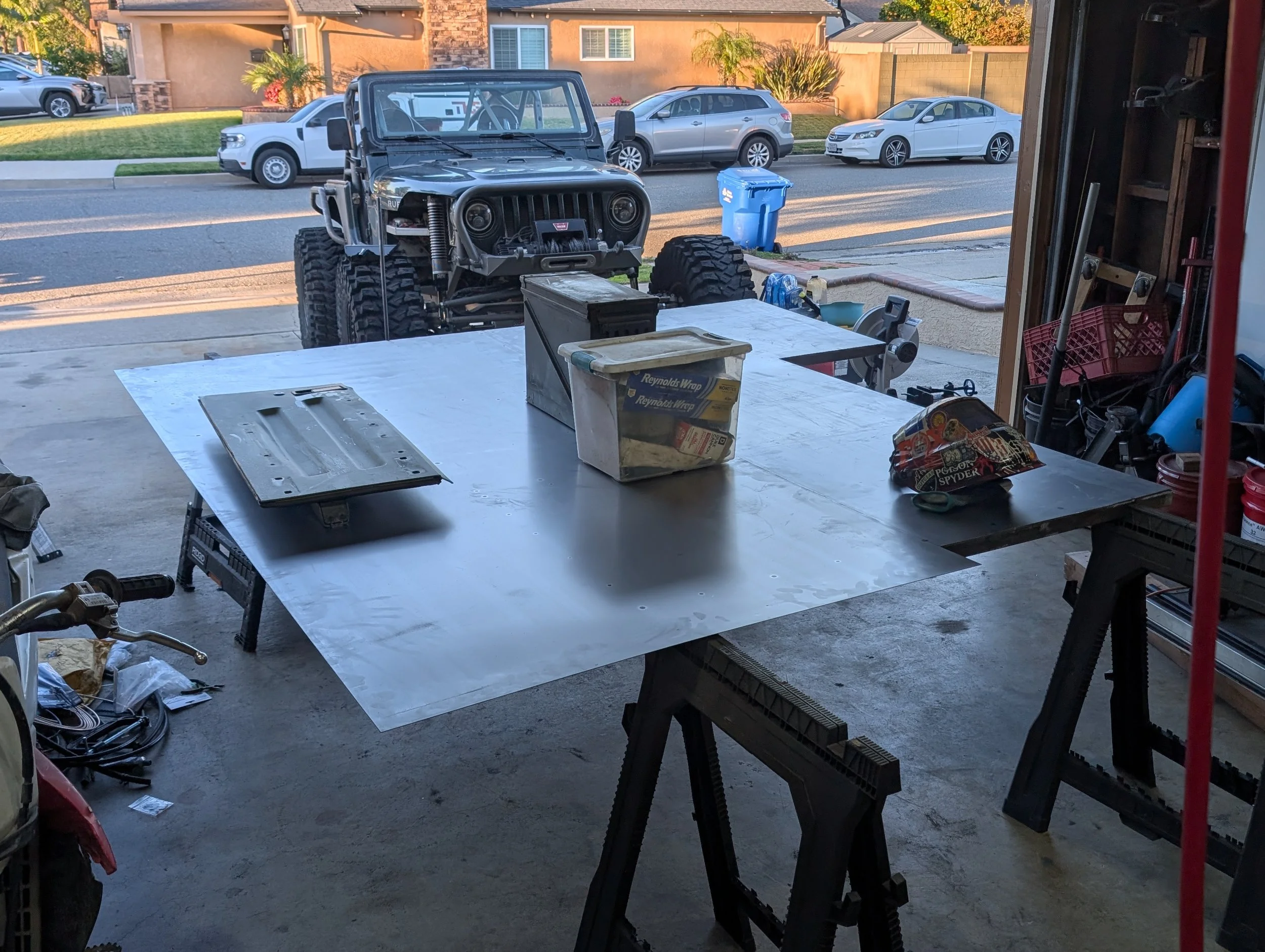

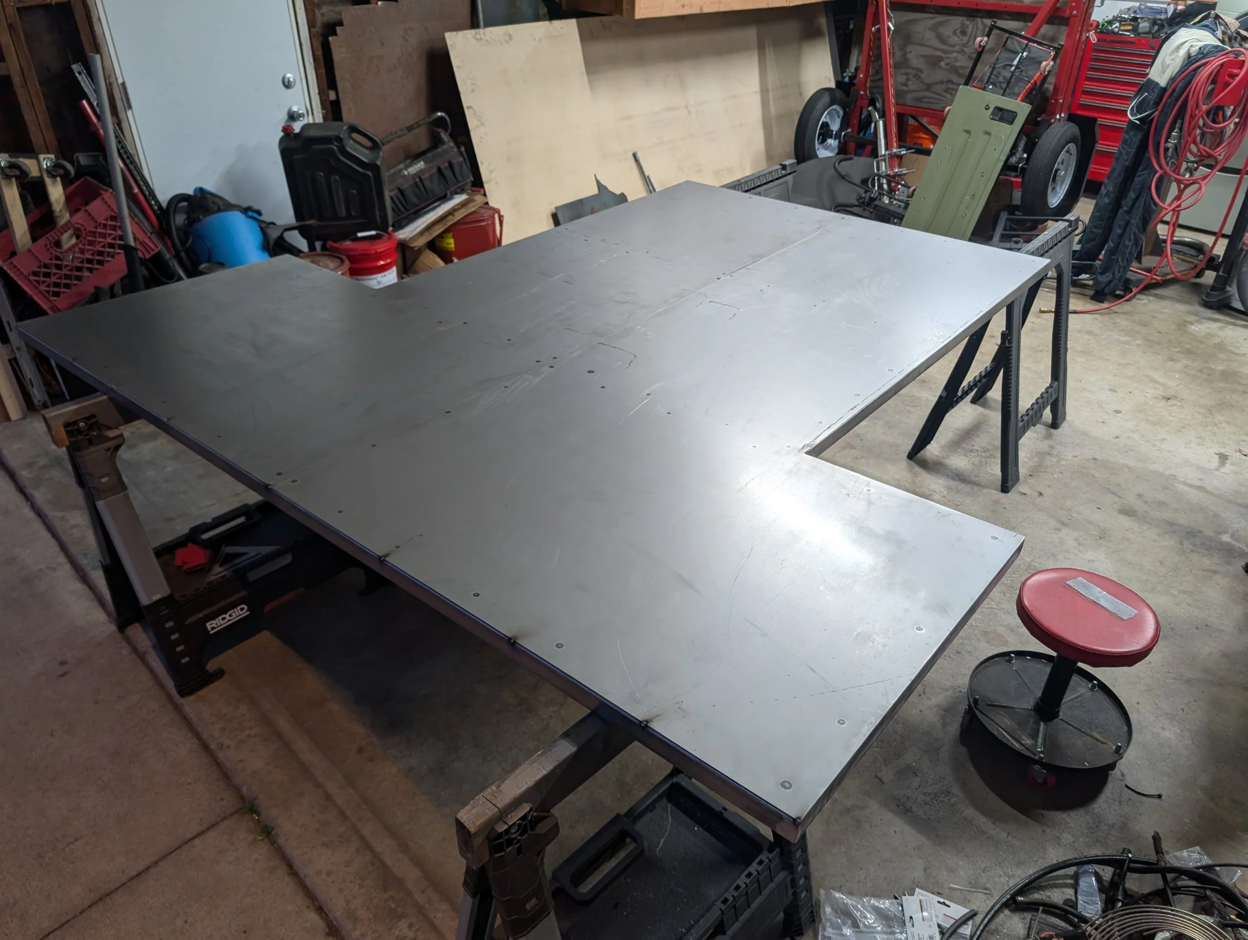

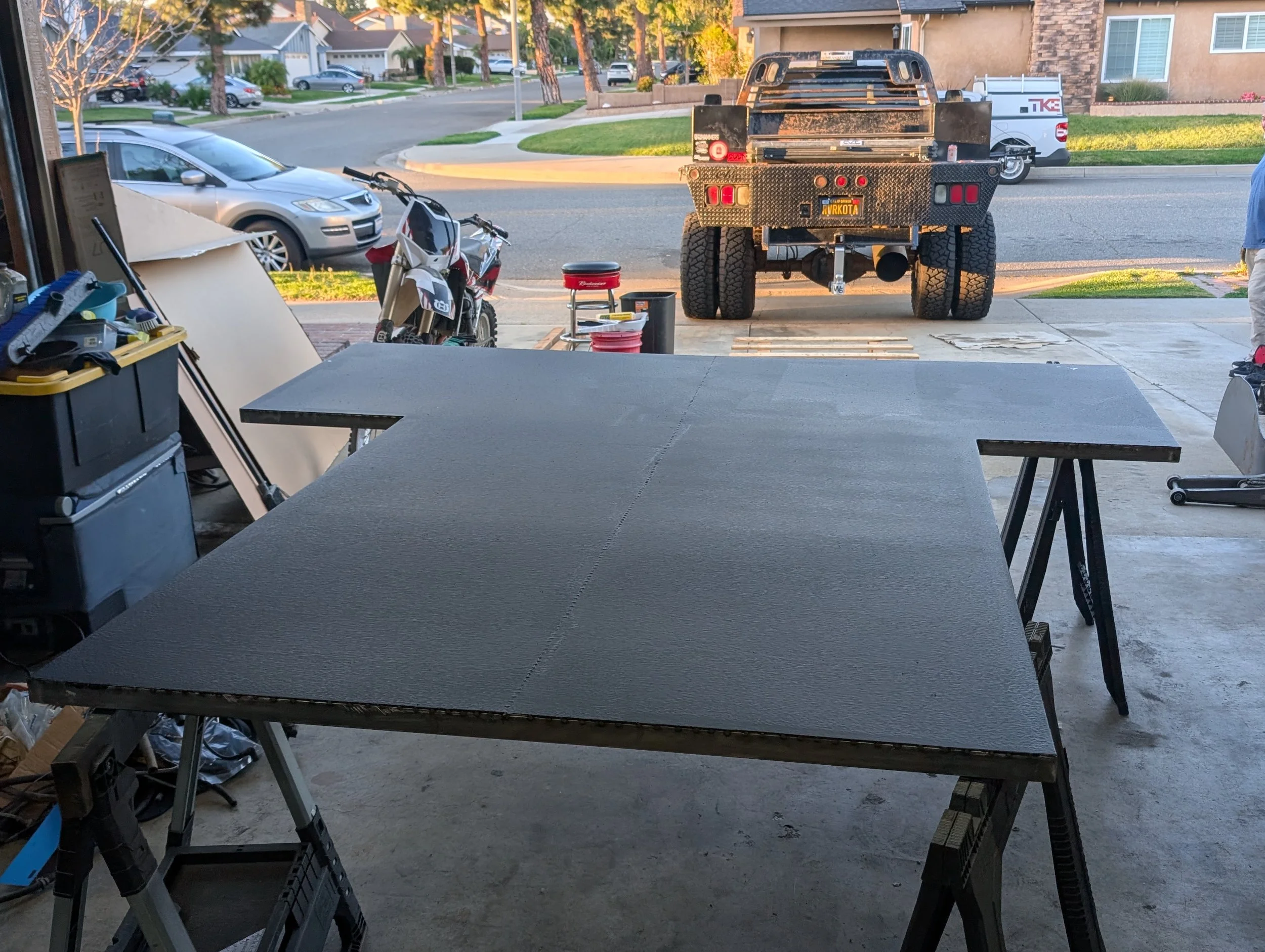

Using 1.5" x 14g square tube I built the bottom base. This is what everything else will be built off of. This pretty much follows the size of the flatbed minus the two storage boxes. Nothing will be built extruded in front of the boxes so that the camper can be slid forward when installed.
All of the joints were finish welded and ground flat so that the 16g sheet metal can sit flush. This will be the underside of the base. I used cold rolled steel for these sheets instead of hot rolled because it has a much smoother finish to it. This being the bottom of the entire camper doesn't matter but I'm using the same sheets for the outside walls.
Once the sheets were placed on top I tacked them underneath and used a sawzall to cut out the frame. Here's what we're left with.
That's all I was able to get done in a single day. But now that the base of the camper is built everything else will follow quickly.

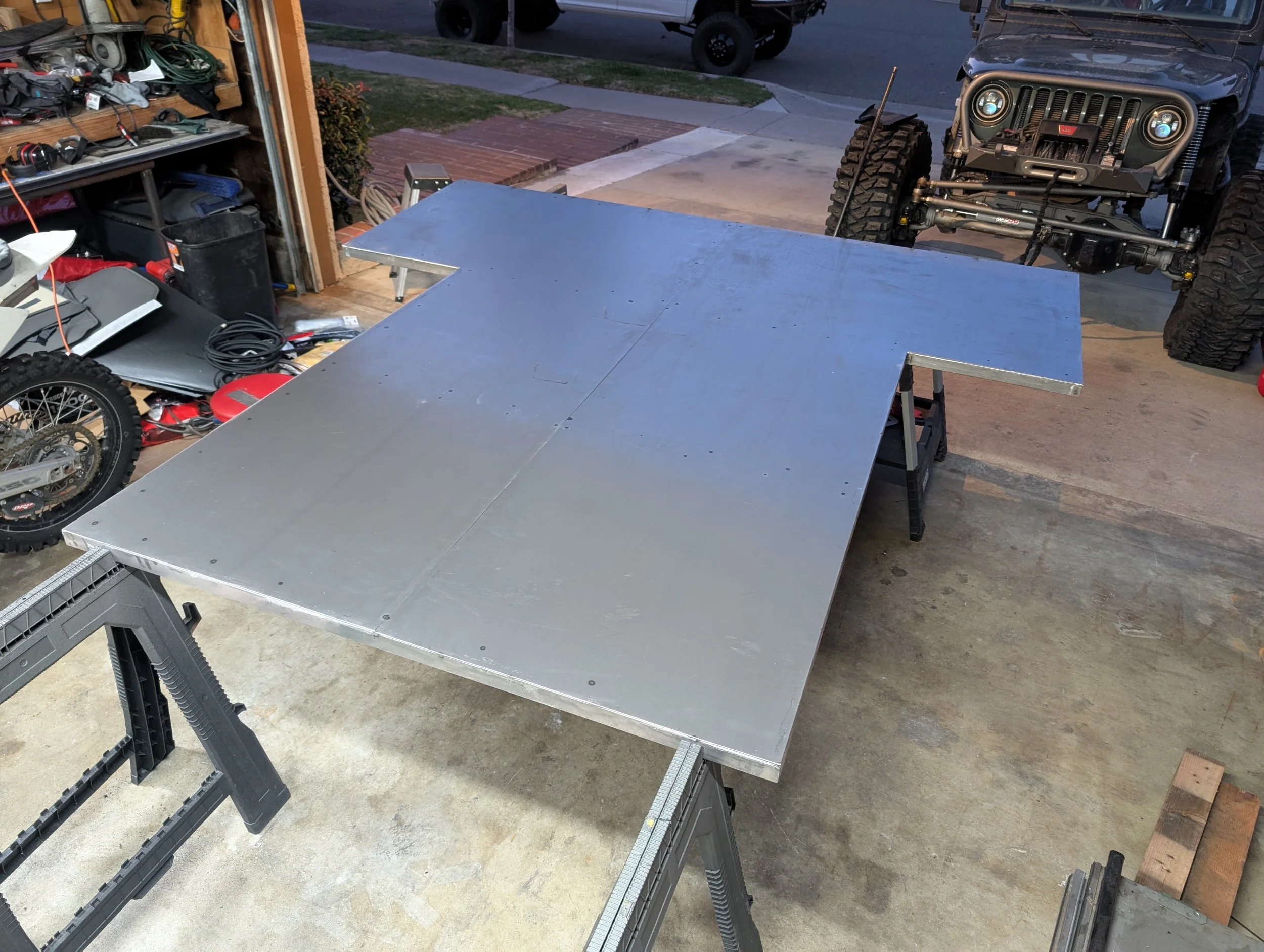

The next step is to paint this sheet metal because once I turn it over I won't be able to get to it again.
