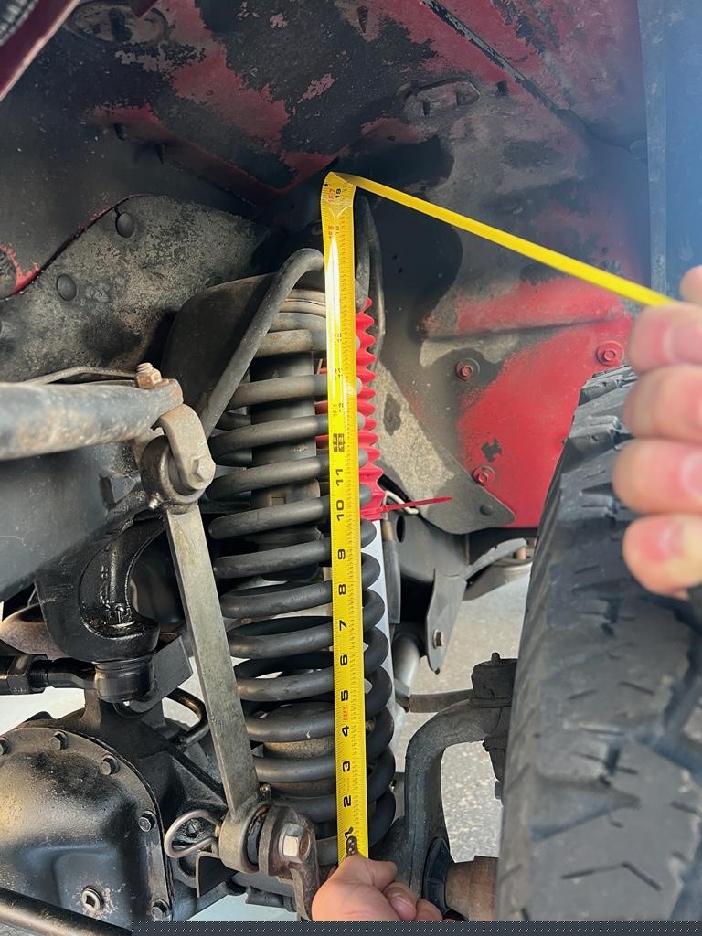

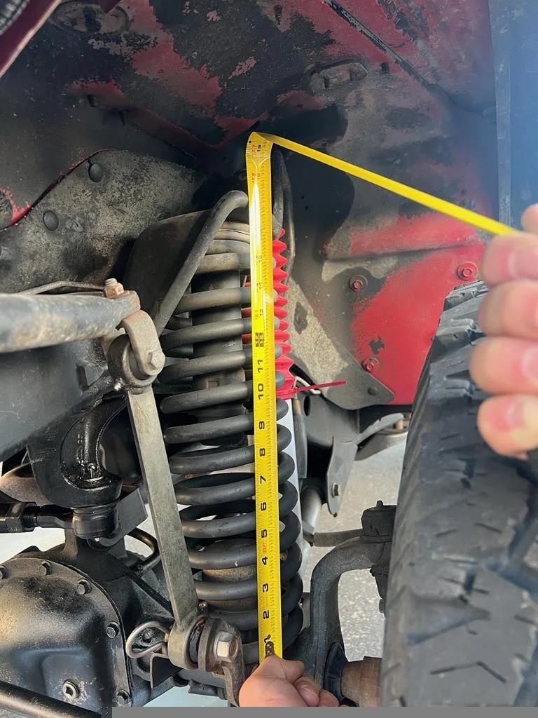

The JKSOGS128 uses a 5/8 bolt at the frame. JKS says this one requires 2-1/2” of lift. You can measure your current springs and determine what your lift is. If I remember correctly, the stock springs are 12” in front and 8” in the back. Anything over that is your lift. If you have any spacers above the springs, that will count as lift too.
Here is the measurement. I thought I could recall the last guy I bought it from a while back said it had a 3" lift. Does that look about right? Thanks

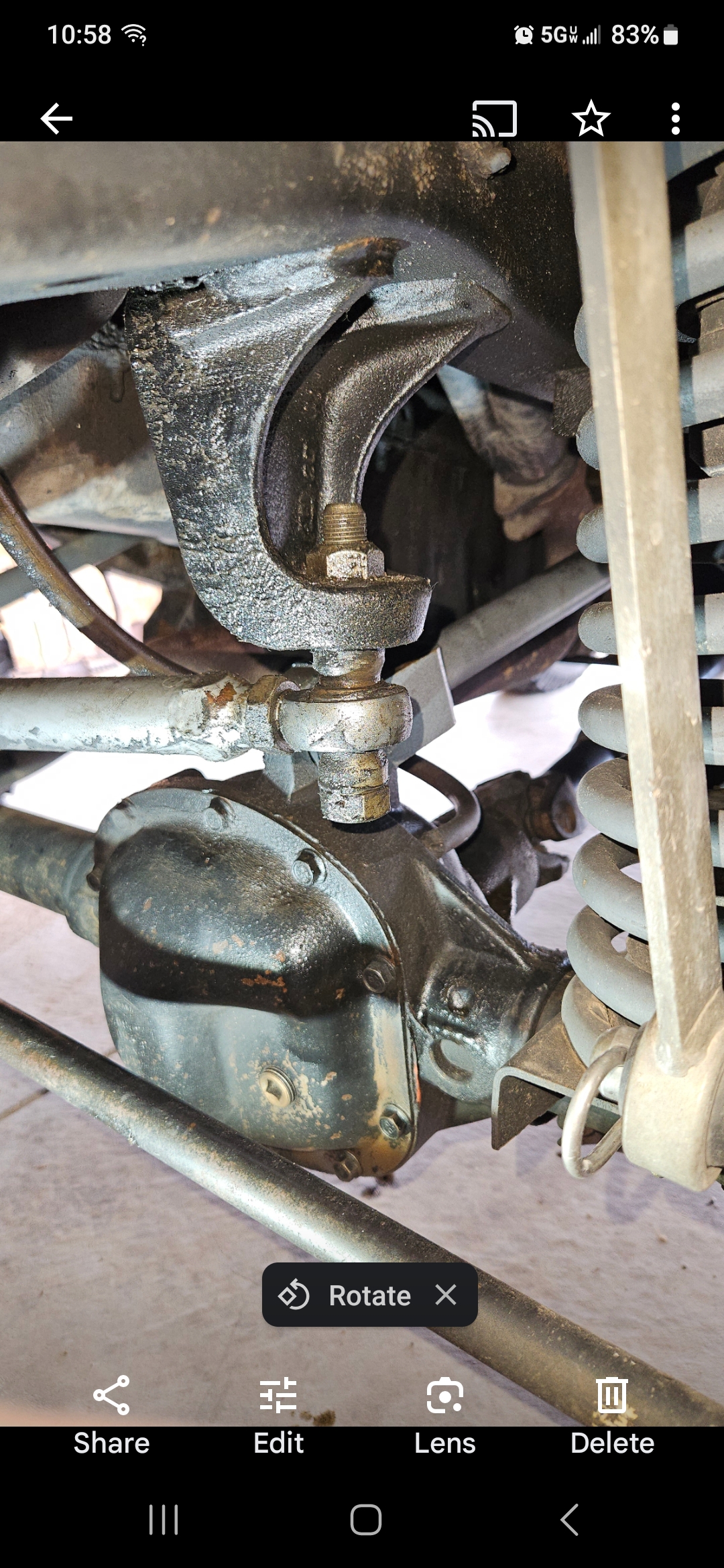

But when I installed it I noticed that the ball joint went to high up into the frame hole mount. The castle nut was all the way tight when too many threads from the bolt were exposed so the cotter pin would have been useless if that makes sense. So I had to ease the tension a little bit to make the cotter pin do it's job. I tried my best to center the axle by reading a bunch of threads on here (bouncing on it, ect) and my drivers side wheel is still too far out. Definetly and inch or so off center.
But anyways, I filled up that ball joint with grease and the whole thing was tight. Immediately felt better driving, especially on bumps and turns. But that only lasted 4 days.... Now the whole things loose and there is play in it. Only thing I can figure is the owner before my had reamed out the frame mount or something for the Hiem joint. I can't tighten it anymore if that makes sense. Definitely doesn't feel safe to drive
My question is what track bar end can I fit in the mount that that Hiem joint used to be in? What hiem or ball joint will fit in the Rough Country track bar?

My LJ had the RC track bar on the front when I bought it. For the install the frame bracket is drilled to 5/8” ( don’t quote me on this I don’t remember exact size) but the only track bars I found that had the hole that big were the Currie and Metalcloak bars.
