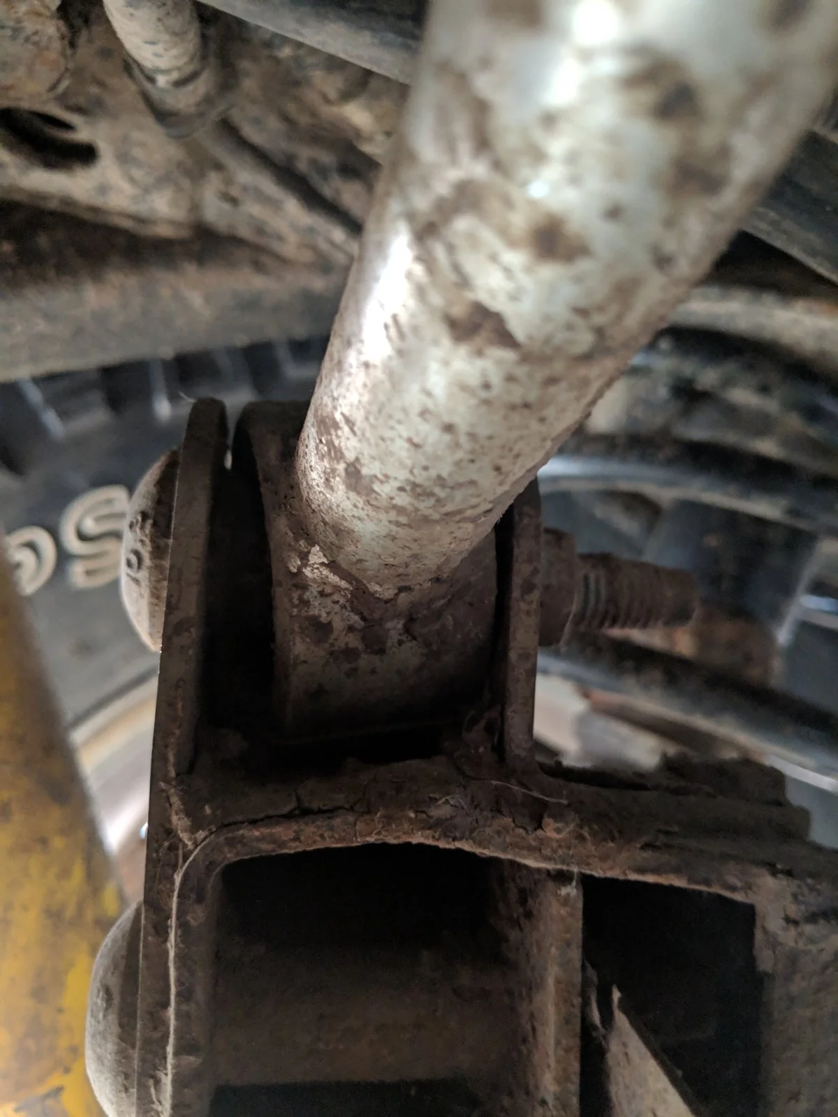

I have a Rubicon with a 2 inch OME lift and a 3/4 transfer case lift. That doesn’t sound like much but I am considering the installation of a double cardan drive shaft. To rotate the pinion up I assume I’ll need to replace the stock trackbar with something that has a Johnny like the JKS to deal with that angle change. I have a couple of questions about that:
1) The OME trackbar relocation bracket is straight up. It is ok to assume the Johnny joint can take care of the angle difference? JKS makes a trackbar relocation bracket that has the angle shift built in but it is only good for 3 inch and higher lifts.
2) With the OME 20 mm bumpstop spacers the stock trackbar hits the tub slightly. Has anyone with the 2 inch OME lift used a JKS trackbar without difficulty? Did you have to go to larger bumpstop spacers?
