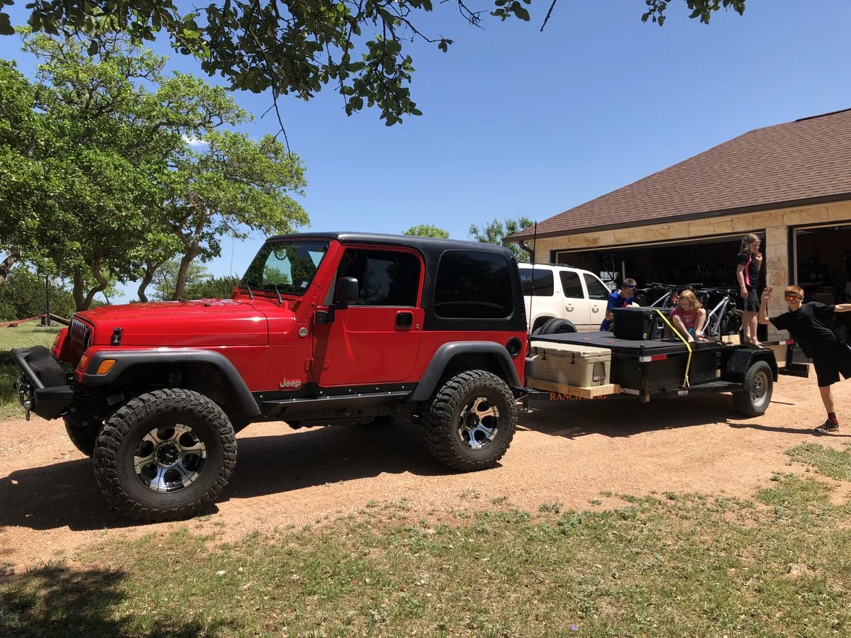

Loaded down for a 2,300 mile trip.

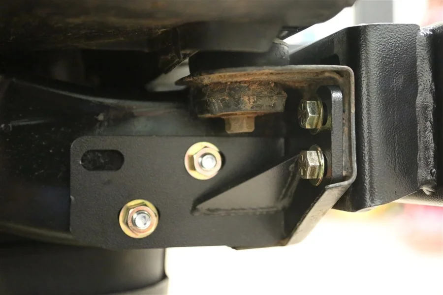

Jerry,
I don't understand. How do these brackets help when the receiver is in the middle of the bumper, but the brackets are on the ends?
The bolts on the right side of the bracket are the bumper bolts. The thin piece of metal sandwiched between the frame brace and the bumper is the rear crossmember. The rear crossmember is significantly thinner than the average 3/16" steel bumper and 3/16" frame rail, and doesn't have a lot of reinforcement.
Thus, the crossmember is known to peel or tear off the frame in various loading conditions on the bumper, such as torque from a heavy tire carrier with cargo racks, tension from a recovery strap, or combined loading from a bouncing trailer.
(Imagine how much it would suck to find out you not only tore the bumper off the frame, but tore a piece of the frame itself off the Jeep.)
The brackets take the majority of the load and transfer it directly to the 3/16" frame rail, thus preventing any significant damage to the rear crossmember. There are other alternatives, such as welding on a crossmember reinforcement (Genright sells one) and gusseting where the frame brace would be, but it turns out a bolt on solution is completely adequate and much simpler for the average person to install.

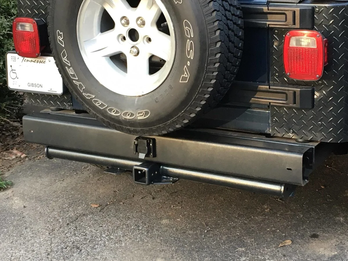

I think mine is a Curt. Rated to a 400lb tongue weight and 4000lb. I peeled the sticker off when I installed it. While I do on occasion pull my utility trailer around with it, mostly I have a wheel chair carrier in it for my wife's electric wheel chair which weighs about 300lbs by itself, not counting the carrier.
OK,that makes sense. The numerous times I've removed my bumper, I never looked at how the frame and cross member are connected. I assumed the the two bolts on the end where connected a member that was part of the frame.
I like bolt on solution because I don't have a welder.
