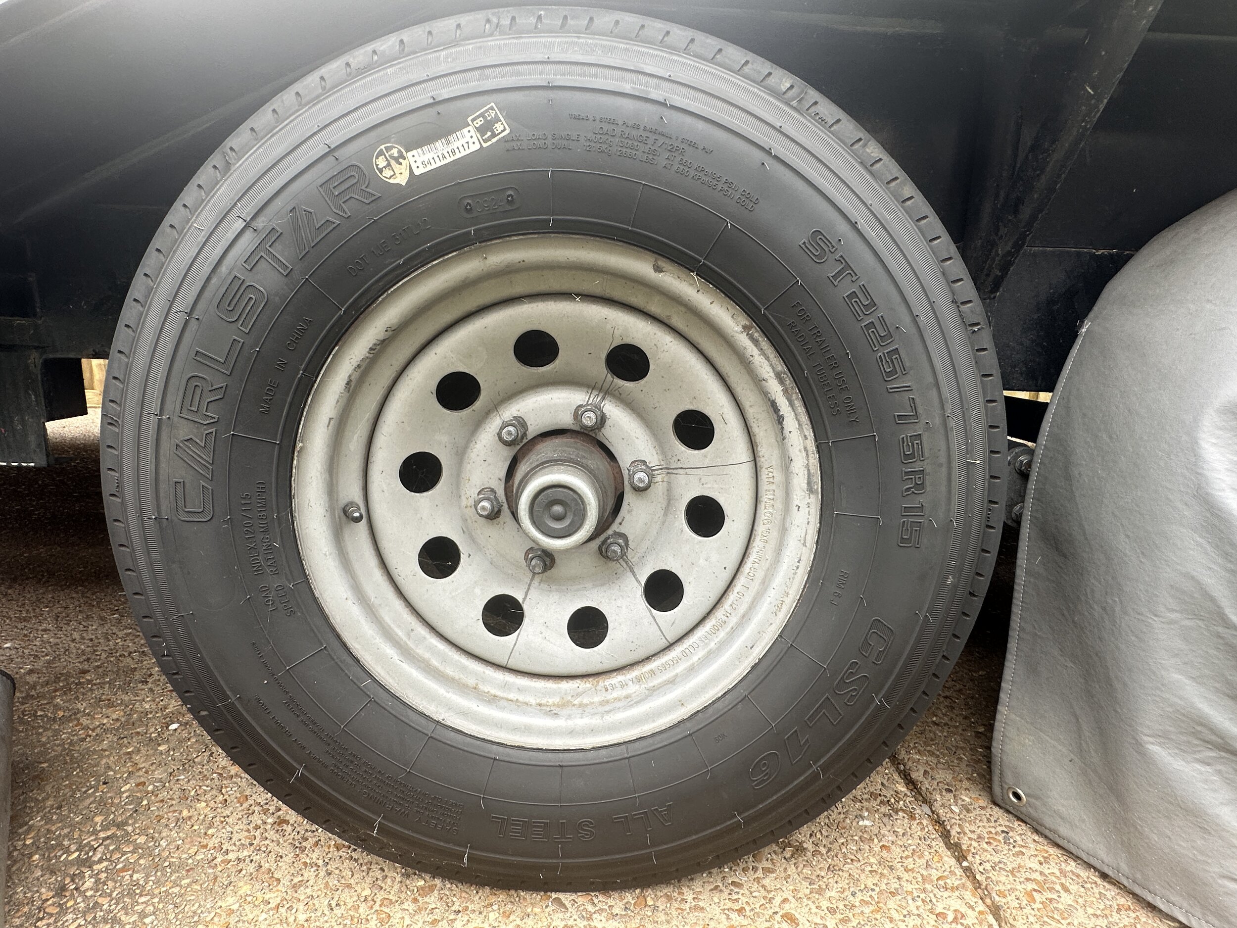

And despite running 14 ply / G rated Carlyse tires, it blows tires with regularity - usually when making the trip to Moab at 80. It's simply overloaded.
This sounds like an axle alignment issue not an overloaded issue, especially by just 400lbs if you’re already running G rated tires. You’re already running the tires that your 15k trailer will run. We have a 16k equipment trailer at work that we’ve put well over 100k miles on with G rated tires and we’re constantly at max weight with skid steers and what not. We rarely blow tires on that trailer. We wear them out 99% of the time before we have a blow out.
Good thoughts. An alignment issue would likely cause bad tire wear prior to a blowout, correct? No such wear was occurring - and I pay close attention given my history. I think I've now blown 6 tires. And given my experience I've checked the alignment of the axles, and they are true. I also thought it could be a rubbing issue, but no wear or contact marks at all on the inner fenders or the running gear.
I misspoke in my post above. The tires I run on the current trailer are not G's, they are F's (damned memory...), 12 ply. They are 15" tires at 95 psi, and the capacity is only 3k - the largest I could find for a 15" rim. The tires on the new trailer will be G's / 14 ply - 16" at 110psi, with something like 4400 pound capacity.
And one other item, I run over 1,500 miles one way when I head out to Moab. Every blow-out I've had has been deep into one of these trips. Never had a problem on shorter trips.
Hopefully better luck with the new setup.
You'll like the wear on the 16" G-rated tires compared to the 15" tires. Even with my tri-axle set up, I have zero scruff wear from the tires dragging when turning.
Yeah, usually you’d notice tire wear before a blowout, unless it was so bad that they got hot enough for a blowout before you noticed wear. Still pretty crazy, I don’t have any 1,500 mile non-stop trips that I can think of but I have lots of 500-1,000 and once I switched to G’s blowouts became far and few between.
For future reference, Transeagle makes a G rated 14ply in 225/75/15 with around a 3,400lb load rating. I’ve had good luck with them on my 5’er.

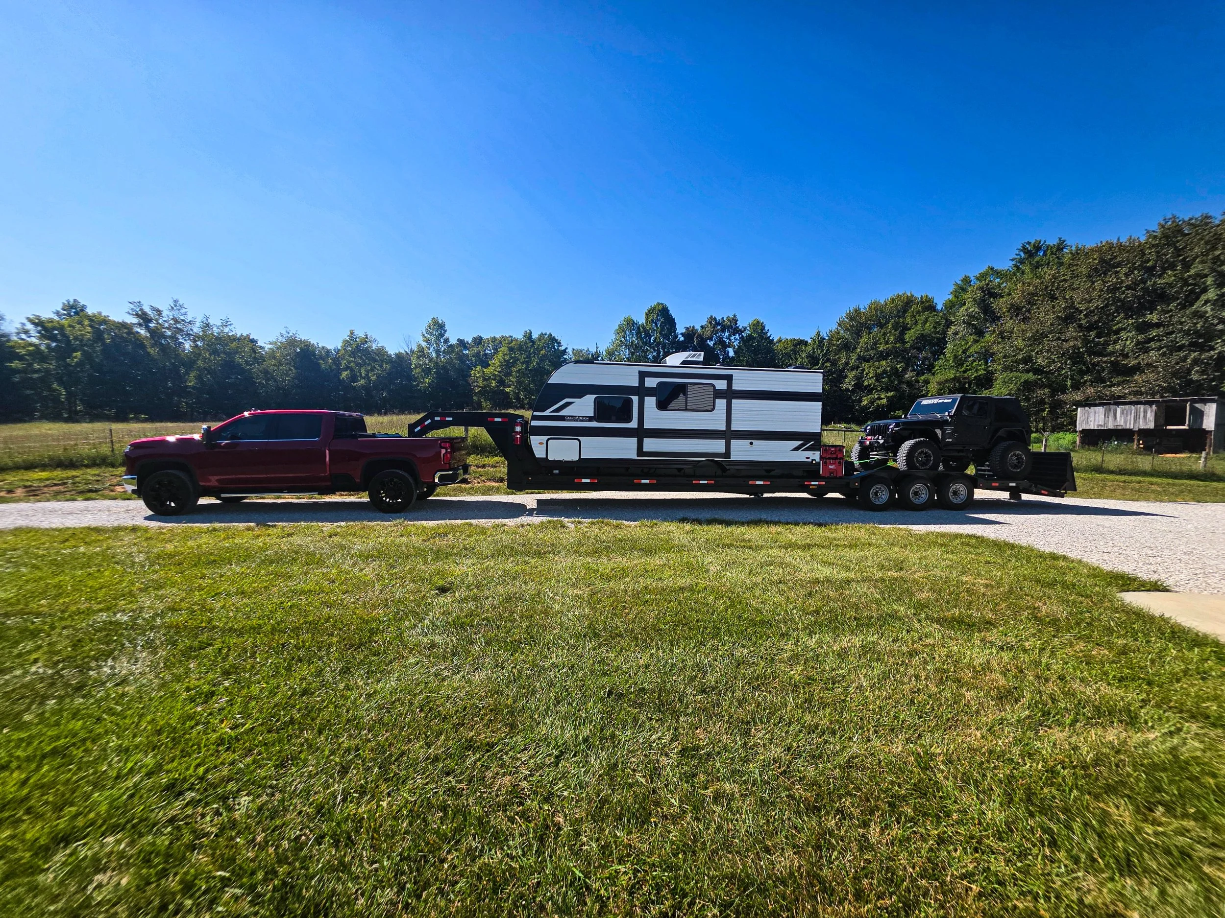

When I had my 14k equipment trailer that I hauled the TJ on, I pulled it with my Silverado 1500 3.0 Duramax. The trailer and TJ weighed about 1,800# lower than it's Max towing capacity. It pulled it great and got 16-17 MPG running 75.
Since building the crawler hauler, I've now got a 3/4 ton Duramax for obvious reasons 😉. This grosses in at 24,895#.

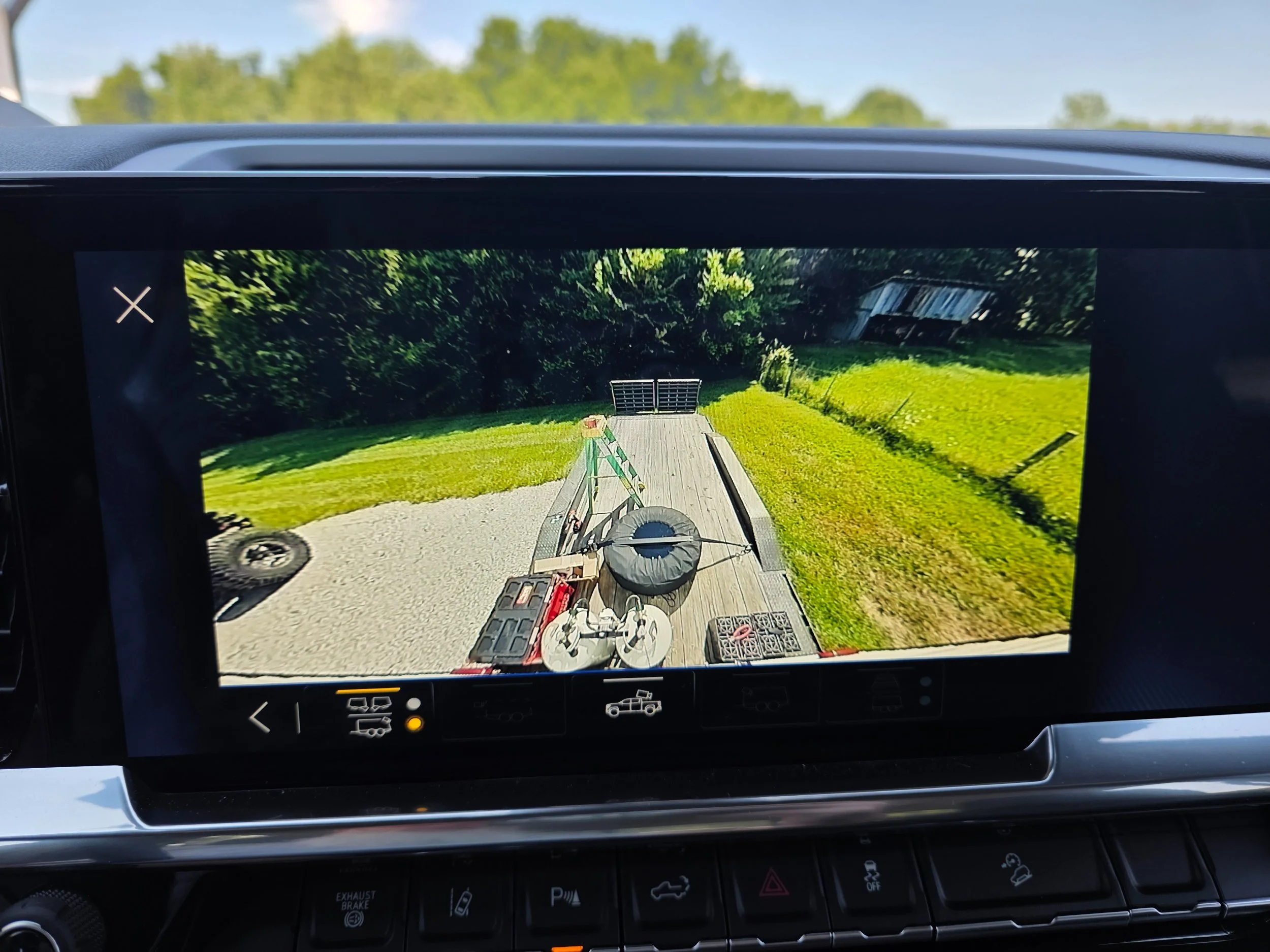

Mine do yes. I have full steel wheels and 14 ply tires. My only issue is how far my sensors are from the receiver. Sometimes they cut in and out.

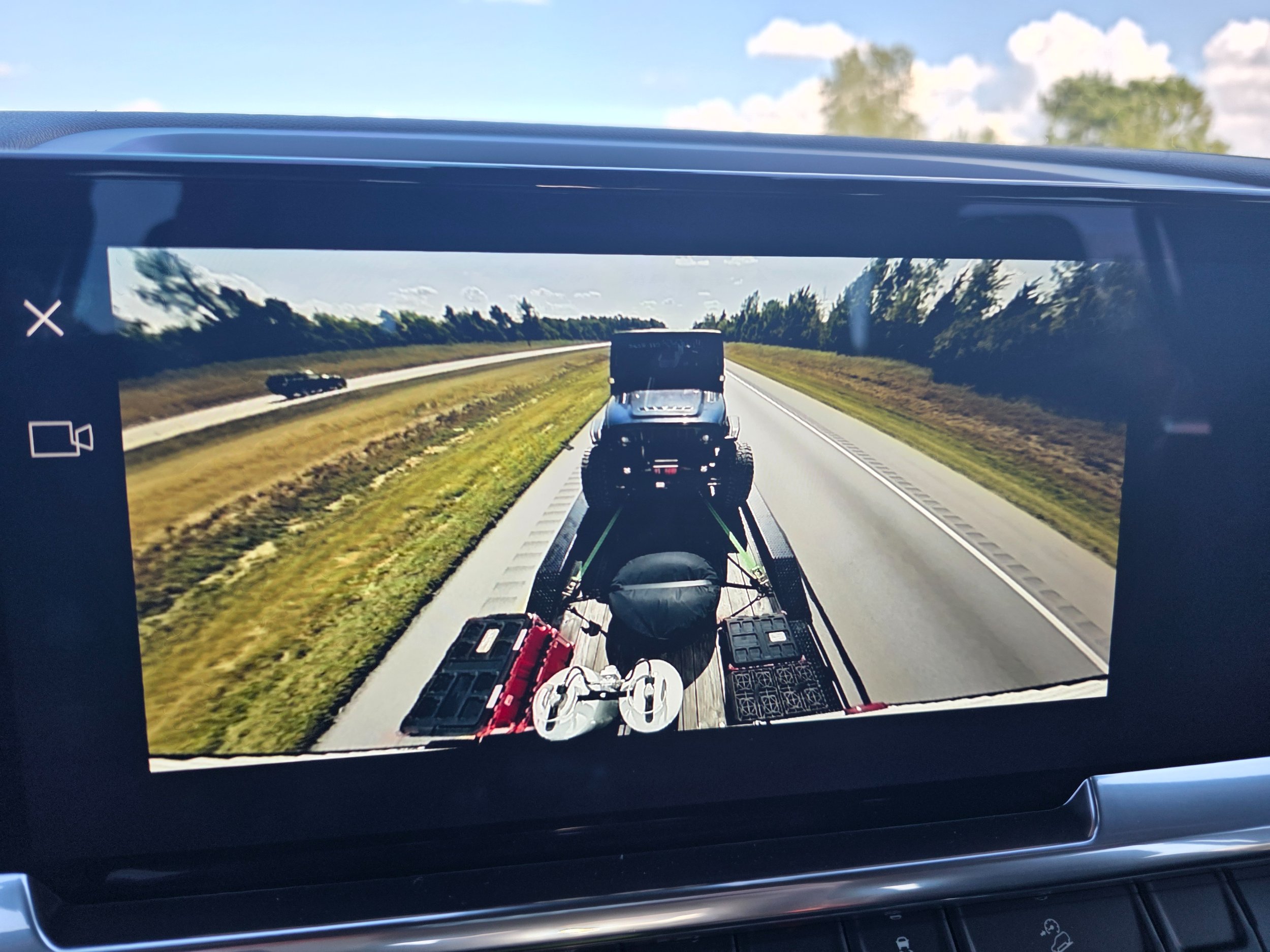

I didn't want another screen when the truck had the capability. I also added the rear trailer camera to the back of the RV to check on the TJ and back up.
