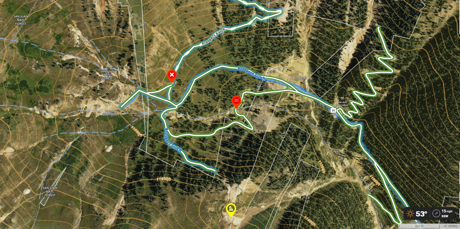

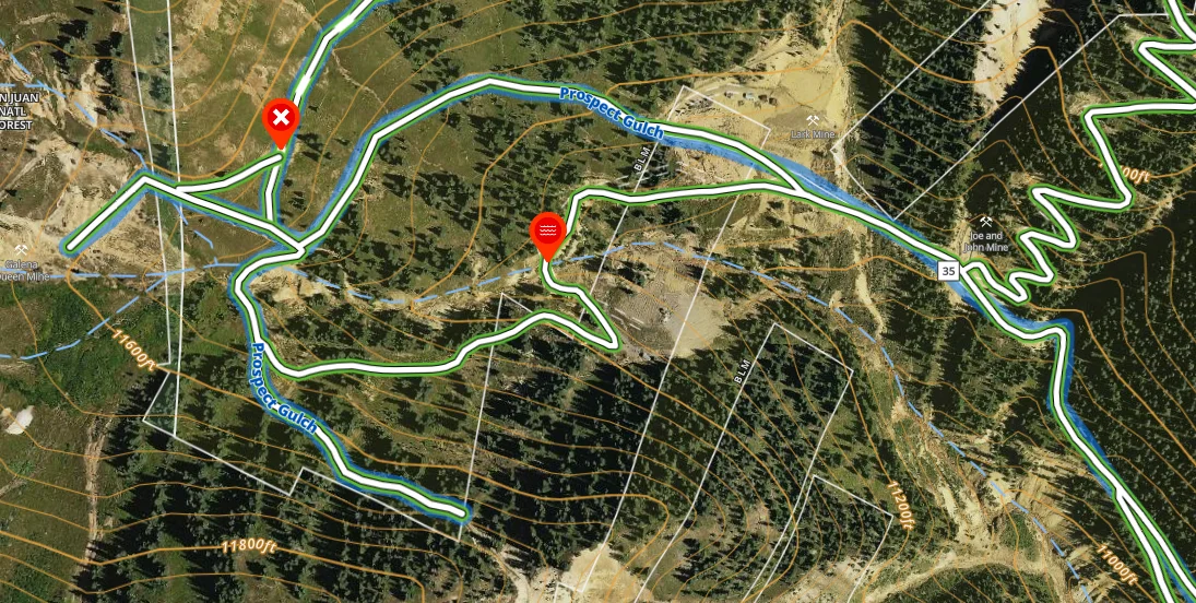

Point for OnX (maybe?): I have spotted a couple of instances where TrailsOffroad specifically marked previously used campsites with improvised stone fire rings as possible campsites, but appear to be on private land when I go to mark them on OnX. COTREX has no indication either way but the MVUM seems to agree with OnX.

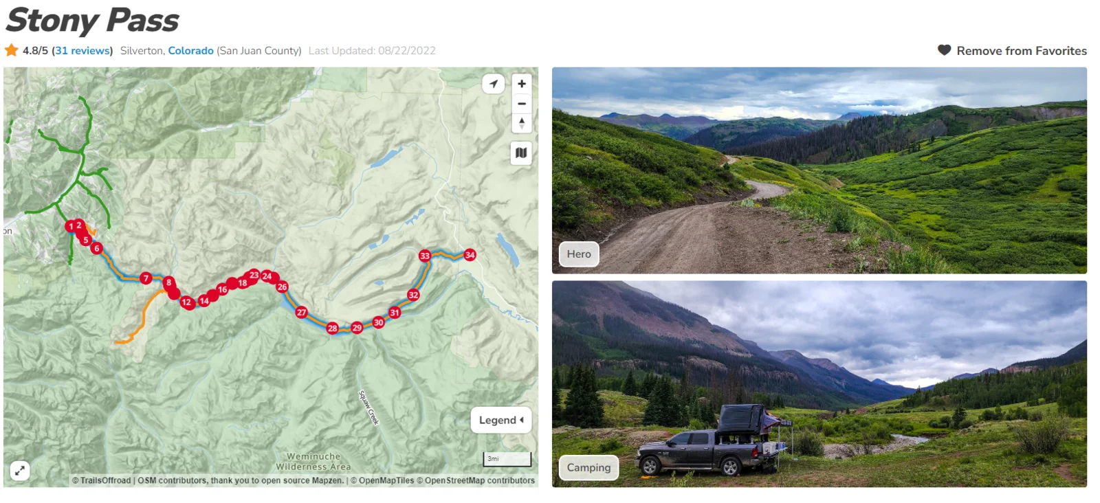

Point for TrailsOffroad: I also found an instance where OnX and COTREX both show a road continuing but TrailsOffroad describes a major washout with a photo that shows it clearly impassable by most vehicles. (red waypoints on OnX are mine, the washout is waypoint 3 on the TO screenshot)

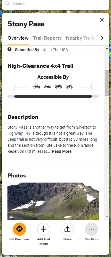

OnX
Pros
I like the interface, the hybrid aerial/topo view. I like the process of creating and saving routes and wavepoints. I like that it's obvious whether land is public or not by showing the top level management agency such as BLM, the name of the national forest, etc. It does mark more points of interest than COTREX, so the names of mountains, mines, etc in the area are right there on the map.
Cons
I don't like that it seems curated by the public, so there's not consistency in what data is available from one road to the next, and having been burned by resources that do things this way in the past (such as AllTrails, what garbage) it makes it hard to take things at face value and I want to verify everything with other sources, which brings my attention to the fact that the roads are labeled only by their colloquial names, so I can't get a USFS or county road for it. I don't like that it doesn't give me the management agency down to the local (Ranger District) level. Has no data on whether dispersed camping is allowed on a given trail. Has some descriptions and photos which COTREX lacks, but nothing close to TrailsOffroad.

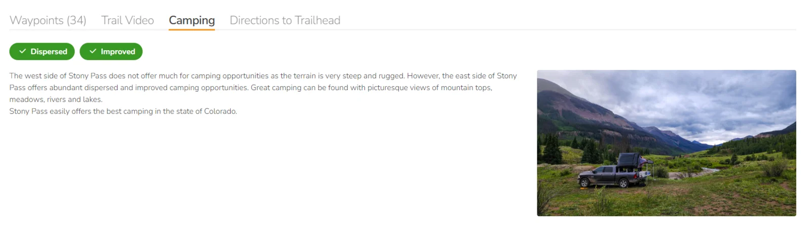

Trailsoffroad
Pros
staff-curated, so there's consistency in the descriptions, data, and technical ratings with and without taking bypasses. Plenty of photos so you know what you're getting from both scenery and technicality. It tells you the management district, the official name/number of the road, current status, estimated time to complete, and even suggests a best direction for through-trails. Every trail description tells you whether there's camping available and where. It's probably the single best resource in existence for planning a trip from far away when details matter.
Cons
No apparent means of creating custom routes, waypoints, etc.
