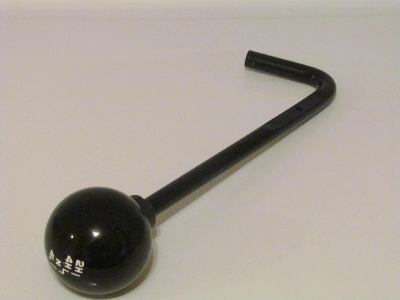

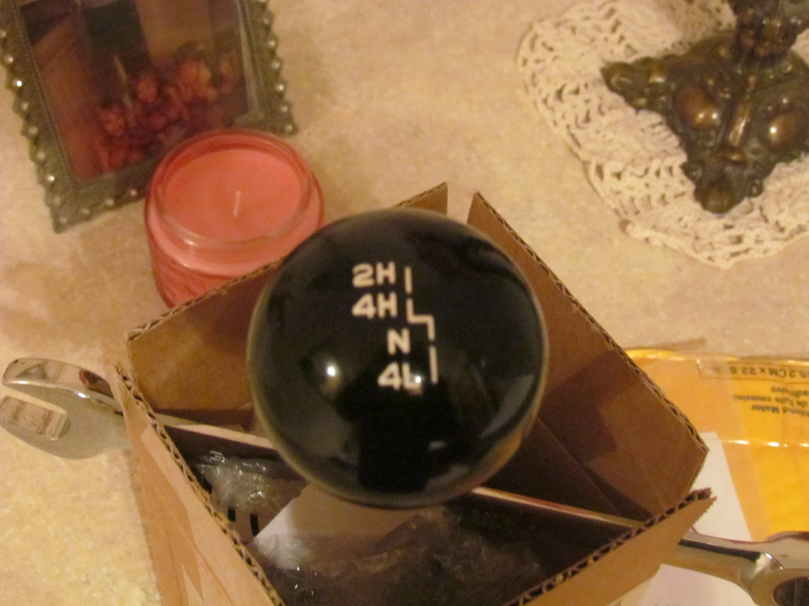

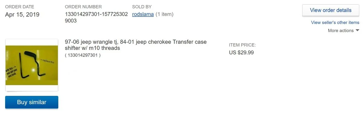

The ebay seller I got the rod from took the one I had back, and is going to send out a replacement. After getting that arranged, I actually contacted autostars_inc on ebay, and told him that I was interested in the shift knob you had, but with a different thread pitch, to match the rod I hope will work right. Even though the shift knob I got was ok, it was a bit small, and I like the size of yours better. He told me to contact SickSpeed directly, and see what they said. Tony @ SickSpeed was very helpful. He found the exact knob like yours, and said they can send it with a 10x1.50 threaded insert. I didn't even have to order that separately, it comes with it. Once everything arrives, I will compare the two knobs, and go with the one that works better. I'm still committed to trying to make this mod work. I really liked how it felt. Hopefully the next shift rod will work right.
Extra bonus - SickSpeed's pricing was better than the ebay pricing...

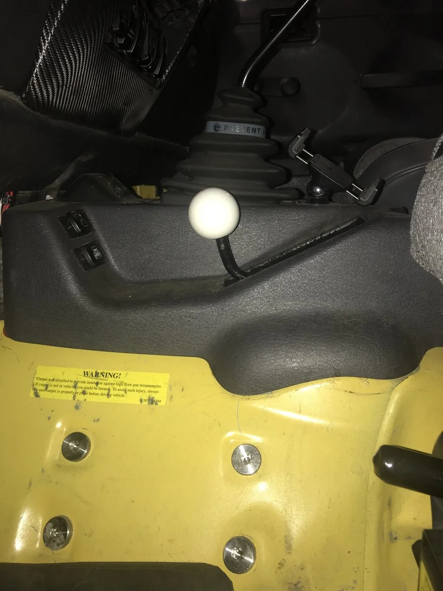

New knob and shift rod received as of yesterday. Installation scheduled for today after shutting down the evaporative cooler on the roof of the house...supposed to get colder next week. Stay tuned.

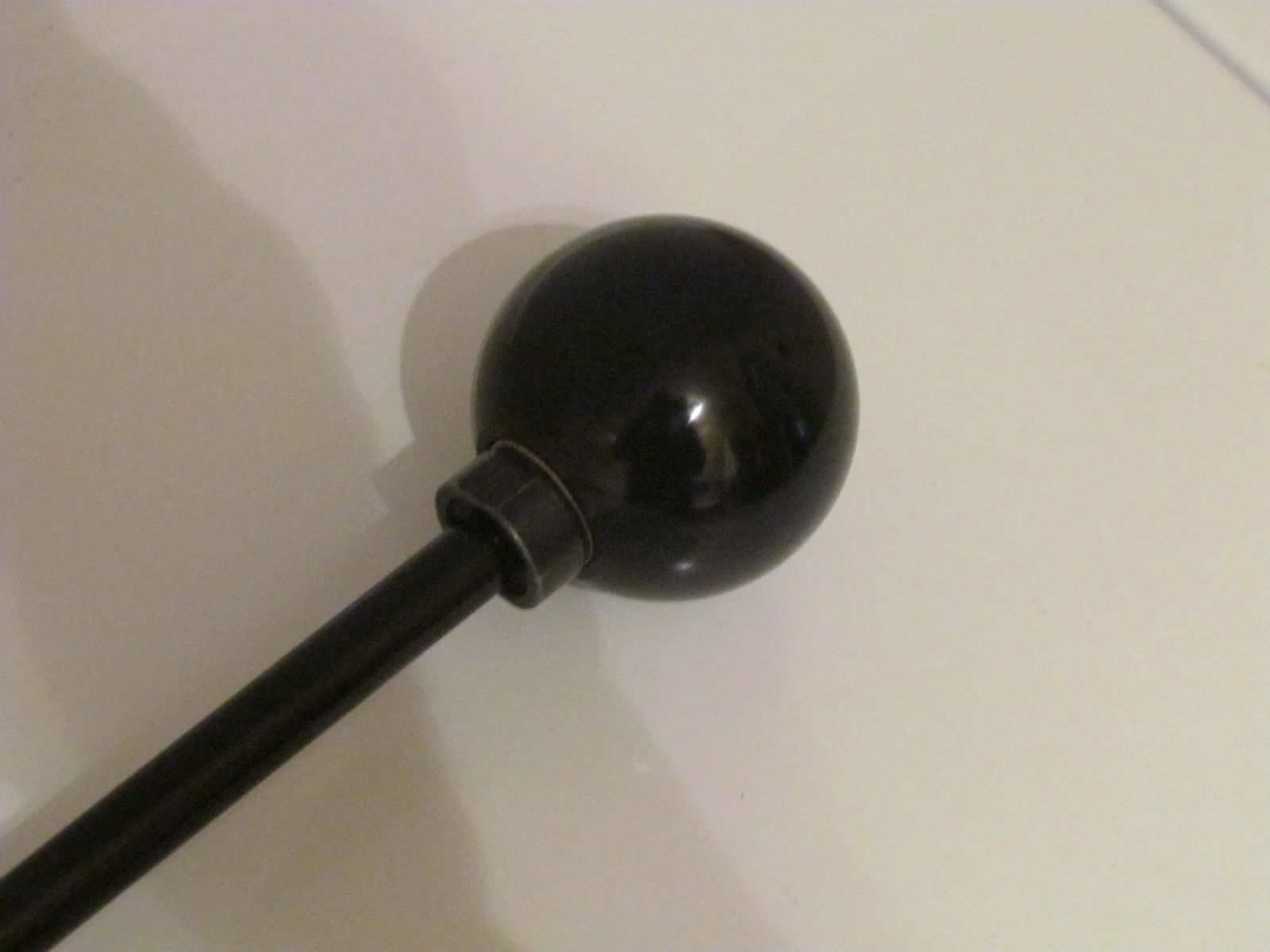

BTW, the new shift rod looks way better than the last, compared to the oem rod. I like the new, bigger knob also. Thanks for the vendor info @Maso!
Reactions: psrivats

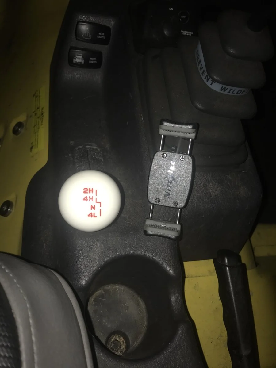

Shift knob project described in post # 92 of my TJ thread on page 5, I didn't want to keep cluttering up @Maso's thread...I like how it turned out. I had to modify the second shift rod somewhat, but it works perfectly. :)

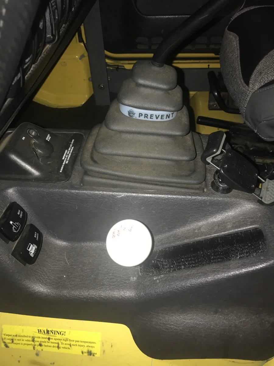

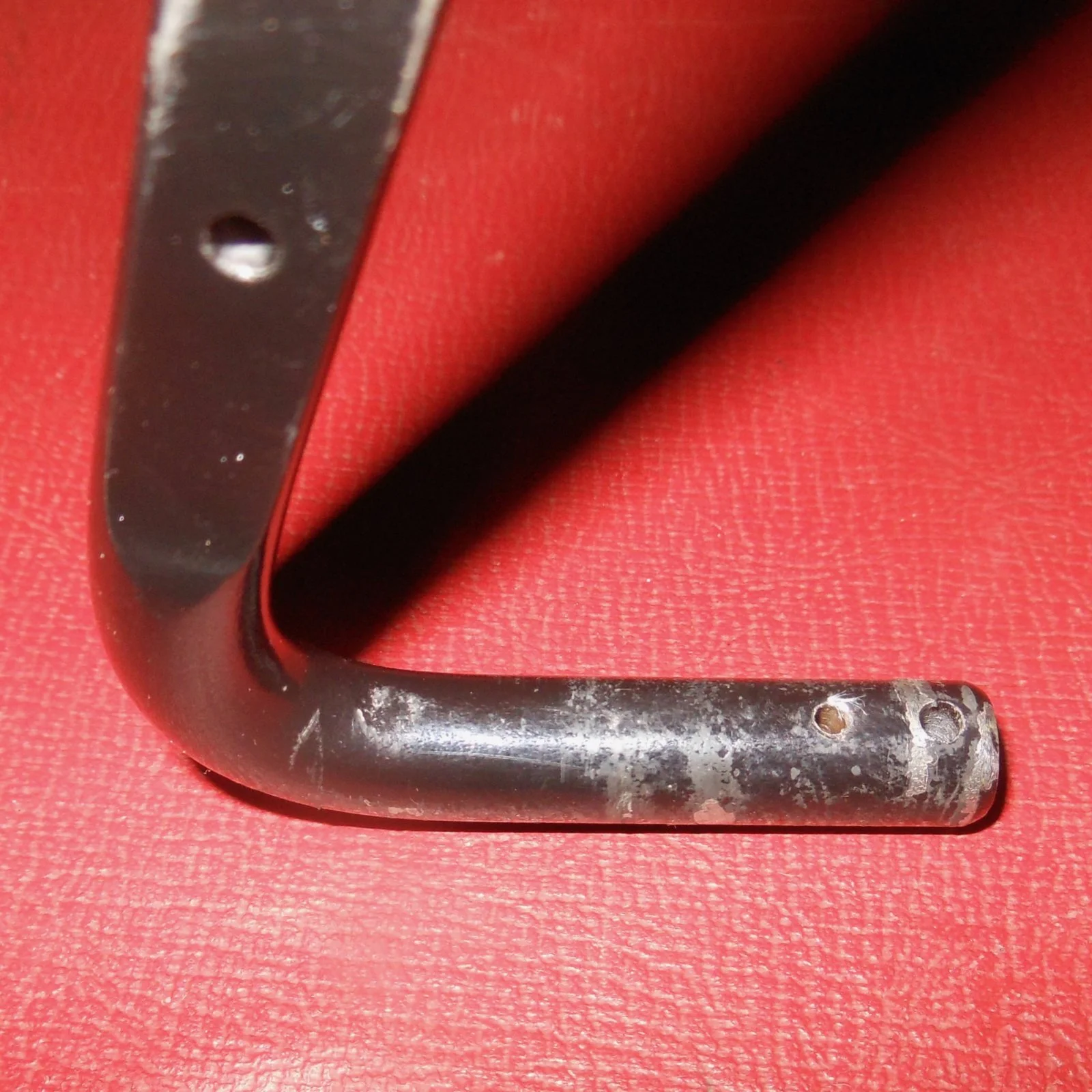

I just did this too. But I bought a lever off ebay, will likely modify the stock shifter as you did too since the after market one leaves a bit to be desired.
Had to modify the lever a bit since it would not go into 2WD. The lever was too long thru the shifting rod. I drilled a new hole for the clip and shortened the rod, cutting it off just ahead of the original pin hole. Works perfectly now, just have to find a knob.

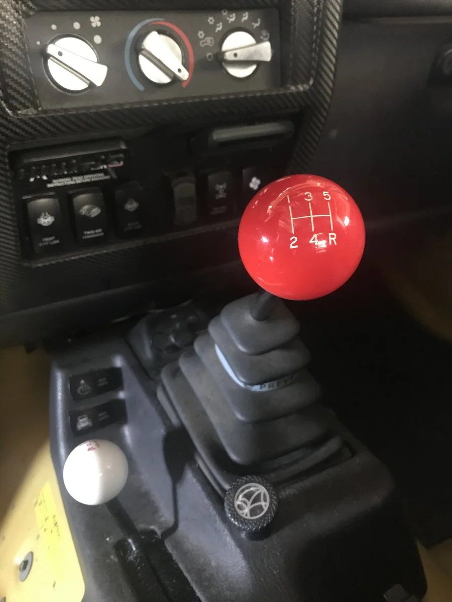

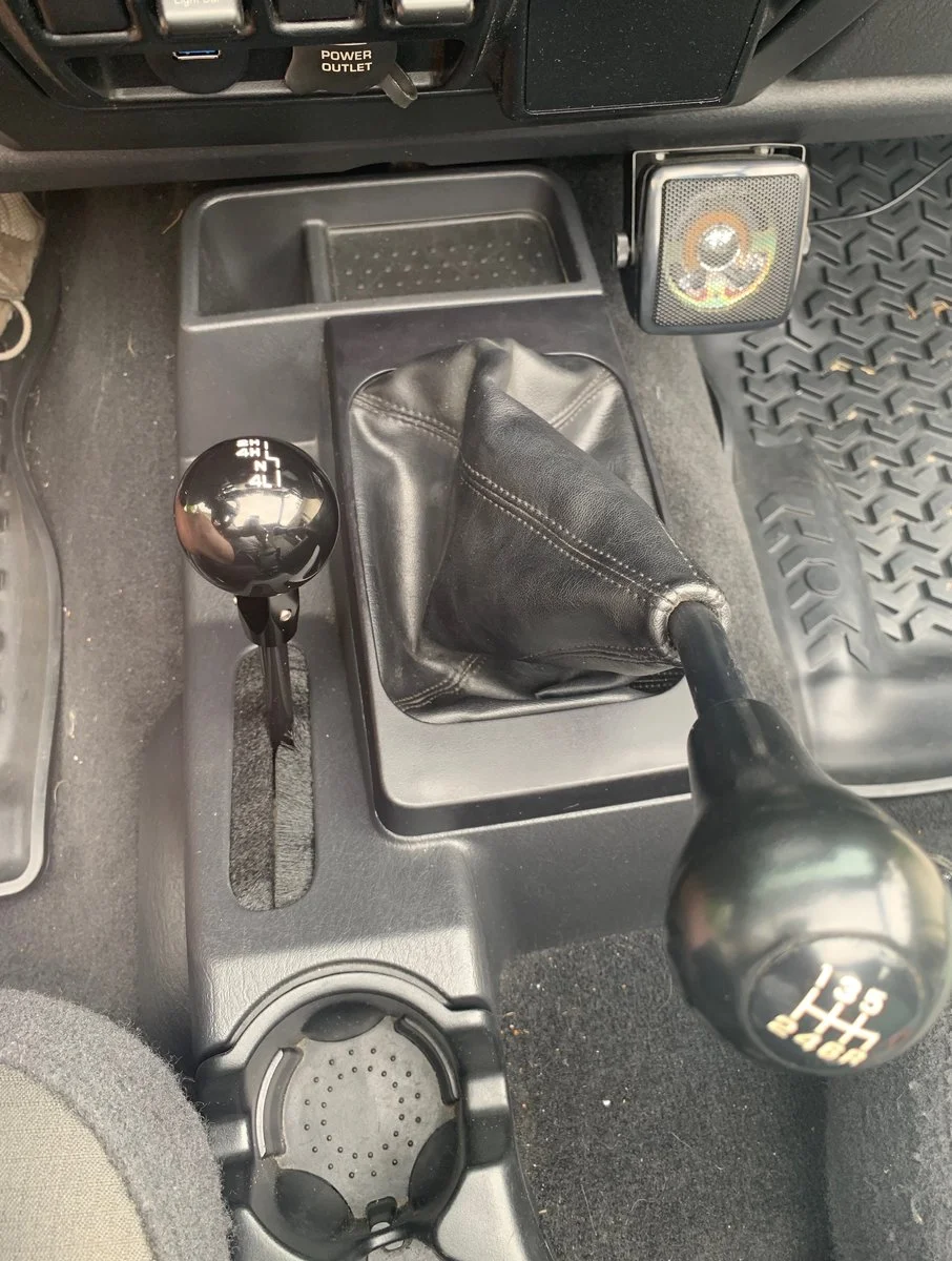

I've been wanting to do this to put JK knobs on both of my shifters.

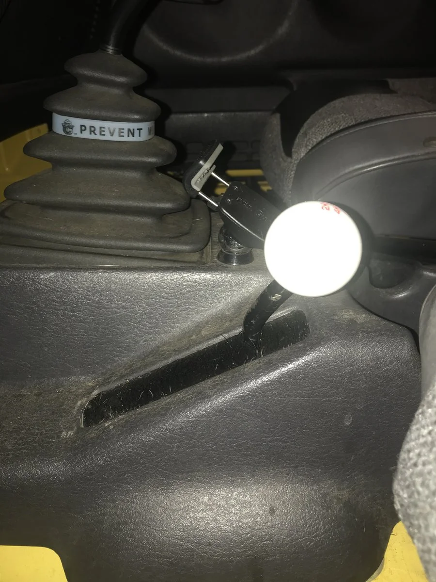

It works, but touches the plastic in 4 low. I'm going to have to take it off and dog leg it forward a bit. Some people reportedly can't get into 4 low without dog legging it. I don't know why it isn't dog legged in the first place...
